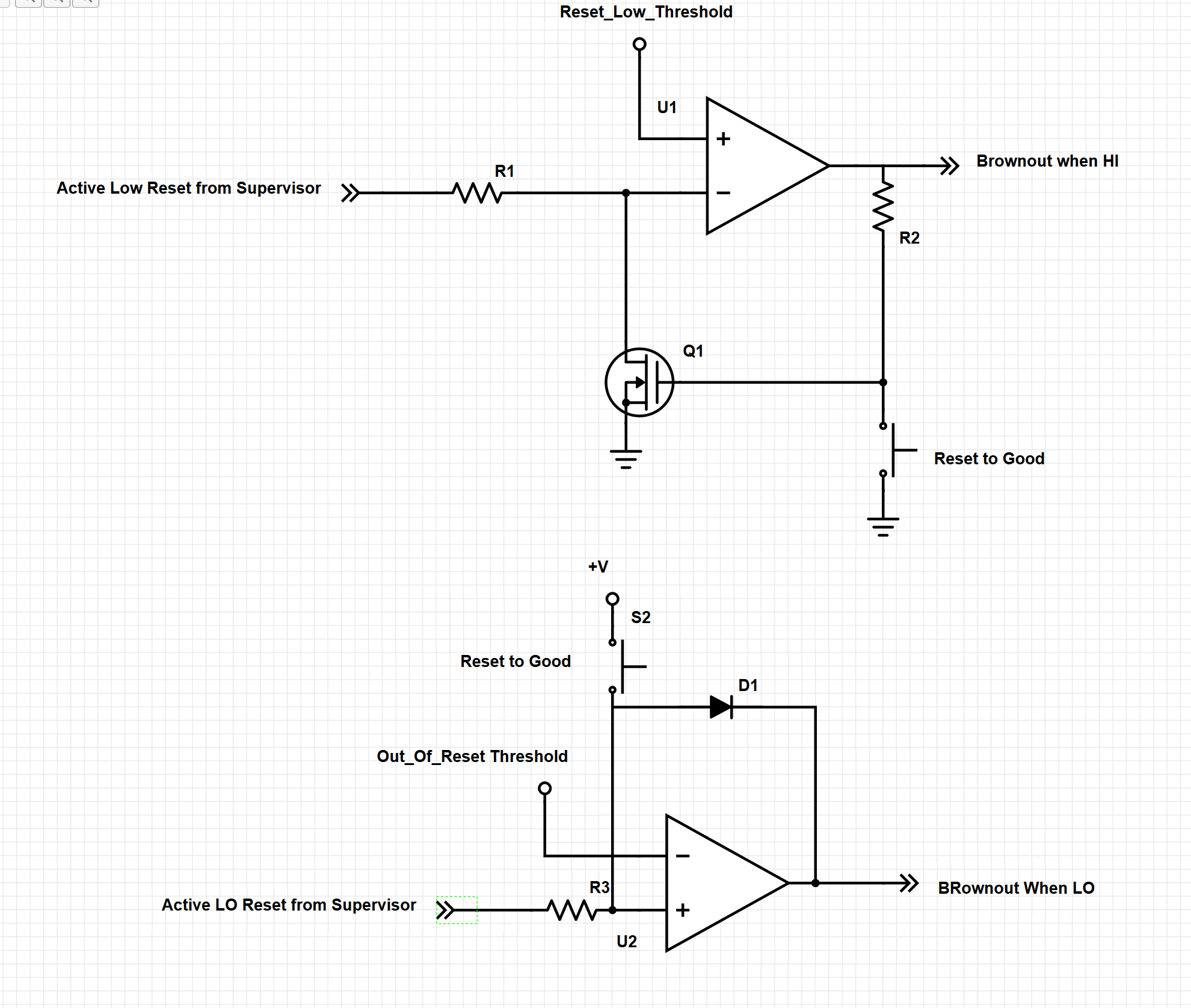

One of these comparator latches should work in conjunction with a supervisor IC. A rail-to-rail output op-amp would work too in a pinch.
The MOSFET version is more difficult to mess up. The diode version requires that the Out-of-rest threshold be set high enough that the diode is forward biased before the out-of-reset threshold is reached when the input is going from LO to HI. Otherwise, the circuit is unable to establish the diode's role in allowing the output to pull (and maintain) the non-inverting input LO before the input rises high enough to cause the output to trigger a state change.

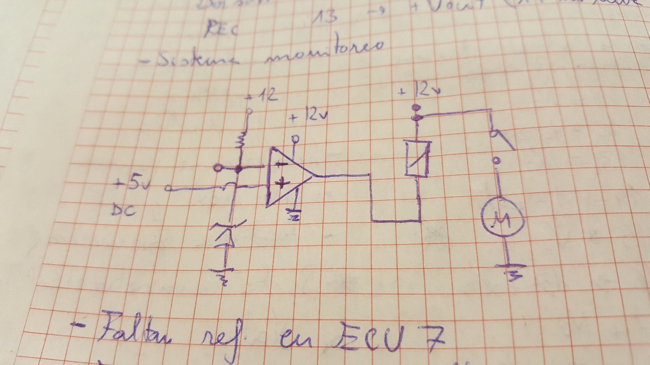

the thing is not so accurate, as soon the 5V monitored goes 0,5V down the monitor circuit should detect it. The power of the circuit can be different from the power monitored. As an example I did this quick design but it´s not working, I get only 6V at relay... Zener is 4,6V so if the 5V coming from DC/DC connected to non inverting input goes below 4,6V then output of LM2903 should go to ground, isn´t it?
Depends on the resistance of the relay coil, or whatever is connected to the comparator output.
Datasheet + load resistance + Ohm's Law = ???

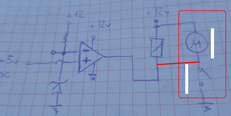

I don't know what "M" is. I revered M and relay contacts.
When the relay is turned on it will stay on as long as 12V is alive. (add red line from coil to contacts)
You might need to put a large cap across the Zener diode so the voltage on (-) comes up slow. (there might be a power up problem)
edited--- put a diode across the relay coil. pointing up ---edited
M is a motor of a fan with a mark on it. If comparator sends ground on the output switches relay on and this switches on the fan, position of fan changes (mark is not in the same position) so I know voltage failed.
OK, that´s a good idea about sending signal of switch of relay to ground to keep relay on, so the motor can be replaced by a light and it stays on. Now my doubt is about why comparator is not sending a pure ground so it´s not activated. Relay is 70 ohm.
The circuit in post #9 should work as a detector, but will not latch without one more component. First, disconnect the load and replace it with an LED and resistor to verify that the detector trips at the correct input voltage. A 3.3K resistor will set the LED current to approx. 3 mA.
Relay is 70 ohm.
A 70 ohm load at 12 V is 171 mA, WAY more than a typical comparator can handle by about 10x. Even momentary operation at this current can damage, or at least weaken the comparator output stage. Test the circuit with a low-current LED as above.

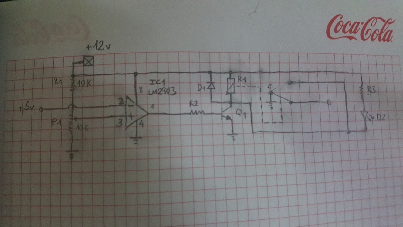

With the LED works fine as you said. May be I can use some driver as ULN2003 to do the same driving a relay.
A single bipolar such as a 2N4401 or MOSFET like a 2N7000 will handle it.
Diode across relay coil.
Resistor in series with base. None needed for the gate.
Note: a driver transistor will invert the logic polarity. Swap the comparator inputs to correct.
Once that is working, adding one diode and one resistor will make it latch.

on Monday I´ll try to test this (attachment), I think this is the theory about what we have been speaking about.
The schematic is OK as far as it goes, but it could use two things.
First, a noise filter on the 5 V input so the relay doesn't try to respond to millisecond noise transients.
Second, some hysteresis. This is a little positive feedback around the comparator to immunize against noise in a different way. A comparator is a linear amplifier running "wide open", so its output is intentionally saturated against either the high or low voltage rail. but if the two inputs are almost exactly equal, like 1 microvolt apart -- which they will be as the 5 V input transitions across the reference voltage -- the comparator will amplify this by 1 million (or whatever its open loop gain is) and the output will be a volt or two instead of saturated. Whatever noise is on the input will be amplified, and the output will be a noise burst that can drive downstream circuits crazy. The solution is a large value resistor from the output to the + input. Start with 100K in your case. Now when the first noise tip causes the output to start to transition, the positive feedback shifts the reference voltage. If the input moves downward 1 uV to cause the output to change, it now must move up around 50 mV to cause the output to change back. The circuit now has 50 mV or "noise immunity". I'm winging rough estimate numbers here, but that's the idea.
In post #1 you said you wanted the circuit to latch once there was a brief 5V dip. To do that, replace the 100K hysteresis resistor with a diode. Now the reference will shift from approx 4.5 V to around 9 V, something the input never can overcome. The output will stay high until the circuit is reset. You can add a reset button as a dead short across the 10K pot.
To make sure the circuit powers up in the non-reset mode, add a 10 uF capacitor across the pot so the reference voltage comes up to its threshold value later than the input.
