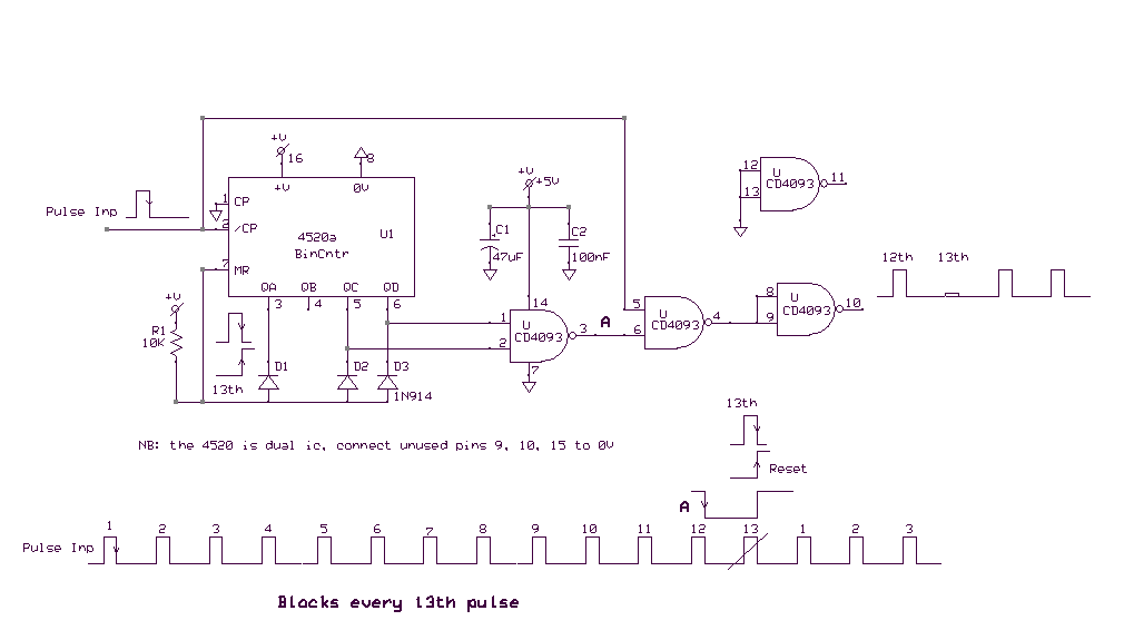

I have a problem that I hope someone may have a solution for. I am making a rev counter for my lathe and the easiest way to detect the spindle speed is to use a sensor to pick up the pulses generated by a drive gear in the headstock of the machine.Some lathes have a 60 tooth gear in this position which provides 60 pulses per revolution, so a frequency meter measuring these pulses gives a direct reading in revolutions per minute of the lathe spindle.
My problem is that my lathe has a 65 tooth gear wheel in this position and I need to produce 60 pulses per revolution. If I can eliminate every 13th pulse from the pulse train I get from the sensor ,this would solve my problem. My electronics knowledge is a bit limited and I need some help with this part of the project and would appreciate any help people can give.

Look at this option.
All it does is block every 13th pulse from passing thru to the output.

Thank you for providing me with that circuit, it looks to be the answer to my problem. I will try it out once I get hold of the chips needed. Thanks again.

The ic's on the circuit are CMOS, so take care to avoid antistatic damage.

Don't think there's anything simpler than using the two rate multiplier chips. You could use a counter to count to 12 and inhibit the next pulse but that would require just as many parts.
Pulses come from a 65 tooth gear which cannot be modified, but I now have plenty of ideas to work with and should soon have a working system. Thanks for all the contributions, much appreciated.
