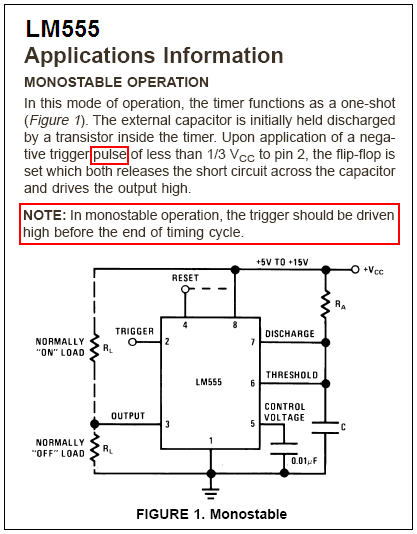

The circuit you found is completely wrong, you should have used the circuit in the datasheet instead.

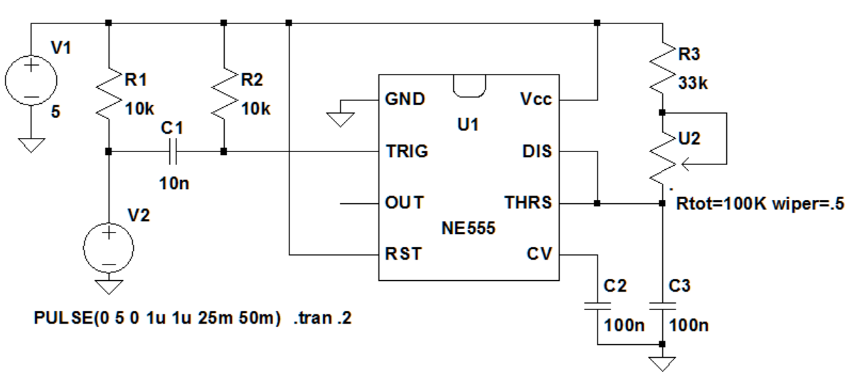

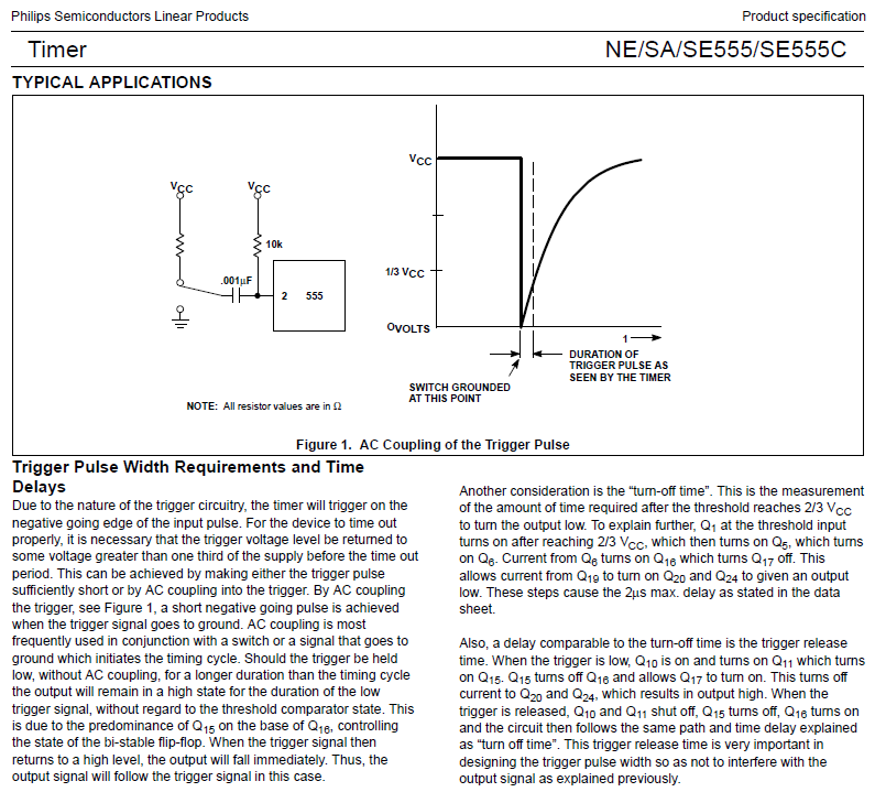

Pin 4 is RESET and should always be at the supply voltage, make it at ground to reset the 555. Pin 2 is triggered when its voltage is a low pulse to ground, not a positive pulse as shown wrongly in the sketch you found. Pin 2 must be high after triggering but before the monostable times out so maybe the trigger input should be capacitor-coupled like this:

Hi Audioguru,
you are right, there is full of schematics in Internet and I choosed the wrong one!!!! I didn´t realize, I was thinking in putting a pull up resistor and a transistor in pin 2 to avoid that strange behavieur but if I connect pin 4 to ground it probably will work properly. Thanks.

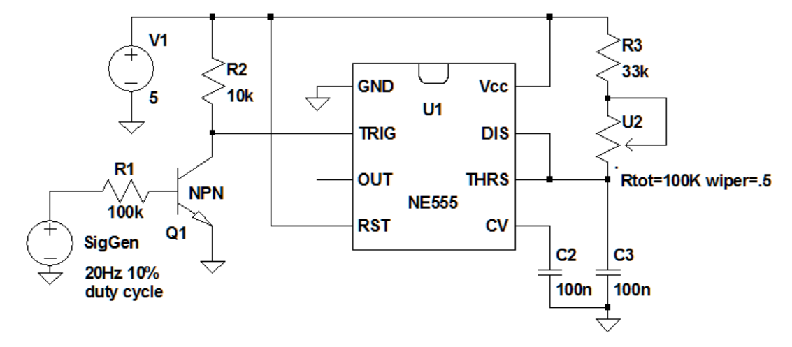

Here's how you could do it :-
You need to use just the falling edge of the 50% duty cycle input pulse to trigger the monostable, otherwise the monostable output will be 50% duty cycle too. In other words the trigger pulse duty cycle must be less than the required output pulse duty cycle.

Ok. Here's a mod using a transistor as trigger. Set your sig gen to 20Hz with a ~10% duty cycle (5mS high, 45mS low).

If you keep the input high for longer than the designed monostable pulse width (~9mS) then the monostable output pulse stays high for longer than 9mS. Ok if that's what you want, but the design is intended to produce a ~9mS pulse when triggered by shorter duration trigger pulses.
I need a minimum of 18% positive duty cycle output
That's not what you originally specified :banghead:. In that case make U2 a 500k pot to give a wider control range.
