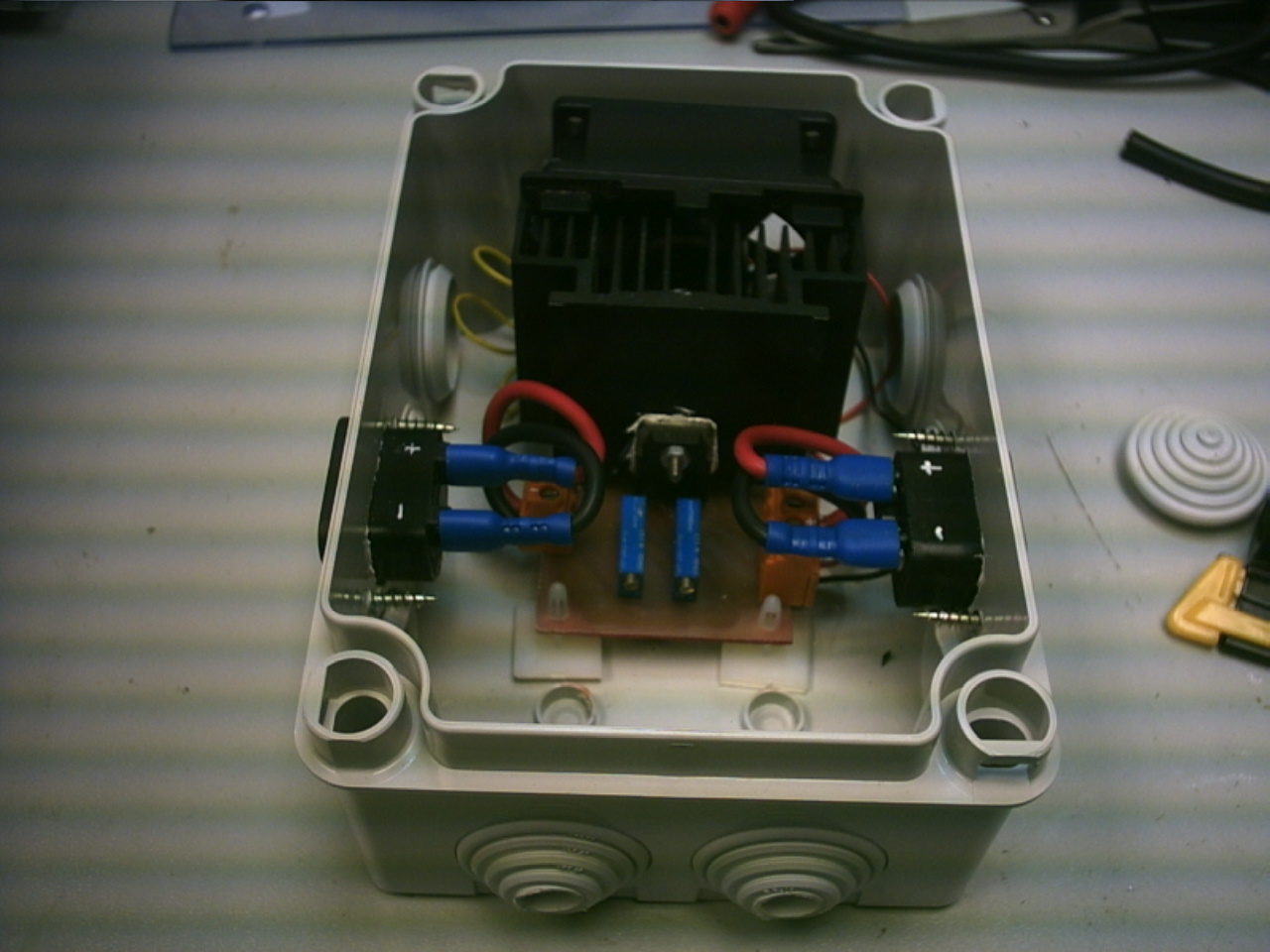

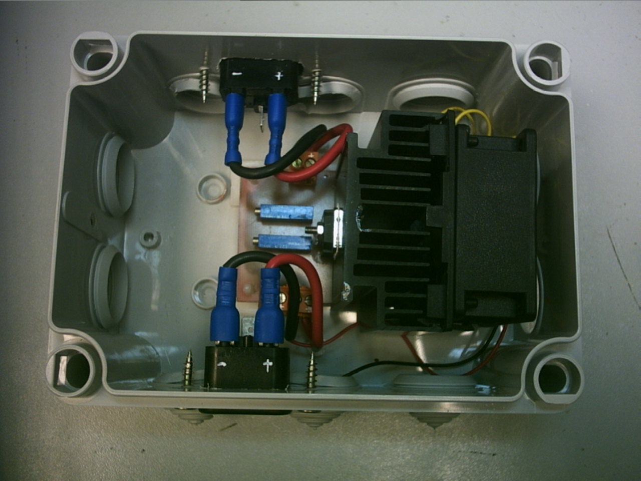

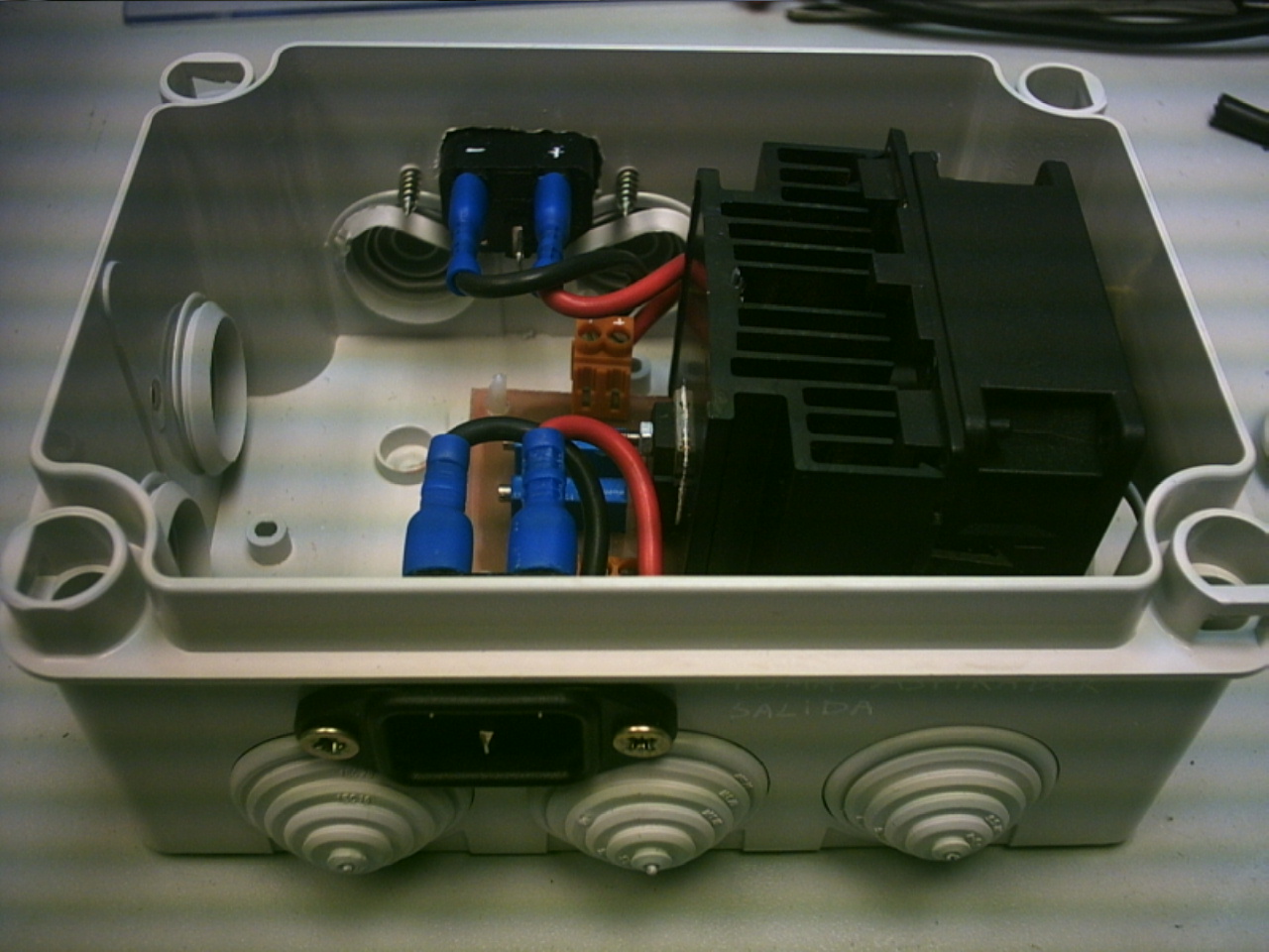

Hello,
I put this information for everybody who was interested about this project, every idea was useful to know different possible ways to carry on it, so thanks.
I checked the possibility of the bulbs connected in parallel using some car bulbs but as I didn´t have the material to do it and I had to buy it to put them inside the box properly finally I took another way.
I removed the IRFP350A, two potentiometers of 10K and PCB sockets from different damaged boards, the fan and heatsink I took from a computer damaged motherboard. I had some small free boards so I designed and made the PCB.
I put everything inside a PVC usual electrical box which I also found in my workshop.
I modified the connections inside the vacuum cleaner to switch on and off now my installed input plug signal (L, N, G plug) removing also the 3 batteries from inside the vacuum cleaner.
I made the cables modifying some of them I also had in my workshop and with those plugs is no possible to reverse the polarity (only one position).
So finally there are two cables, one can connect the box to the vacuum cleaner and the other the box to the 12Vdc car plug.
The fan was connected directly on my PCB using the direct car Vdc and the MOSFET can be regulated with the two potentiometers. I did some measurements and finally regulated the potis to have the values as follows:
Vdc car´s output when is running and nothing connected at plug: 14,4 V
Vdc car´s output when is running and vacuum cleaner is on: 11,8 V
Temperature at chip case: 40 / 60ºC
Temperature at heatsink: 60 / 90ºC
Vdc interface box output for vacuum (Johnson motor): 5,2 V
Idc vacuum cleaner consumption: around 9A
I should say I know that´s too much work and money if you don´t have none of them but as I said I didn´t spend any money and I had free time to do it, also the experience of solving the different problems to design that was useful for me.
You can see some photos from the interface box open.
Thanks.
What is in the wiring of your car to cause the 2.6V drop, which burns 23.4W? Maybe the alternator doesn't have much output at idle.
The chip case is hotter than its heatsink, isn't it?
Its power dissipation is (11.8-5.2) x 9A= 59.4W. The Mosfet's thermal resistance from its crystal to its case is 0.64 degrees C/W, then its crystal temp is (59.4 x 0.64)+90= 128 degrees C. Pretty darn hot.
That's 46.8W for the little motor. It must be cooling itself.
It looks great, you did a fine job. But the Mosfet might fail soon with such a high internal temp.
Hello Audioguru,
I hope you and your family are fine, here now is getting a little bit colder but until now the weather was very good...
I´m not sure but even with my desk power supply 0-30V / 10A there is a drop of 5,3V and I get at the input only 9V, strange is that you can see at the digital display 12,5V but as you see they are not real.
I guess the car´s output from the alternator is limitted to supply that 11,8 voltage in case of big current as this case... but I´m not really sure about the cause of this drops.
[/quote]
I measured with a laser termometer and I read those values, the chip case is always colder than the heatsink (dissipation plate cooler). The maximum value I read was nearly 90ºC and was on the top of the dissipation plate. I put some conductive thermal paste between the chip and the dissipation plate. This 128 degrees C you mean, are they internally at the chip?
Yes, with the batteries originally the motor received nearly 4Vdc and the consumption was around 7A but somewhere I read these motors are usually to work on a range of 3 to 6Vdc. With this voltage I increased the rpm so I also improved the vacuum behavieur, I think it will support well those 46.8W.
Thanks, I also tried to install a small 12Vdc motor from a CD player with a propeller from another broken CPU fan added but it was not possible because it vibrated too much and was difficult to fix and hold it on a good place. I also wanted to achieve a good temperature for the chip but those values I wrote are the ones I have.
We will see, if the Mosfet fails I´ll tell you...
Thanks.
