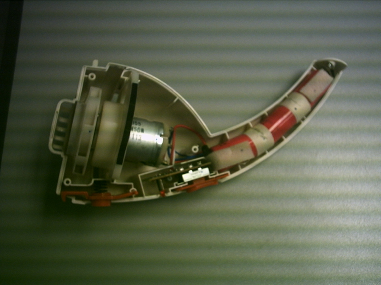

I have a vacuum cleaner which works with batteries and I use it for cleaning inside my car. The problem is that the yield is too short only around 10 minutes with fully charged batteries.
Now I would want to connect a plug for the 12Vdc car´s connector and use this source as power supply. I have checked the power when my car is running at this plug and there are 14,4Vdc.
I aslo checked that the vacuum cleaner uses a motor which consumps 7A at 3,6Vdc (3 batteries in serial) so I have thought about the possibility of installing a power transistor which takes the 10,8Vdc at its Vce or Vds. I think is necessary to use a MOS transistor but I don´t work usually with them so I´m not sure if that is possible to do.
For example I found a IRFZ44R which I think has enough properties to do it but I would like to confirm the way of connecting it. Can you help me?

You can see the vacuum cleaner, I don´t have a lot of place inside, just enough to fix there some MOS transistor and resistors to excitate it... I think that is the best option but I still need to know the way of calculate and connect the MOS transistor to the resistors and Vin to get this 10,8V at its Vds. Any idea???

If you try to regulate it linear you will have to get rid of 75W of energy.
So if you use an transistor or sotming on an 1 C°/W heatink(Such an heatsink is already quite big and heavy)The transistor wod be runing at about 90 to 110 C° and this is very hot.
An swicthmode powersuply is from 80 to 90 % eficent wich means there is very litle heat made and so it can be smaller,lighter and cooler.
The dissipation of analog supply exactly same as bulb disipation. Without really big heatsink cannot work. With heatsink impossible to build into this case. The SMPSU is a solution, but maybe also not enough place in case for it. Don't worry about 3,7V, it will happy with 3,5...4,2V. I know only this type for 10A:

now I have a doubt, I checked that the motor used nearly 7A when was running from its 3,6Vdc battery source but when I simulated the power with my power supply and I put 4,4Vdc it consumps nearly 8A and the propeller turns faster, more rpm!!!!
As Sebi said this motor has a range and I think the interesting thing would be to know the maximum voltage I can supply it. Then I would get maximum rpm, maximum cleaning vacuum (very important to remove the dirty at the car) and less problems to connect it to the car´s power supply. The motor is a Johnson with numbers 62855 and 3F1113. I already tried to find the data sheet for this one using those numbers but I couldn´t find anything.
I connected already a MOSFET (IRFP350A) with 2 resistors without heatsink to do the test but as you said the heat is too much and in some seconds the component gets so hot that the soldered point I had at the drain pin was removed. This MOSFET supports 17A Ids as maximum and it´s not so big but the problem is to cool it as you said, not possible to install anything inside the case. Maybe the cheapest option would be to make a box where I put this MOSFET circuit with a heatsink. The box with car´s plug male output cable and normal plug male output cable to connect at the vacuum cleaner, where I should also install a female normal plug and a switch, or even the switch could be at that external box.
What do you think about this solution?
I don´t know how big should be the heatsink to dissipate the heat properly...
get an MOSFET that can suply more curnet.If its high enugh it will be just warm whithout an heatsink.
the IRF3205 can suply 110A at 55V and its in an TO-220(This is like most power transistors and voltage regulator) Over here you can get it for $2.

The IRFZ44R can dissipate 100W as a maximum IF the back is kept very, very cool. If you dipped it in cool oil for example the back might be kept at 25C but the internal junction will still melt. If the backing is hotter, the maximum power rating goes down.
Keeping a TO220 this cool under 100W isn't going to happen, not for 3 euros. A cheapo folded aluminum clip-on heatsink can allow a TO220 to dissipate something in the 5W range or so. The modest sized heat sinks with milled fins that fit within a few cubic inches can allow a TO220 to go into the tens of watts. 100W requires a HUGE heatsink, lots of fins, skillful thermal mounting, and a fan.
You can keep the heat in the temp-sensitive MOSFET low by adding a resistor. For example if you put a 1.2 ohm resistor in series with the 12v supply it would burn up 8.4v, thus 58.8 watts of the heat. 5-20W resistors are relatively cheap and building a network of them will bring the MOSFET heat down to a realistic level.
Still, off the shelf, I'd say this project can easily run 30-40euro or more, and the results will be less than "satisfactory" due to the size and heat generated. It will also run down your battery pretty fast! That's why I suggest getting a 12v vacuum which is quite common.
I take it you want a learning experience here. First thing to learn is nobody will ever design a linear regulator like this, it's impractical. When we have to step down voltages like this we use a DC/DC converter- a switching reg- which will do the job cleanly. Cool, efficient, and cheaper than huge FETs and heatsinks. It would be difficult for us to communicate how to do this to you because it doesn't sound like you're ready for advanced circuits like this.
