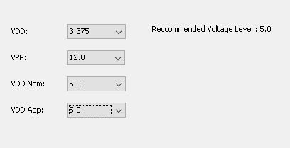

Hi N,
When changing the Voltage to 3.3V I was faced with this, see image:
I have other circuits with series resistors, but wasn't getting the correct results, so bought the lower voltage PICs to eliminate this possible reason.

Hi N,
Presumably you have set MPLAB to use the LF version of the chip?, and not just the F version.

Hi N,
MPLAB set for LF.
3.3v ok.
EDIT: The Pickit3 is powered by USB and has an external power supply (if button pressed), which powers the target with 5V.
C.
Today I changed the MPLAB power settings to 3.375V, and powered the programming with the Pickit3. Then switched on the circuit (3.3V to PIC) no result. When powered by the Pickit3 xternal 5V circuit the PIC showed results. So the PIC can be programmed at 3.3V but it won't run until 5V is fed to it.
