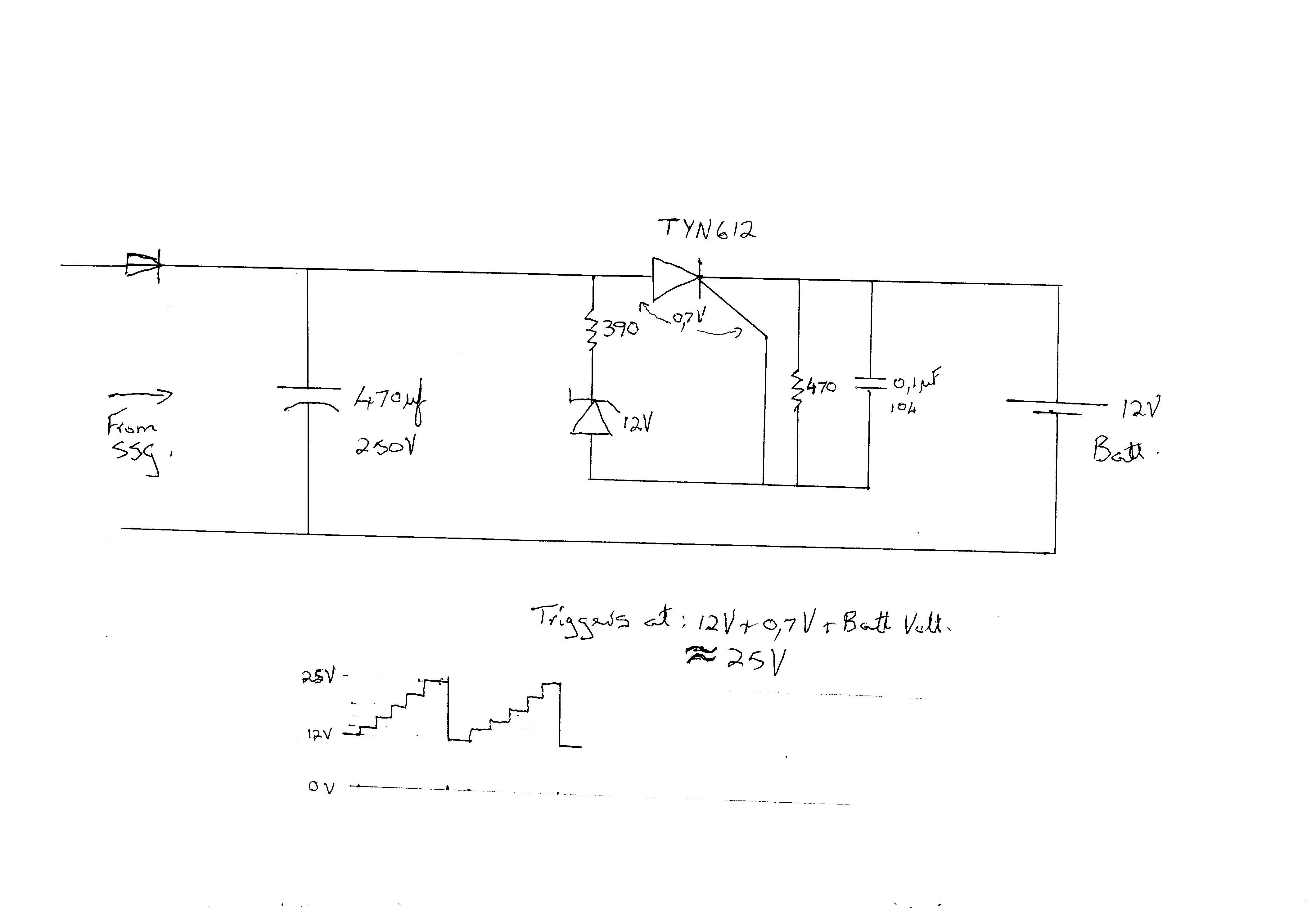

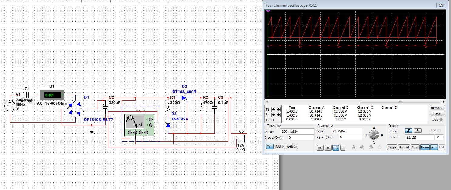

i know this is ancient, but here is a design that i've been using for years

One thing all of these circuits is missing is a resistor between the gate and MT1 (or cathode in the case of an SCR). The purpose of the resistor is to keep the device from turning on because of leakage current or fast voltage transients. Just thought this might be helpfu.
