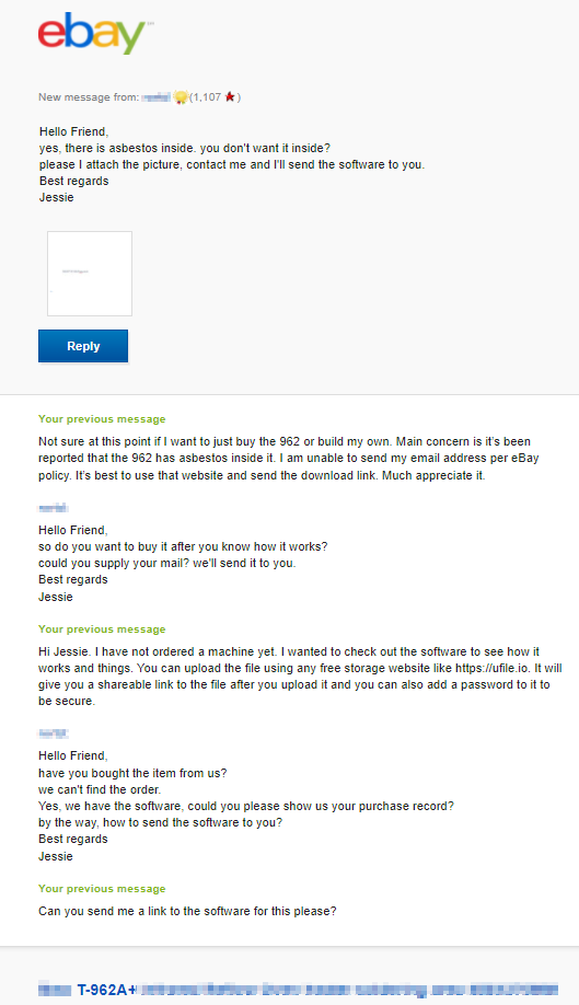

Is there any truth to the claims of the T-962 having asbestos inside their machines?
I would imagine that historically all such devices included asbestos, but none 'should have' for a good many years now. However, if they are made in China they often seem to sneak banned substances in to occasional production runs (with someone pocketing the savings made).
You should also consider that only some types of asbestos are hazardous.
