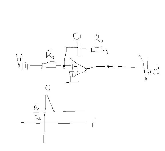

any ideas on how i would effectivley "boost" the bass output to the speaker?
The only way i know how to bass boost a signal is by using an active filter. With op-amps, put a capacitor C1 and resistor R1 in series in the feedback loop of an inverting configuration, and a resistor R2 on the inverting input(-). Put the non inverting(+) input to ground. The gain of the Amp is -(Loop impedance/Impedance from Vin to Inverting input). At Low freq (BASS) the reactance of C1 is large, so Gain = -Large/Constant R2 = Large = Boost. At high Freq Reactance of C1 is low, Feedback Loop resistance becomes ~ R2 as C1's reactance becomes negligible. So Gain = -R1/R2 = fixed. If you dont want any treble Gain, make this ratio unity. This is all off the top of my head i think its all correct.
will op amps give me as good a quality as the TDA? i tried the schematic above and as soon as R2 hits one of my two outputs (to the speaker) the sound cuts out all together. Does this mean that the chip will not allow me to do it in this way (i take it it does)?

You need to match the impedances into the circuit. R2 represents your input impedance of your bass boost amp. R2 needs to be big so you're feeding the signal into a high impedance. Something of about 1M. R1 needs to be chosen so that the ratio R1/R2 gives the correct treble Gain. And C1 needs to be chosen for the cut off point of the filter --> 1/(2*pi*R1*C1). Follow the output of this circuit with an op amp wired as a voltage follower and maybe add on a push pull transistor config to supply the current before u attach it to a speaker.

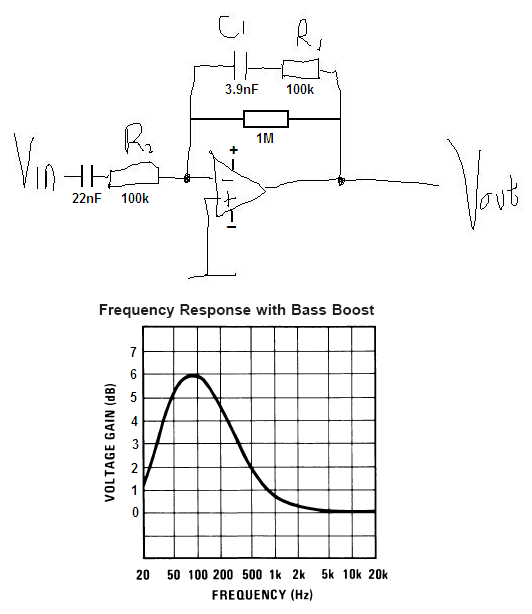

Your little TDA IC is rated for only about 1W into an 8 ohm speaker. A 4 ohm speaker would overload it because it would try to produce 2W into it.
Since the circuit boosts the bass then the volume control must be turned down by the same amount because the amp doesn't have enough extra power output to allow boosting.
Audio opamp circuits must have a negative feedback resistor for DC.
Is this what you want?
