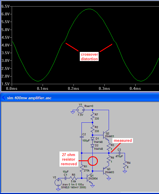

Well... Thanks audioguru for your answer(s). Uhm... I have another questions. Why do we have to add the 5.6K ohms resistor at the input ? Another question is about the Push-Pull transistor biasing. Well why do we have to add 27 Ohms resistor ? Well 2 1n4148 diodes will apply a voltage about 0.6v in each BE transistor junction and will that be enough to limit the cross-over distortion ? And is that the reason why you put 27 Ohms resistor to limit the cross-over distortion ?
The voltage across the two diodes cancels the voltage of the two base-emitter diodes of the output transistors. The 27 ohm resistor increases the voltage enough to also cancel the voltage in the 1 ohm resistors so the idle current is about 10mA to almost eliminate crossover distortion.
Here is the circuit without the 27 ohm resistor:
