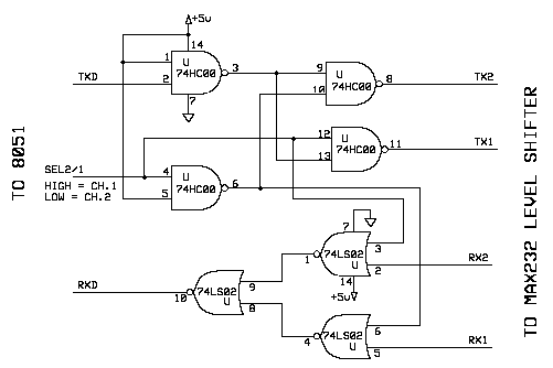

Hi there,
I am a University student in Australia and am currently trying to find a microcontroller to suit this application.
I have two serial devices one a mobile phone that requires 9600 baud that will need to receive and send data to and from the uC. The other device is a GPS receiver that sends characters to the uC at 4800 baud.
I guess my first question is there any ideas on a low cost uC that would do the job?
I was also wondering how in the software I could store the bytes as messages from the phone could be as long as 25+ bytes I have done some uC programming of the serial port however it was only sending of data not receiving. Can anyone point me in the direction of where to start in this area?
Thanks Heaps,
Allan.
8051 Microcontroller with multiplexed serial port can do your job and its very cheap.
Do these both communications happen simultaneously? If yes then multiplexing won't work. If not, let me know I'll post the schematic of port multiplexer.
No they don't need to happen at the same time
If you could post the schematic that would be great
Thanks.
Ok here is the schematic. Remember, both ICs are 74HC type. One has been shown LS by mistake.
The microcontrollers I would like to suggest you are:
AT89S52 (8kB Flash ROM)
AT89S53 (12kB Flash ROM)
Both these are very easy to program and they are In-System Programmable. So debugging your program will be very easy.
