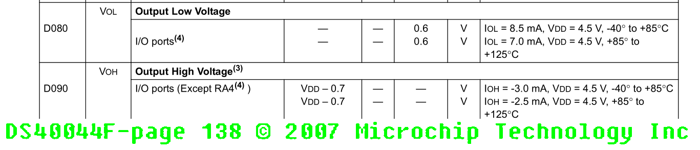

The 16F628 PIC specs are pasted below,
Using the linear RdsON characteristics and Ohm's Law, one can calculate the worst case ESR or RdsON for a "1" , VOH and a "0", VOL
If VOL = 0.6 V at IOL = 8.5 mA, VDD = 4.5 V, -40° to +85°C then ESR=70Ω
- remember this is worst case but the nominal value is closer to 50Ω at 5.0V, 25°C )
This contributes to the voltage drop with the load and thus determines a more accurate expected load current, as well as proves why Microchip 5V logic cannot drive as much current or at a lower characteristic impedance as Atmel at 3V for high speed logic when matched transmission track impedances are used. This is not exclusive to Atmel but rather, extra low voltage CMOS technology in controlling the CMOS drivers with lower RdsON values. The lower voltage logic "family called 74ALVCxxx is <25Ω over temp at 3.0V and rises in ~110Ω as Vcc drops to 1.65V
