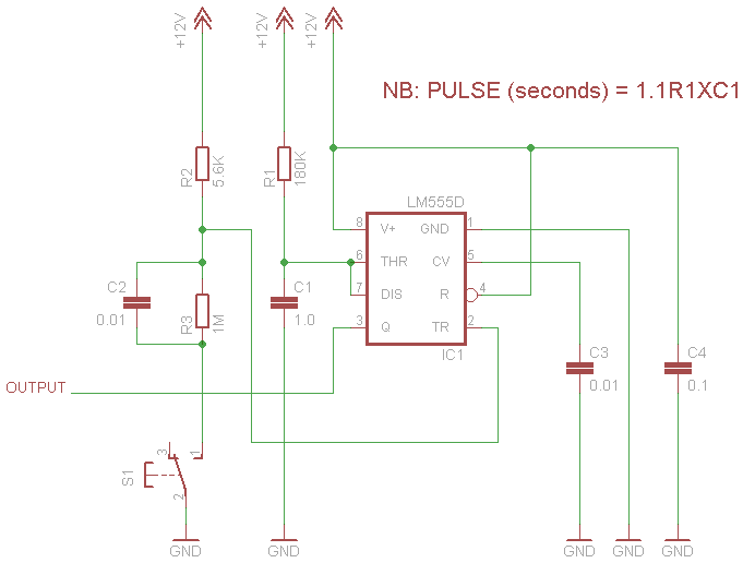

The timing circuit I used for my MOT welder was based on a circuit from MIT. As I mentioned above, the datasheet for a 555 will show how to wire it as a monostable to give a single pulse that will activate your relay for the desired time. The trigger (TR, pin#2) for the 555 must be brought low (i.e., grounded) to initiate the timing. If the trigger is held low, the 555 can continually reset. The **broken link removed** solves that problem and adds debouncing. (Edit: That link to the MIT site appears to be broken, or my ISP is not working right. Sorry about that.) The latter prevents multiple pulses (or an uncertain pulse duration), which can be caused by bouncing of the switch contacts as they close.
mot-switch-timer-png.36257
How it works is explained fully on the MIT link. In brief, when S1 is closed, the circuit from your positive supply is completed across C2, which acts briefly as a short to ground and initiates the trigger. As C2 charges, the voltage at the TR pin increases because of the voltage divider formed by R2 and R3. Thus, re-triggering is prevented if you leave the switch closed. Since we anticipate that the welding time (i.e., the pulse width) will be quite short, I believe that including that aspect in the circuit is important.
The attached schematic has values calculated to give about a 200 mS pulse (i.e., 10 cycles at 50 Hz). You can change the values of R1 and C1 as needed to get any pulse duration you want. I show a 12V power supply. A typical 555 (i.e., LM555C) can operate from 4.5 to 16V. For testing, I would suggest that you simply use a 9V battery. If that works, then you may want a longer lasting supply for routine use.
As for how to connect it, see the 5 Bears reference I gave above. It is really simple. The trigger circuit controls the relay, and the relay controls the input supply to your transformer.

While the O/P and the web site heading; **broken link removed** calls this a "spot welder" If you read the information given on the site you will see that in the text it is really a TIG welder. And that is what they call it in the description.
It uses a tungsten(wolfram in the text) electrode and Argon gas as a shield. Thats TIG welding!
If I was to do this project I would start with Gary Chemlec's "mark-space" generator; **broken link removed** driving a couple of Mosfets, switching the voltage from the transformer. That would give you a frequency and duty cycle (weld time) control real easy.
From there it would be pretty simple to add a flow timer and valve to control the Argon.
Just my dumb ideas on this. Cary

Hi folks,I thought that with my first post someone could give me the info I needed to build jewellery tacker,they did ,special thanks to Jpan.However it seems to evolve somewhat,getting hooked.Just to put my Ha'peth in.Got into silver & gem cutting etc.5 years ago,built and experimented with home made equiptment.I did make a hydrogen/oxyen generator for micro torch,Which produces an incredibly hot flame of minute sizeThe flame from hho generator has very interesting properties but oxidisation is a problem.With all 925 silver a flux is needed to help the solder applied to flow and combine with parts to be joined.It also inhibits fire stain which is caused I believe by oxidisation of impurities in the alloy.999 purity silver does not have this problem.At this time I hope to go with 555 timer & solid state relay to produce ajustably timed pulse
of 3.2v approx 30A.After reading posts I think I may have more success going down the fusion road,using same basic unit to fusion tack as opposed to attempting a full weld.Thanks all for stimulation.
