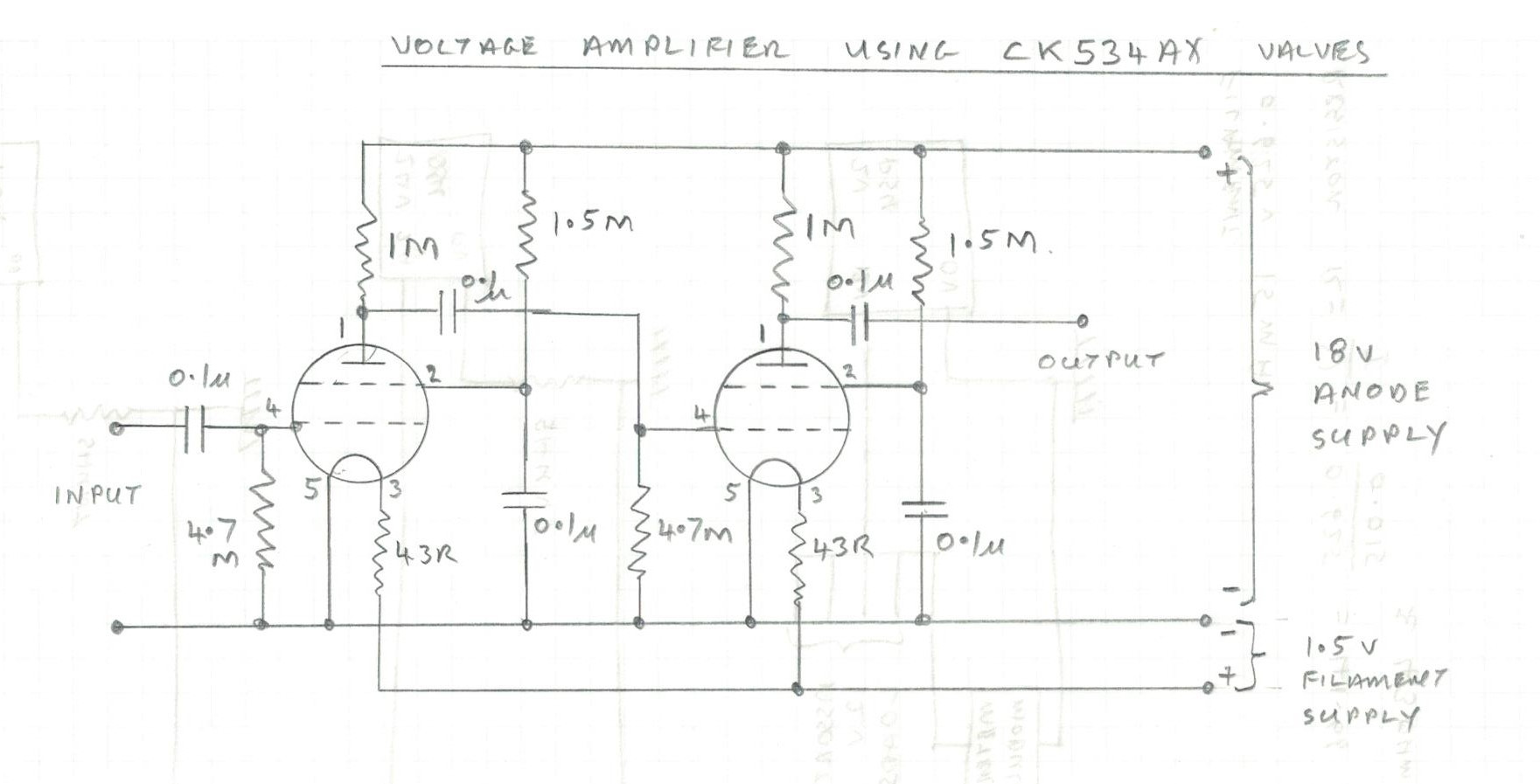

  1. I'm trying to design a micro sized tube amp that would use two CK534AX vacuum tubes powered by a 9v battery.
  2. I understand that this is probably a silly thing to try and make the output will not be that much of an increase if any, but I want to make it anyways seeing as how I have a whole bag of these tubes.
  3. I also have the data sheet for this particular tube with all the values need for operation, but since in a novice in this trade i'm finding it difficult to figure out a circuit.

Honestly I'm more invested in just trying to figure out how to power the filament at this point more than the thing as a whole working, I've been messing with it for a few weeks now and I just want to know the best way to power it.
Are headphones made with an impedance of 5 Megohms?? Most headphones are 32 ohms but a few are 600 ohms.
63 years ago all audio products produced distortion so the datasheet for this little old tube does not even mention it.
Where will you get the 0.625V at 15mA required by the filament? One AA alkaline cell in series with a transistor can do it for a few days but the voltage will be dropping the entire time, unless you make a voltage regulator.
That's why i started this thread to see if someone could help me figure out a way to regulate the voltage to .625v / 15ma from a 9v battery and in general just to learn how to set up a tube amp / preamp, whatever.
If you can help me set up a circuit great, fantastic, thats literally all I want.

Here is my attempt at a schematic for a two stage amplifier:
One of the original specifications was that it should use a 9v battery.
While drawing the schematic, I used an 18v supply which would probably be better, but 9v may be OK.
There is a need for a separate 1.5v supply for the valve heaters.
The heaters are rated at 0.625v which is why the 43 Ohm resistors are included in the connection to pin 3 of each valve to allow connection to a simple 1.5v cell.
I did initially consider connecting the two heaters in series, so making a 1.25v heater chain.
But small battery valves like these rely on the heater supply to provide the grid bias, which is why the filament connections are specified as positive and negative in the datasheet.
It may be possible to modify the circuit to a series heater arrangement, but I think that this would involve changes to the rest of the circuit, so lets just "Keep It Simple".
Be aware that this is what is known as a "voltage amplifier", it will not provide much output power.
The output impedance is high and will be loaded quite heavily when connected to an external low impedance load.
You are welcome.
In the unlikely event that you are passing near Peterhead, you owe me a bacon sandwich. :)
