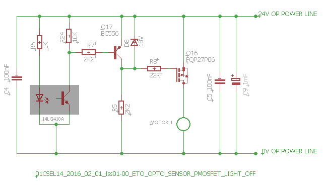

Hi Kal,
Your circuit is reproduced above.
Yes, the PMOSFET is correctly connected as you say.
But the 18V Zener is in the wrong position. Its purpose is to ensure that the gate/source voltage of the PMOSFET never exceeds 20V. To do this the Zener needs to be connected across the gate/source terminals rather than the gate/drain terminals as in the above schematic (consider R1 to be a conductor).
At the moment, when Q1 is conducting, its collector will be at 0V, so the gate of the PMOSFET (call it Q2) will also be at 0V. The source of Q2 is connected to 24V, so this means the there will be 24V across the gate/source terminals of Q2. This will turn Q2 hard on and will probably damage Q2 because the limit of 20V across the gate/source voltage will have been exceeded by 4V.
When Q1 is turned off, R5 (2K2) will try to drag the collector of Q1 to 24V. It will not be able to do this because D1 (18V Zener) will start conducting at 18V and clamp Q1 collector to 18V. Thus Q2 will have 18V on its gate. But as Q2 source is connected to 24V this means that Q2 gate is 6V more negative than Q2 source. This means that Q2 will still be turned on but not as hard as with 18V across Q2 gate source.
You cannot just connect the Zenner diode across the gate/source terminal of Q2, because then when Q1 conducts there will be nothing to limit Q1 collector current or the current through the Zener, with the result that one or both components will be destroyed.
The solution is to use one of the circuits that I have suggested, which also use the opto sensor as defined in the data sheet.
You are exceeding the max allowed Gate to Source voltage for the PFet

Hy kal,
Firstly let me assure you that the above circuit is correct and will work as intended. I suspect that you have the PMOSFET incorrectly wired. I also suspect that that your PMOSFET is blown. The IRF7404 type is not suitable for this application anyway.
P Type MOSFET Operation
A PMOSFET is the compliment of an NMOSFET. This means that all the operating voltages are reversed. Under normal operating conditions the drain of a PMOSFET is more negative than the source. If the gate and drain are at the same potential no drain current will flow. If the gate is more negative than the source drain current will flow. So in the opto sensor the PMOSFET source would be connected to 24V and the drain would be connected to the top of the motor.
Circuit Function light on
Light impinges on the Opto Receiving Transistor (ORT) this causes an ORT collector current to flow from the 24V supply line through the emitter base junction of Q17 (consider R7 to be a short circuit at the currents concerned).
The current flowing through Q17 base emitter will generate a Q17 collector current of hFE Q17 * Ib to flow in the collector of Q17, but this current is limited by R5 (2K2) to 24V/2K2 = 10.9 mA.
As the whole supply line voltage is dropped across R5, the collector of Q17 will be at 24V. This voltage will also be on the gate of PMOSFET Q16 (R8 has no effect). As the drain of Q16 is also at 24V there is OV between the gate and source, so Q16 is turned off.
Circuit Function light off
No light impinges on the ORT so only a small dark current flows in the ORT collector. This small current flows through R24 (10K) and does not generate enough voltage (600mV) to turn Q17 on.
As Q17 is off R5 tries to drag Q17 collector down to 0V but Zener D8 prevents this and starts conducting at 24V-18V = 6V. The net result is that gate of PMOSFET Q16 is at 6V and its source is at 24V so the gate is 18V more negative than the drain. This means that Q16 is fully turned on.
Zener Diode
You ask what the Zener diode is for: simply to protect Q16. It serves no other purpose. The data sheet for the PMOSFET says that the gate should never be more than +-20V with respect to the source. Without the Zener the gate could be 24V more negative than the source which could potentially destroy the PMOSFET.
What does R7 (2K2) do?
R7 in the base of Q7 probably looks a bit odd but it is there to protect the collector of the ORT and Q17 base from destructive current flow from the 24V supply rail to 0V. You might say but the data sheet says only a maximum of 18 mA will flow in the ORT and you would be right, except:
(1) Radio frequency interference could cause the ORT to conduct heavily
(2) Electrostatic discharge could cause the ORT to conduct heavily.
(3) High energy radiation could cause the ORT to conduct heavily (Gamma, X, etc)
Also an arrangement like that is like a loaded gun waiting to go off and even if an excess current could not possibly flow in theory, you would still protect against it as a matter of good design.

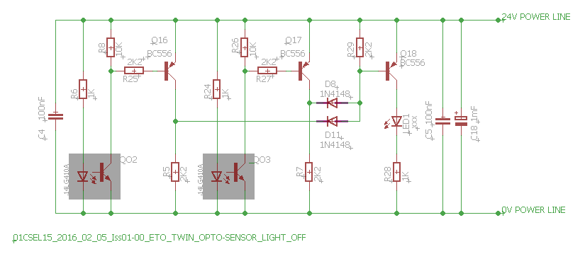

Hello Spec, Hope you are well and don't mind me picking your brains a little more on the same topic.
I put the circuit together on a bread board and of course it worked like a charm. Then I got to thinking that I'm actually going to have two of those sensors positioned at 90 degrees out of phase. Only one will be on at a time.
So I **broken link removed**one of your circuits (the one with the BD140 I was using for an LED as I decided I don't need a Mosfet after all because the PLC input requires only 4mA to turn fully on) by adding a another BC557 PNP.
I tried it on a bread board and nothing burnt but buy now I learned that doesn't mean it's correct so I thought I'd double check.
Another thing I was thinking of is that although the BD140 preformed wonderfully and did not burn like the Mosfets with all my abuse I could also just use another BC557 as it will be required to conduct a few milliamps. What do you think?
Oh and one more thing :sorry: what happens if I use the BD140 almost as a **broken link removed** so that it would switch the PLC input and shares only ground with the PLC . I'm not quite sure if current would flow the same way form V+ of one supply into the other.
I'm not inclined to do it this way but curious as to the effect.
Cheers
Kal

Hy kal,
I'm fine thanks and hope you are too. I don't mind answering any questions at all.
Your latest circuit is reproduced above:
First let me say that there is some very good thinking in this adaptation to a twin opto sensor circuit. It is quite clear that you know what you are doing judging by your approach. There are though two detailed issues:
(1) LED Current
You have connected both opto-coupler LEDs in parallel and fed them with a current via a single 1K resistor from 24V. As the individual LED forward voltages (VFs) will vary due to manufacturing tolerances, the LED with the lowest VF will hog all the current and the other LED will be starved. The unbalance might be so bad that one LED may not illuminate at all. In practice, both LEDs would probably illuminate, but this is not a worst case toleranced design. The solution is simple: use individual 1K resistors connected to 24V, one for each LED.
(2) BD140 Base Drive (call it Q2)
When U1 and/or U2 opto receiver transistors (ORTs) receive light they will turn on their respective PNP BC556 transistors which means that Q2 (BD140) will always be turned off.
The resolution for this problem is quite simple as shown in the schematic below.
To answer your question about interfacing to a PLC: yes that would be perfectly feasible. If you post details of the PLC input, I will post a simple interface circuit. Yes, the two circuits could use a common 0V, or if if you wanted two different 0Vs you could use an optocoupler to totally isolate the optosensor circuit from the PLC circuit.
ERRATA
(1) C18 should read 47uF or larger (as no motor is involved less current is conducted from the power line so the low frequency decoupling capacitor value can be reduced from 1mF)
(2) C4 can be deleted (same reason as (1) above)

And of course my schematic wouldn't work and I should've seen it. I had the sensors in my hand activating one at a time, no wonder I got false results.

Thanks for pointing out both my mistake and the function of diodes as logic gates. I had a great read and will continue to play with them.
But...... I decided to wire two sets of circuits and will try to fit them on the same board for practical reasons.
Here's what I'm doing. I have a motor which will be powered and controlled by a PLC through logic controlling electronic circuitry and relays. I will position on the motor shaft a slotted disc and two optical sensors.
The idea is to use those sensors as an optical encoder though a primitive one. The output of the Mosfet (now a BC556) has to change state from on to off or in other words it has to pulse.
With one sensor I would have let's say five pulses per revolution (the disc has five notches on it) with the addition of a sensor out of phase with the first I will have 10 pulses per revolution thereby doubling the resolution. I will also be using the rising and falling edges of each pulse which means that I will quadruple the resolution. Another reason they should not be on at the same time is that by pulsing one after the other I can tell direction.
I looked at the idea of having a logical wiring of the transistors to insure they provide a pulse the way I described it and I'm thinking they may screw up the timing of the Ons and Offs that they will not reflect the RPM of the motor although the idea intrigued me. But it's beyond my pay grade so to speak. I will keep it in the back of my mind though as I learn more electronics and digital circuitry and keep as a future project.
Thanks a lot

The final result of the project is complete, tested and in action. I made an **broken link removed**with dual connection to connect two sensors and there by have a "Quadrature AB encoder"
Excellent,
Well done :)

Hello spec,
The 1K resistor on the Anode of the photo transistor gets a bit warm and I'm starting to wonder whether I should replace it with a 2K2 to reduce the current or is better to replace the 1K- 1/2 Watt with a 1Watt resistor.
If my calculation is correct I have a 24V supply and a typical Vf of 1.2V 24-1.2 = 22.8 / 1000Ohms = .0228 Amps X 0.51 Watt. I think my 1/2 Watt resistor is too small.
Cheers
Kal
