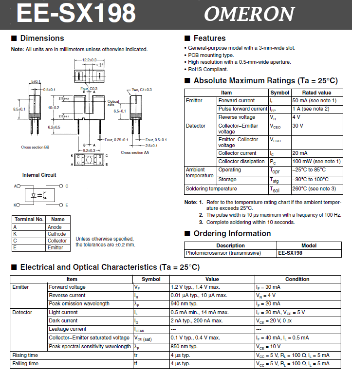

Please have a look at this datasheet ee-sx198 (not the right datasheet) and tell me if I understand it correctly.
For the emitter the forward voltage 1.2-1.4 V at 30mA
As for the detector it is a bit confusing. The forward light current (If) is 20mA at 5V. But what are the numbers under the Value section which say .05mA min, 14mA max?
And what about the Collector-Emitter voltage (Vceo) of 30V listed under the absolute maximum ratings section. So which is it? 5V or 30V?
At 30mA current through the LED, the voltage across the LED (i.e. the forward voltage) is between 1.2 and 1.4 volts.
The test conditions for the transistor are to hold 5V across its collector-emitter terminals. In this case, with 20mA flowing through the LED, the collector-emitter current will be between 0.5mA and 14mA. The 5V is across the output (phototransistor C-E), not the input LED.
The 5V C-E is just for defining the test setup. The 30V in the abs. max. ratings sections is telling you not to ever put >30V across the phototransistor C-E terminals.
Hope that helps.

Hope you are well. I see you are working with photo detectors now. Well the good news is that they are quite simple to understand and work with. I am surprised that you have managed to blow some up because, under normal circumstances, that is practically impossible. The problem, I expect is that you have been placing a voltages on parts of the photo detector which has caused a large current to flow and melted the semiconductor material. In general always apply a voltage via a series resistor to limit the current. Incidentally that is a fairly good rule for many situations when you are not certain about what is going on.
Above is an extract from the Omeron EE-SX198 slot opto detector data sheet where I have physically inverted the transmitter LED in the schematic to make the operation clearer; the connections etc are still the same.

(1) Forward voltage (VF)
(2) Forward Current (IF)
The opto receiver is a fairly normal bipolar junction transistor (BJT) which has a window built into it. To conduct, normal BJTs require base current, but they will also conduct if light impinges on their junctions. That is what is done here. Incidentally you can convert some BJTs into opto sensors by removing the casing. There are, once again, only two characteristics you need from the data sheet for the opto sensor transistor:
(1) Current flow when light impinges on the opto transistor
(2) Voltage the opto transistor will stand
You can simply forget all the other stuff for your present work

Assume you have a 5V supply line.
To operate the transmitter LED the way that the manufacturer recommends on the data sheet, you need:
(1) IF= 30mA
(2) At an IF of 30ma the VF is 1.2V to 1.4V
Taking the average VF as 1.3V, you can calculate what resistor you need between the 5V supply line and the anode of the transmitting LED by:
5V - 1.3V = 3.7V. To lose 3.7V at 30mA, R = 3.7V/30mA = 123.33 Ohms. A standard 120 Ohm resistor would be fine.
With 5V on the collector of the opto transistor the collector current would be between 500uA and 18mA depending on the particular opto sensor. Note that, in general, you must never connect a voltage to a transistor without some form of current limiting, normally a series resistor. A simple circuit could translate the collector current into a signal suitable for most applications: relay, TTL, CMOS, etc

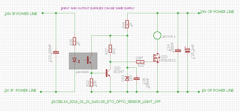

Here's a **broken link removed**of what I have in mind for a similar photo transistor but one that I believe requires 5V for the transmitter. I could not find the exact components I wanted so you will have to use your imagination. D1 is a zener diode with break down voltage of 5.1V and D2 is a zener diode with a break down voltage of 12V. The photo transistor is U1 and M1 is the NPN Mosfet with l1 being the PLC input (the PLC input is sinking so I will actually have to put a resistor there too).
I also had a 10K resistor from gate to ground which messes up my voltage values at the gate and will require more trial and error so I left it out for now.
So what do you think guys, am I going to burn yet another photo transistor or will this work?

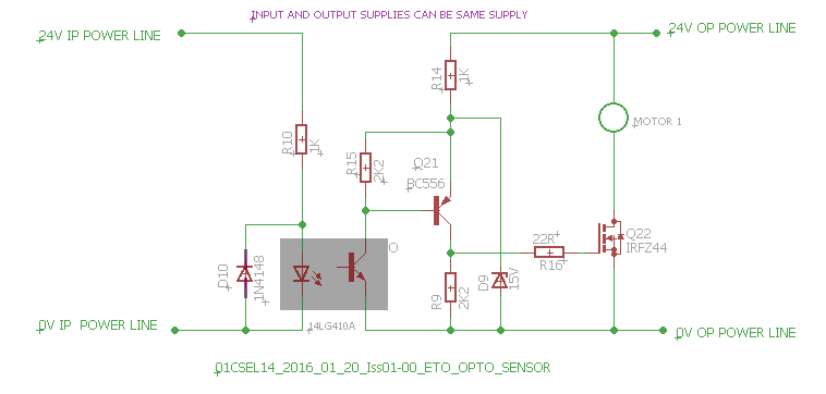

You will not blow anything up with that circuit, but unfortunately the circuit will not work. I will post a slightly modified circuit that will be safe and will work. I see you have moved from an opto sensor to an optop coupler.

https://www.vishay.com/docs/91291/91291.pdf
ERRATA
(1) NTE 2913 can replace the MOSFET shown
(2) This circuit is a light on configuration
(3) R16 is a gate stopper to prevent the MOSFET from oscillating. It should be mounted directly on the gate connection.
(4) the 15V Zener protects the gate of the MOSFET (+-20V max)
(5) the diode across the LED has no function and can be omitted. It simply protects the LED against reverse connection of the 24V supply.
(6) decoupling is omitted: Fit 100nF capacitor across the input 24V supply. Fit a 100nF capacitor across the output 24V supply. Fit a 1mF capacitor across the output 24V supply.
(7) Change Zener voltage to 18V

I take it the link to the datasheet is a hint that the Mosfet is an N-channel? (I'm using a different N-channel mosfet by the way NTE2913 but that was the one I found in LTspice).
So let's see if I'm following. The photo transistor detector is NPN which means it is switching negative signal so you put in the BC556 PNP transistor basically to invert the signal to a positive one so that we can use it on our gate at the N-Channel mosfet.
I hope I'm on the right track and please let me know.
But then this circuit would basically be the opposite of the one I posted. This one is "Light On" and mine is "Dark ON".

I take it the link to the datasheet is a hint that the Mosfet is an N-channel? (I'm using a different N-channel MOSFET by the way NTE2913 but that was the one I found in LTspice).
I thought you were using an IRFZ44. That was why I designed it in. Data sheet link added for convenience only- no other reason. It is always handy to have backing data so you can cross refer form the schematic to component characteristics.
https://www.nteinc.com/specs/2900to2999/pdf/nte2913.pdf
Hell, kal. That is some MOSFET you have chosen: 110A. 8 mOhm. You could short-out the National Grid with that!
So let's see if I'm following. The photo transistor detector is NPN which means it is switching negative signal so you put in the BC556 PNP transistor basically to invert the signal to a positive one so that we can use it on our gate at the N-Channel MOSFET. I hope I'm on the right track and please let me know.
That is essentially correct.
I hadn't appreciated that. I will post a dark on schematic.
I'm going to wire it up in LTSpice and try it out.
That will be interesting- hope the circuit works :wideyed:

ERRATA
(1) Q20 should be BC546 not BC547. Note this is only in the interests of parts variety reduction. A BC547 will be fine as would many other small signal NPN transistors.
(2) Note that R21 is a gate stopper to prevent MOSFET Q23 from oscillating. R21 should be mounted directly on the gate of Q23
(3) Note 1mF = 1000uF
(4) Change Zener voltage to 18V
