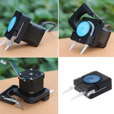

I'd back Alex_t's suggestion of a peristaltic pump.
It's infinitely variable volume and little to go wrong.
eg. From a quick ebay search:
Possibly driven using a DC or stepper motor with an added gear reduction stage, so it takes a reasonable time or number of steps to deliver the amount of fluid you need, if a direct drive does not give adequate repeatability.
