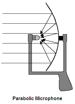

In the bellow pic it seems the mike is put so that its back picks up the reflected waves and so I thought maybe the pad helps to change the waves position so that they go to the mike?
The mic is shown pointing away from the dish which is wrong.
The mic should point towards the dish like this:
You can't even see the mic, it's hidden underneath the windshield, the insert itself is probably (certainly?) pointing back towards the dish at it's focal point.
