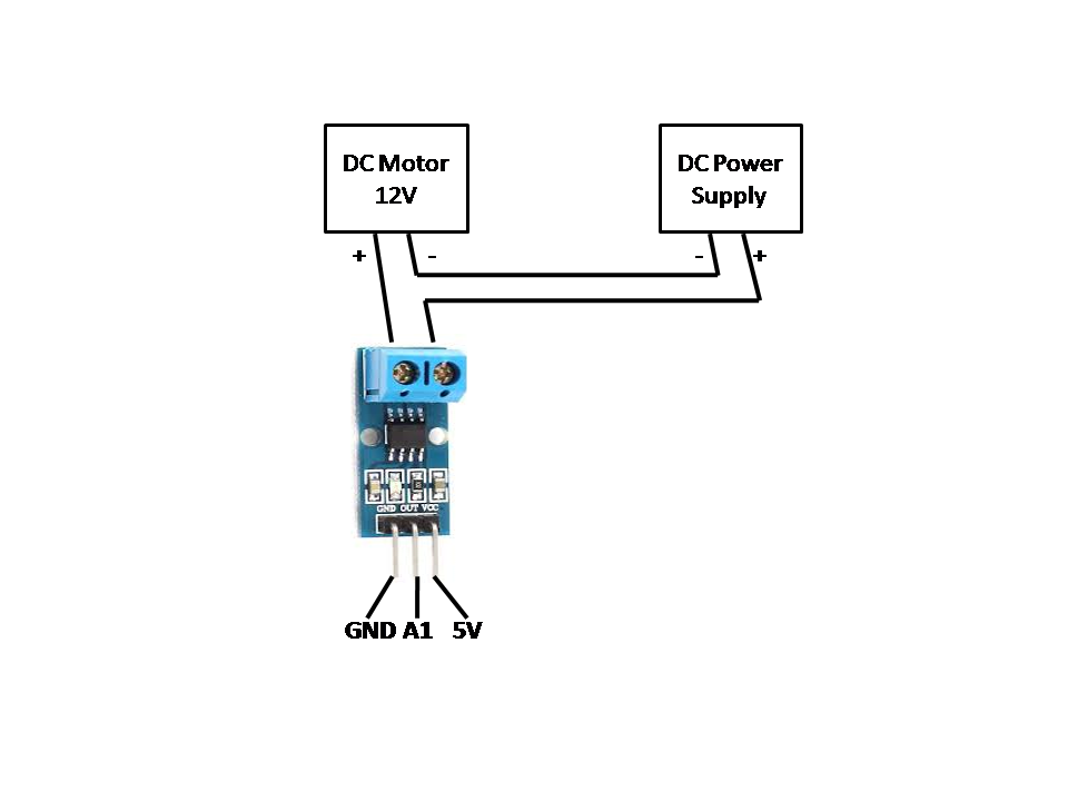

Hi everyone
i am trying to mesure the curent of a 12v DC motor using Acs712 and arduino nano. i used this diagram
i used this code

What are all the other values printed? I.E raw etc. What reading do you get? Is it connected the right way around? Do you need to set the pin to input?
Read the datasheet.
The ACS712's quiescent voltage (meaning zero current) is half its supply voltage.
Depending on the polarity of the current flow, this voltage increases decreases.
So first things first: measure with a DMM the actual ACS712 output voltage with and without current.
Be wary mixing number types with C code, compilers may reduce the calculation (or part of it) to the simplest type.
eg. If the result of a calculation is float or double, all other values involved should be as well to avoid the chance of errors.
Add a decimal point to constants to force them to float, or decimal point and "l" (lower case L) to force a double.
Try changing these two lines:
Voltage = ((double)RawValue / 1024.0l) * 5000.0l; // Gets you mV
Amps = ((Voltage - (double)ACSoffset) / (double)mVperAmp);
It may make no difference or it could give a different result; it's worth a try.
It looks to me like you are using the 5 Amp version so the sensitivity is 185 mV/Amp. Using your Arduino you have a 10 bit analog input so 2^10=1024. You are also likely using a 5 volt reference so for your analog input channel 0 to 5 volts = 0 to 1023 bits or 1024 quantization levels. This is where your code covers:
Voltage = (RawValue / 1024.0) * 5000; // Gets you mV
So the incoming analog value now becomes 0 to 5000 mV or 0 to 5.0 Volts. You also have 5 volts divided down by 1024 bits = 5 / 1024 = 0.00488 or about a 4.88 mV and trying to measure 13 mA for your motor you will have poor resolution. This does not even take into account noise or A/D conversion error. Figure 1.0 Amp = about 185 mV so 100 mA = 18.5 mV and 10 mA = 1.85 mV. You mention about a 12 mA motor load?
Also as drawn it looks like you are measuring the high side current? I would try connecting your battery (supply) positive (+) directly to your motor positive (+) and your motor negative (-) to your ACS 712 IP + (Current Positive) and the ACS 712 IP - (current negative) to your supply negative (-). Your Arduino common should share your ACS 712 common and both powered by 5 volts.

I've just done this.
Rob has it right, only that sensor can measure + and - current, therefore when theres no current it outputs 2.5v.

Well it's not C, it's C++ with an Arduino - but easily converted to C. It's not really a 'driver' either, just a simple library to make using it even easier, it's just a question of reading the analogue voltage out, subtracting the zero voltage offset (2.5V) and scaling accordingly.
I did buy some of these, but their resolution is fairly poor, though obviously great for higher currents. I must admit I do like the INA219, and you can set the range to whatever you like by changing the shunt resistor.
