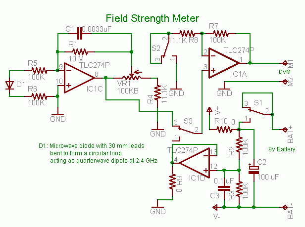

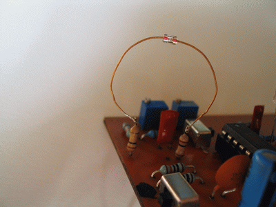

Hi I am back to report what I have done so far with regard to my attempt to build a radiation detector for mobile phones.
Please refer to the circuit diagram and photo attached.
Due to unavailability of microwave diodes locally (such as 1N5711 or SMS7630 as recommended by friends at this forum ) I have used one found in the shelf. There is no marking on the diode though, I remember it is one for microwave.
As for the antenna I have done it unconventionally. I just bend the 30 mm leads of the diode to form a loop, and solder them at the ends to the 100 Kohm resistors. The two resistors are meant to be RF chokes, though the conventional way of ferrite beads (again not available locally!) might be better ?
In this way, I think I have made a quatrerwave dipole at 2.4 GHz but without the need to solder the diode close to the junctions (the conventional way that make me feel uneasy as my precious diode might thus be destroyed by heat!)
The amplifier circuit is the one modified from a UVB light detector I built not long ago. No provision for zero adjustment is built in. With TLC274P IC1A set to unity gain by S2, IC1C set to X10 gain by VR1, I have found the output DVM reads as high as
0.5 V when the detector is two meter away from a microwave oven ! and
0.4 V when it is 50 cm from the talking mobile phone !
A sensitivity higher than what I have expected !
