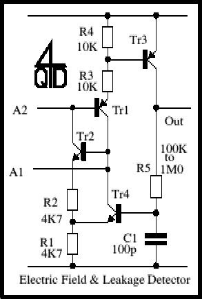

After much hard work of searching, I have eventually found a website relevant, providing a clever method of "electric field and leakage detector" at
https://www.4qdtec.com/putpr.html#efld
There is no mention as up to what frequency it can work. Apart from transistors, nothing seems to be there to limit the frequency of response. However the circuit works like a Geiger Counter, and the output (either in frequency/amplitude of the output pulse) may not be proportional to the amplitude of input radiation.
So this is a wide band RF detector that may be modified to work as a wide band radiation meter?
Any comments on this circuit please?

Oh my gosh, there are so many variables in this type of task that I don't know where to start in giving advice. First off, the detector circuit in that example will not be useful at all since I believe it operates best at fairly low frequencies and so will trigger from any charge pickup due to mains electrics, MW broadcast, static electricity, and hundreds of other low frequency sources. I suspect it would not operate well above 10 MHz in any case.
Detecting electric field, magnetic field, or electromagnetic radiation at specific frequencies, as the others have pointed it, is relatively easy. Measuring, as opposed to detecting, is very difficult. By measuring, we mean determining the amplitude of the field against some accepted scale or relative to a reference. This implies a certain amount of accuracy, and this is where a hobbyist's attempts will not succeed, as accuracy in measuring fields is a science and an art that takes a lot of effort and experience to get to useful levels. But, if you want to try measurement and aren't too worried about accuracy, it might make a useful and fun project anyway.
