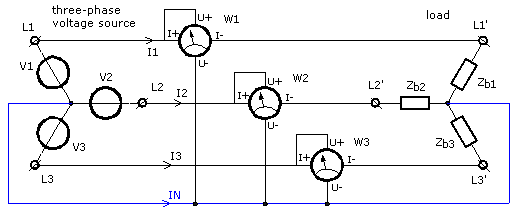

Hello,
I had an idea to measure the consumption of my our newly installed "Air pump" (sorry dont know the exact word in english). It runs on three phase power and I was wondering if I could use 3 ,single phase meters, like this one SONOF POW . So I would use one for each phase. And since the air pump says it has 9kW power, and these handle 3.5kW each I think it should be fine.
Would that be even remotly possible?

You can use one, two, or three watt meters depending on the details of the thing you're measuring.
One Watt Meter: only valid if you know for a fact that the load on all three-phases are identical. Then you just measure power on one phase and multiply by three. Since you can never be sure they are identical without always monitoring them, this method is inadvisable.
Two Watt Meters: If no neutral wire is available (i.e. delta-connected, three wires only). Add the value from both wattmeters.
Three Watt Meters: If a neutral wire is available (aka. Wye-connected, three wires plus a fourth neutral wire). Add the readings from all three watt meters. Must place wattmeter to measure between each phase wire and neutral.

To use two single phase meters they have to be rated to the phase-phase voltage. I guess the motor is rated at approximately 400 V phase - phase, and the supply is approximately 230 V phase - neutral. Therefore to use two meters, both need to work at 400 V. It is probably cheaper to use 3 meters rated to 230 V.
Also, you shouldn’t use the power meters that you linked to, because they are also able to switch off the load. Switching the three phases individually with switches rated to 230 V can result in problems.

2. I belive it is connected with three phases with no neutral ( I can only see the three wires with 16A 400V fuses), but I'll have to check. Would measuring the power still be possible without the neutral wire, if I were to use those, since they only handle 250v? If yes, how would I connect it?

If those power meters are what you want to use, it's fine to connect them all to one phase and the neutral, and it doesn't matter that the motor has no neutral connection. You just connect them like this:-
but without the neutral connection to the star point of the load. The three meters will measure balanced or unbalanced loads. With a simple 3-phase motor, I would expect all three meters to be within a few percent of each other.
I suggest that you bypass the switches within the power meters so that they can't turn off.

Using this PHOTO , how would it be connected, so It would be one meter per phase? Do they all have the same neutral wire going to the heating pump like on the drawing? Where would I get the neutral wire going to the meter? Would it be from that blue line like it is in the picture I posted one post above or would it be the one which is supposed to already be going to the pump?

There is probably no neutral wire going to the pump. The meter in the photo with the plug and the heater will have the neutral in and neutral out connected together, like the earths are, so you only need one neutral connection to each meter. So each meter will have live in, live out, neutral and earth. Connect all three neutrals together and to the main blue line into the house. Connect all three earths together and earth them. Then connect the three 3-phase live wires from the circuit breaker to the three live in wires, one on each meter. Then connect the heat pump to the three live out connections.
You would need to put the meters where they can have a neutral connection.

I found the user manual for the heat pump ( Fujitsu Waterstage 11kw) and this is how its connected PICTURE . It has a neutral and the power goes to the outside unit first, then to the inside one, that I find kinda strange but whatever. So would that technique still work? I would have to connect the same neutral wire that goes to the outside unit to all three power meters right?
It's not a surprise that the power goes to the outside unit first. It looks like the outside unit uses all the power and the inside unit takes very little so that arrangement makes sense.
Metering the power to the outside unit will include power to the inside unit but that will be very little and you are probably interested in the total power consumption anyhow.
For metering purposes it doesn't make any difference which neutral you connect to, but for safety and if there are any ELCBs you should not connect anything from the live or lives of one circuit to a neutral from another circuit.
You should connect the metering circuit suggested in this discussion into the wires feeding the outside unit.
