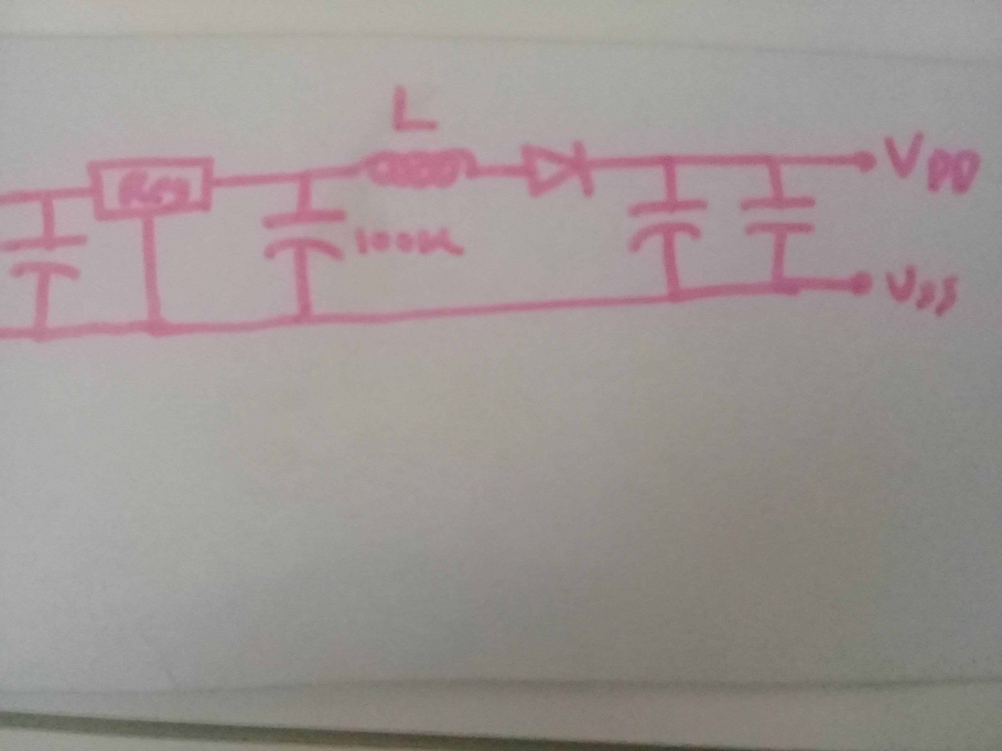

Try placing a series diode that isolates the 10uF and 0.1uF MCU capacitors from the 100uF capacitor and connect the inductor coil on the anode side of the diode (so the inductor coil can only draw current from the 100uF capacitor and cannot draw current from the 10uF and 0.1uF capacitors).
Like this ?
What is the value if L?

You don't need the L. Wire mcu on right side of diode and relay on left side.

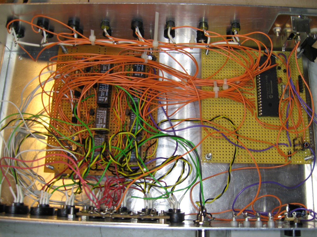

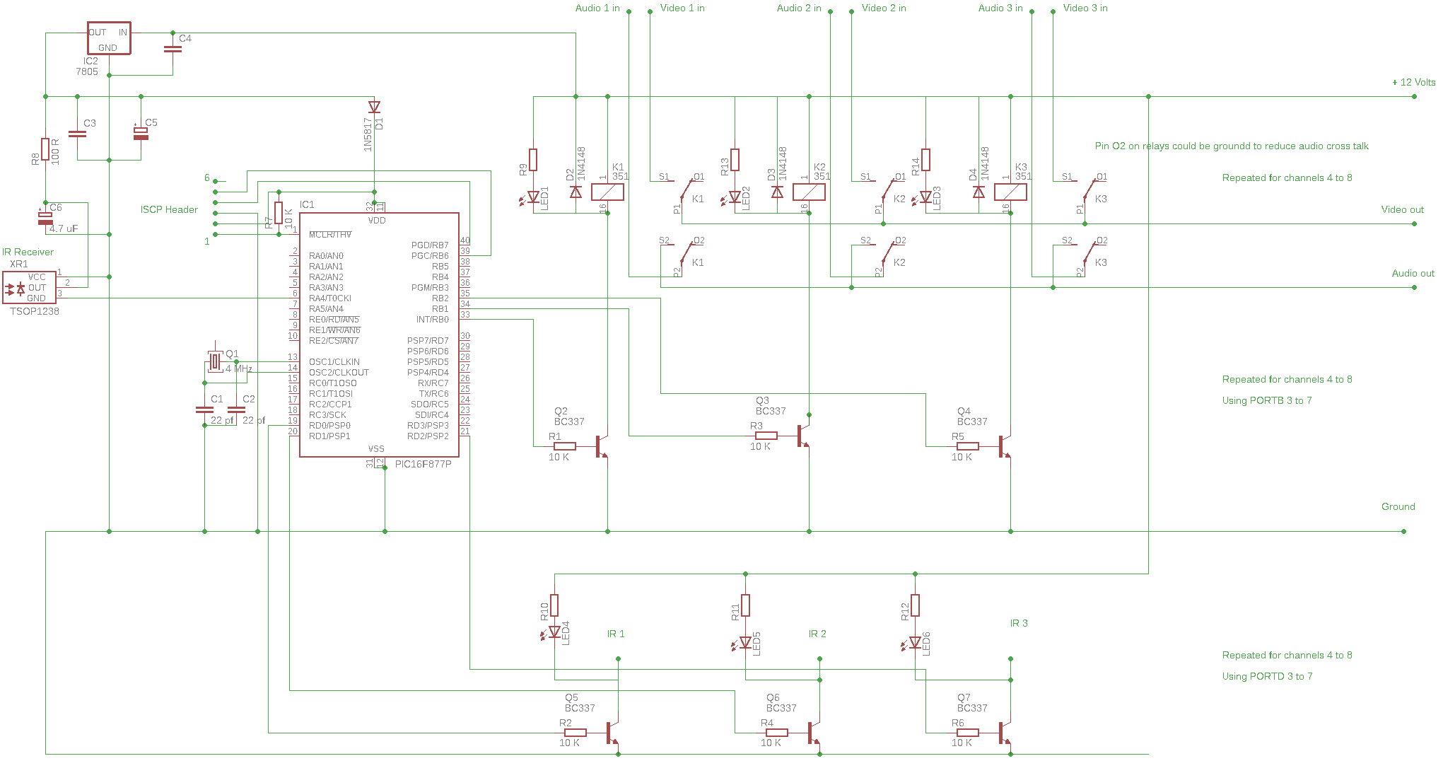

I have been using a PIC16f877 in a camera switching unit for years driving 8 relays with no problems. This is the schematic.
This is a picture of the construction. As you can see it is rather a rats nest with no special precautions about screening or supply decoupling. (The 100 nF supply decoupling capacitor is for the proccesor is mounted underneath it in the space between the sides of the socket).
Les.
