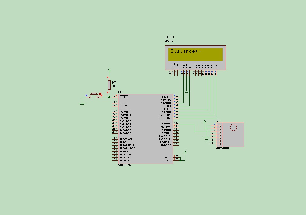

maxsonar Ezo circuitary with atmega16
jerry1234
as circuit image is attached and for the circuit the is also attach...
i hav a problem in this module...
problem is sensor donot showing its distance calculation on lcd...
can anybody plzzz tell me how i get solve this problem.....
its v urgent plzzz help me.....
the program is...

Power up *JUST* the sonar module and point it at a flat surface, then measure the voltage at the analog output with a digital multimeter. Do this a few times, each time with the module a different distance from the flat surface and note the voltage each time. This will tell you if the module is working properly, I suspect that it is.
You can move on to working at other possible problems after you have done this.
i had check this with multimeter...
Yes sonar is showing different readings....
but when i attach this sonar wth atmega 16 and with programming it soesnt showing any response that was shown by sonar in multimeter.......
Y...???
Unfortunately, I'm probably not going to be very helpful. I'm not very strong with C (when compared to the gurus). I don't use sonar modules, I would make them myself. And I don't know a lot about Atmel micros, I use PIC and ASM mostly.
Anyway, if in the above test the sonar module is giving you different voltages with changing distance, then it's probably working fine. The next step would be to check if the LCD works, then the Atmel Microcontroller. I would bet they are all good, and that it is the code that is giving you all your problems.
Did you just copy/paste the code from somewhere without modifications? Because, if you did, then you probably need to do some slight tweaks to it. It doesn't really look like you did, as I see a few little mistakes and points of interest, that I will mention now.
============= Observations =============
Your baud rate for the USART is probably wrong. I assume you are using the "LV-MaxSonar®-EZ0", in which case the baud setting should be 9600, not 4800.
Why is the clock speed set up to "11.0592Mhz internal" Is that even possible? Are you actually using a crystal with that speed printed on it, not an internal oscillator? This just seams like it is set up wrong to me. You shouldn't be able to make the internal oscillator odd speeds like this. It should be an even large number, like 12000000 or 8000000. Telling the rest of the software "this is what the speed is" when it's not true can definitely screw with your USART timings, and make it not get any data from the sonar module.
Why are you sending the string "test" out the USART? Do you have a terminal or something attached to the TX pin on the ATmega? In the schematic, you don't have it hooked up to the sonar module, so that's not the problem. Just keep in mind that (according to the datasheet) if you mess with the RX pin of the sonar module it will stop range finding. Make sure the RX pin of the sonar module is left unconnected, or held high.
The sonar module sends out the ASCII letter "R", the ASCII numerals for the distance (up to 255 inches) then a carriage return. Now maybe I missed it, but I don't see anything in your code to handle/strip the extra data. Are you doing this properly or not?

Mister T will u please summarize the code in correct form....
U got made me confuse....:p
You can pretty much ignore my previous posts. Those were replies to ()blivion (sorry about that). I have not read your code.
What is the problem you are having. Do you have problem with the LCD or with the sensor?
I mean, have you tried to write something simple to the LCD to check that it works. Comment out all the sensor related code and try something simple like: lcd_write_string("Hello LCD!");
And see if the LCD works. That way you can be sure that your LCD is working. After.. and only after.. the LCD works, you can start testing the USART communication.. and after that the sensor. You really need to test and write your code step by step.
Do not send anything to the USART! Don't even connect the usart transmit pin to the sensor!
I have problem with sensors...
LCD is showing the display preety well...
But distance was not changing accordingly with the obstacle motion....:(

So the distance value shown in LCD is constant?
Is the first value correct or just some random value?
Is the value always the same value?
Does the distance value change if you restart the microcontroller and the distance to obstacle is different? I mean, does the sensor only measure once and then stop updating the distance value?
Mister T please tell can i interface these sensors via adc channel of microcontroller ATmega16,because according to the pin discription of these sensor PIN5 which is labelled as AN(analog) which continuously giving the voltage as obstacle move nearer or far from the sensor....:)
Please.. You are not giving enough information. It is impossible to guess what might be wrong.
Does the first value change if you move the obstacle and restart the microcontroller? Is the first value correct?
I think you should keep to the UART communication. Of course you can change to the analog if you want, but I would keep the UART.
First value is correct but not changing further either v restarting microcontroller...:(
You move the obstacle further and then restart the microcontroller, but no change in the value?
Can you post what exactly is displayed on the LCD..
