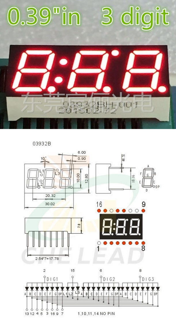

I bought a couple of those volt meters for the bezels. Geesh, that's really a tight fit for three .56" displays. I think these three digit .39" displays (~51 cents each), though much smaller, may work out better for me for these particular bezels.
Mike
Yeah, space is really tight for 0.56" digits! I did lay out boards for 3 individual digits and they work great, except for a minor problem.
I shifted the digits over 1mm from center to give myself more room for the 6 pin header. That shift means a small part of a segment on one side is covered by the bezel. The digits must be centered on the board for this to work. I did use a 2mm header rather than a 0.1" header to save a little room.
