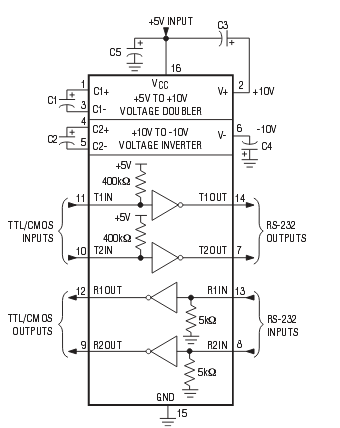

hello guys. I am Timothy. i have been working on Rs232 and serial communication for a while now. the major issue in the circuit is the max232 I.C . i have observed all rules in its connections, still not working. please help out.

I soldered it on a vero board.
i have the schematics, trying to upload it, but cant.
how can i upload schematics here?
Am new here, how can i upload images here, i can only see the option for uploading a file not an image.
There is a button "Upload a File".
In this example I did "Print Screen" then copied to paint. Then selected part of the picture and "Control-C" to copy to this Post.
This part is a little grumpy about where and how the capacitors are placed. C1, C2, C3, C4, C5.
Do you have 10V on Pin 2? and -10V on Pin 6?

"TEST" What do you have? Meter, Scope, Logic Probe? LED and Resistor?
First check the +-ve 10v and see if both present, you could next try taking the TTL inputs hi & low and see of the RS232 swings from + & - v.
Do the same with the RS232 inputs taken to + & - 10v and see if the TTL out puts swing 0 to 5v

want to ask, what is the values of the capacitors. i used 10 uf.
This is my schematics. the only modification is that i used 10uf instead of 1uf capacitor.
I can see nothing wrong with your schematic. I think it should work with the 10uF capacitors. (make sure that the polarity of the capacitors is correct.) You need to post the results of the tests that Max suggested in post #6. If you do not get +10V on pin 2 and - 10V on pin 6 we need to first find out why first.

I am not going to comment any more until we know the voltage on the pins I marked in red.
For pins 13 & 14 they should be measured with and with out the DB9 plugged in.

I have gotten the solution to the problem.
The problem was with the serial to USB converter cable. i changed it by instinct , and the project started working properly.
