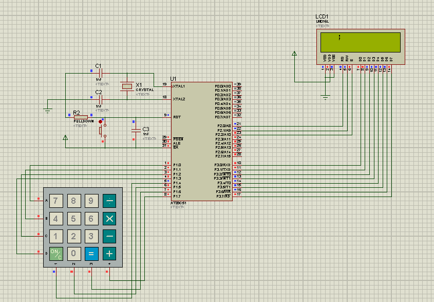

How to make this code workable for my chip

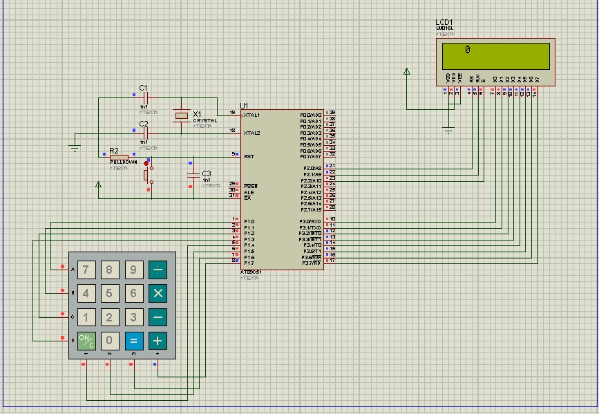

you ware using uart but I don't want to use it. I just wrote simple program on kiel and I think it should be work but it's not working
so can you tell me what's the wrong in my program. why it's not working
C:
#include<reg51.h>
#define LCDport P3
sbit RS = P2^0;
sbit RW = P2^1;
sbit EN = P2^2;
#define KEYport P1
#define C1  P1^0
#define C2  P1^1
#define C3  P1^2
#define C4  P1^3
/* functions for delay */
 void delayUs(unsigned int wait)
     wait >>= 3;
      while(wait--);
 void delayMs(unsigned int wait)
      while(wait--)
  delayUs(1000);
/* Function to send command to LCD */
void LCD_Command(unsigned char cmd)
    LCDport = cmd;
    RS = 0;
    RW = 0;
    EN = 1;
    delayMs(5);
    EN = 0;
/*Function to send data to LCD */
    void LCD_Data(unsigned char dat)
    LCDport = dat;
    RS = 1;
    RW = 0;
    EN = 1;
    delayMs(5);
    EN = 0;
/* Function to prepare the LCD */
void LCD_init(void)
    delayMs(20);
    LCD_Command(0x33);  // Init 8 it
    delayMs(15);
    LCD_Command(0x38);  // Function set
    delayMs(15);
    LCD_Command(0x0C);  // display on
    delayMs(10);
    LCD_Command(0x06);  // direction
    delayMs(5);
    LCD_Command(0x01);  // home...
    delayMs(5);
    void LCD_goto( char x, char y)
   int addr = 0x80;   // start address
   if(y==2) addr+=0x40;  // are we on second row
   addr += x;    // add in the columns
   LCD_Command(addr);   // send to display.
    char keypad(void)
       unsigned char keymask = 0xEF;
       char key = 0, row;
       char act_key[]  = {0,1,4,7,11,2,5,8,10,3,6,9,12} ;
       for(row=0;row < 4; row++)
          KEYport = keymask;
          if(!C1) key = 1;
          if(!C2) key = 2;
          if(!C3) key = 3;
          if(!C4) key = 4;
                   if(key)
              key += (row*4);
              return act_key[key];
                keymask <<= 1;
         keymask ++;
    return key;
void main(void)
    char  ke;
    LCD_init();  // set up LCD
    while(1)
           key = keypad();
            LCD_goto(3,1);
           LCD_Data(key);
I am just trying to display only one key
get the key
set cursor position
print the key
It will not compile as key is not defined... you missed the 'y' of the definition..
My bad I have corrected it. but still program doesn't show key on screen, Do I need to make any other function.
I just want to see one key on screen and I think program should be work because I am following all the basic thing that I know so what's the missing here
I am also getting same result with same code
Now I am thinking to use sdcc . I think its time for programming.
Yes.... key is a number 0 ~ 12... to see it you need to convert to ascii... ie add 48 to key..
LCD_Data(key+48);
but this function return char
