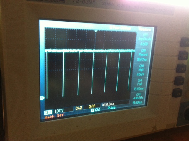

Thanks everybody again,
I took some pictures of the oscillograms:
http://www.restoretronic.com/descargas/ecu/1.jpg
This is the peaks at reset pin on processor at ECU which is not working.

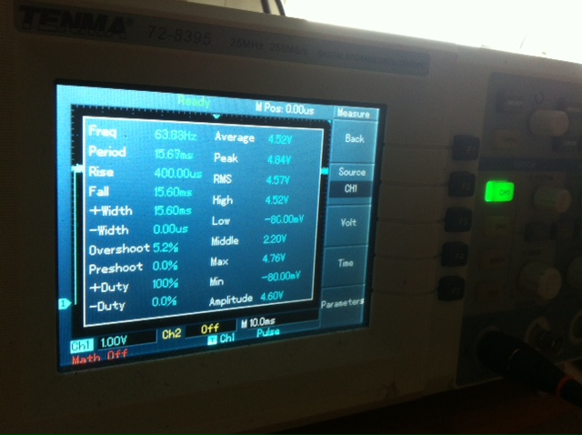

http://www.restoretronic.com/descargas/ecu/3.jpg
These are values of the oscillogram.

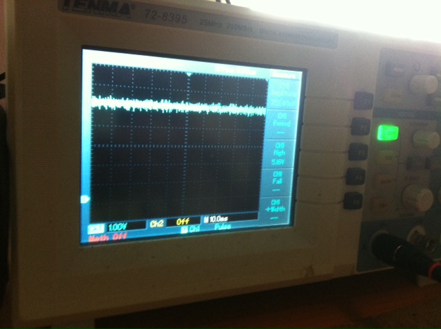

http://www.restoretronic.com/descargas/ecu/2.jpg
This is same pin at ECU which is working.

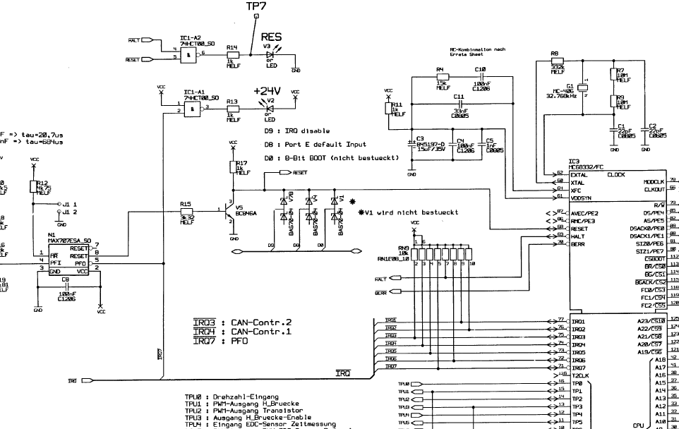

http://www.restoretronic.com/descargas/ecu/4.gif
Reset schematic.
I have no schematic but I´ve seen configuration is very similar from other which I have schematic. The lines D0, D8 and D9 I guess are the cause of the peaks at reset pin. Supervisor IC MAX707 output is at oVdc.

output of MAX707 is LOW so as it goes to the base of a transistor it switches when is HIGH output. At processor reset input we really have pull up signal but with these peaks to ground, this is the reason why I guess the data lines are involved... what is the function of the Schottky diodes there? They are between reset input and these 3 data lines.

It does look as though the 3 schottkeys are connected to the data bus, however I'm not certain as its difficult to read the legend, it looks like D then a number indicating its a data line.
The lower half of the diode chain isnt connected which doesnt make sense unless its a dual diode package and only the top half is used, and even then connecting a dataline to a reset input doesnt make sense.

Thank you for your time. Yes, the dual diode is in the same package sot-23. I don´t know the function of them there, they are connecting data lines to reset, D0 (0 bit boot), D8 (port E default input) and D9 (IRQ Disable).
