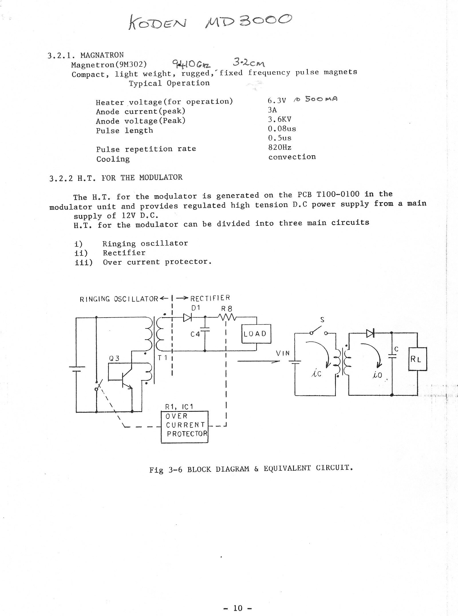

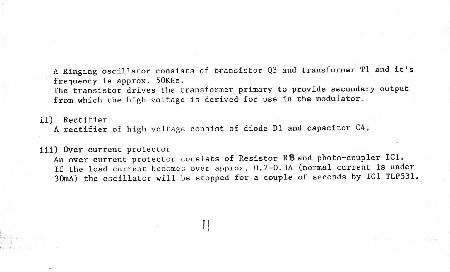

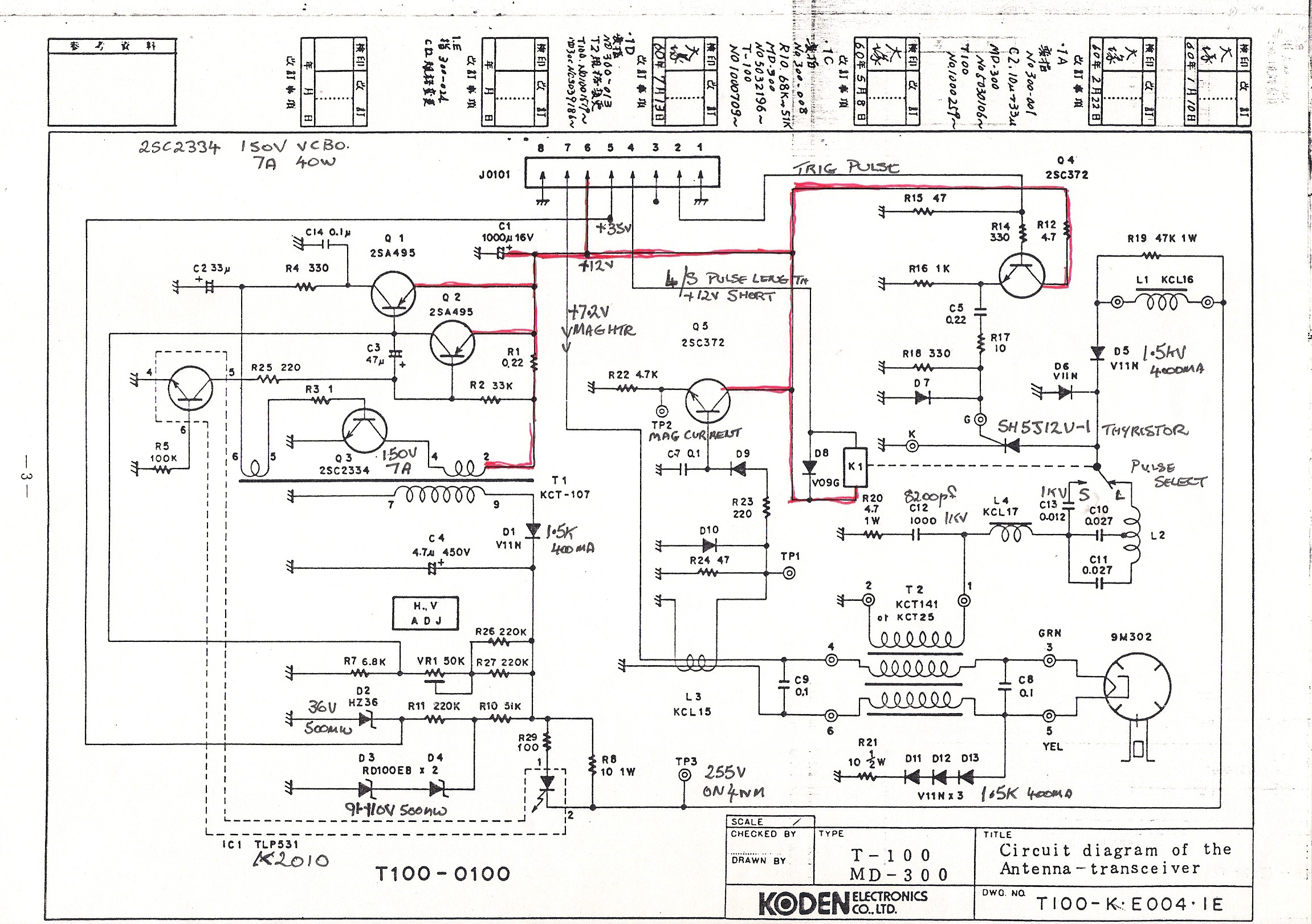

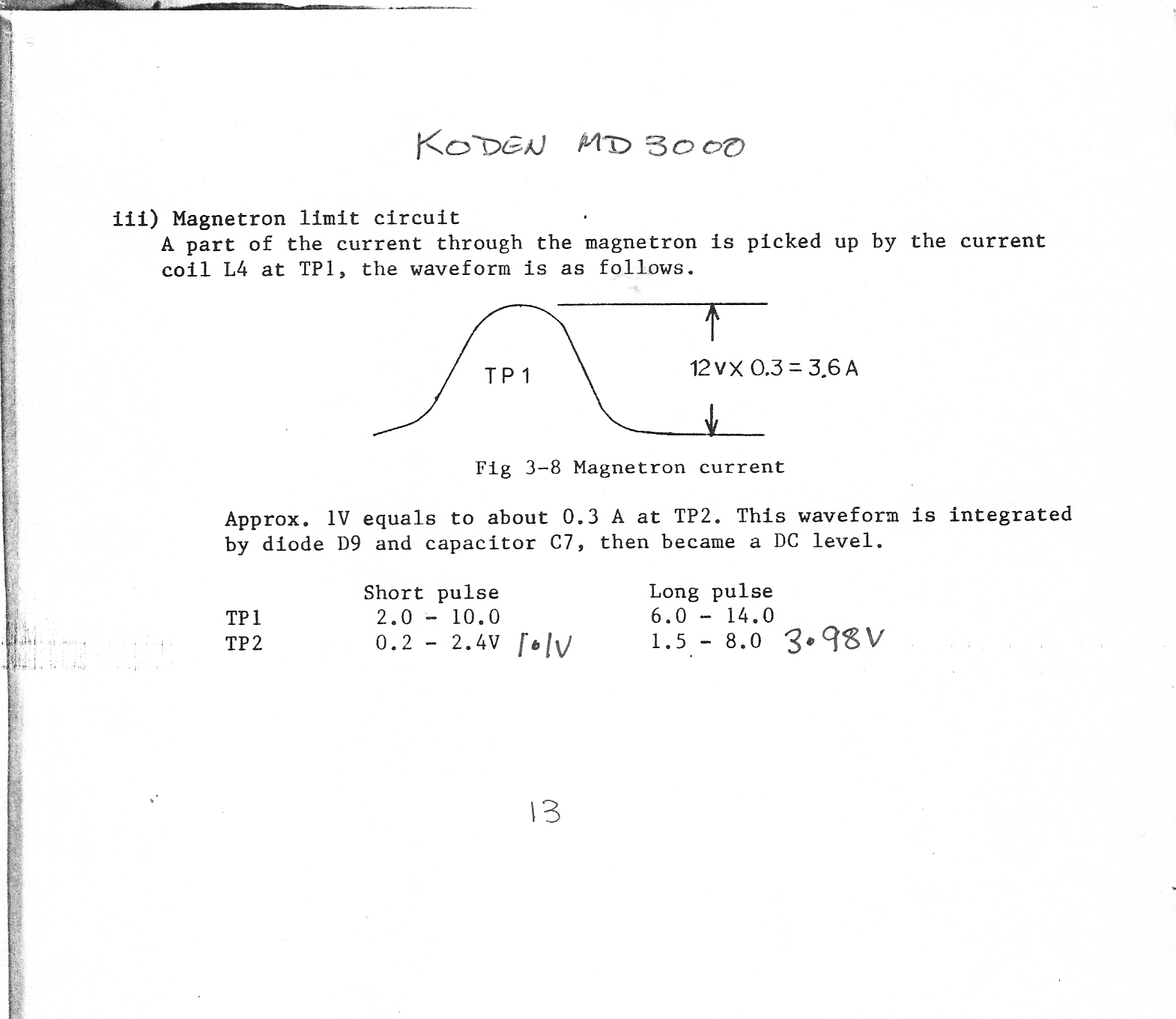

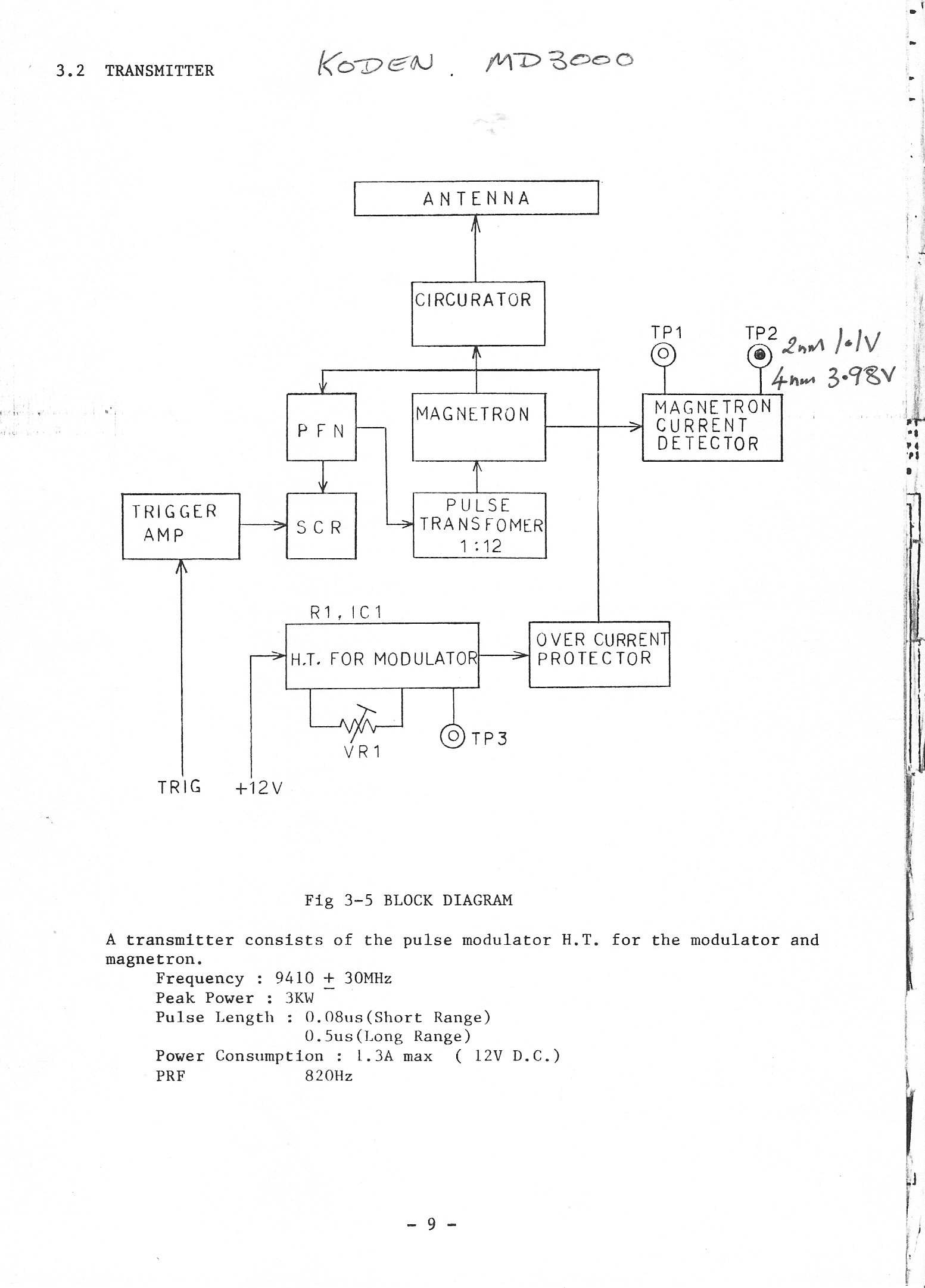

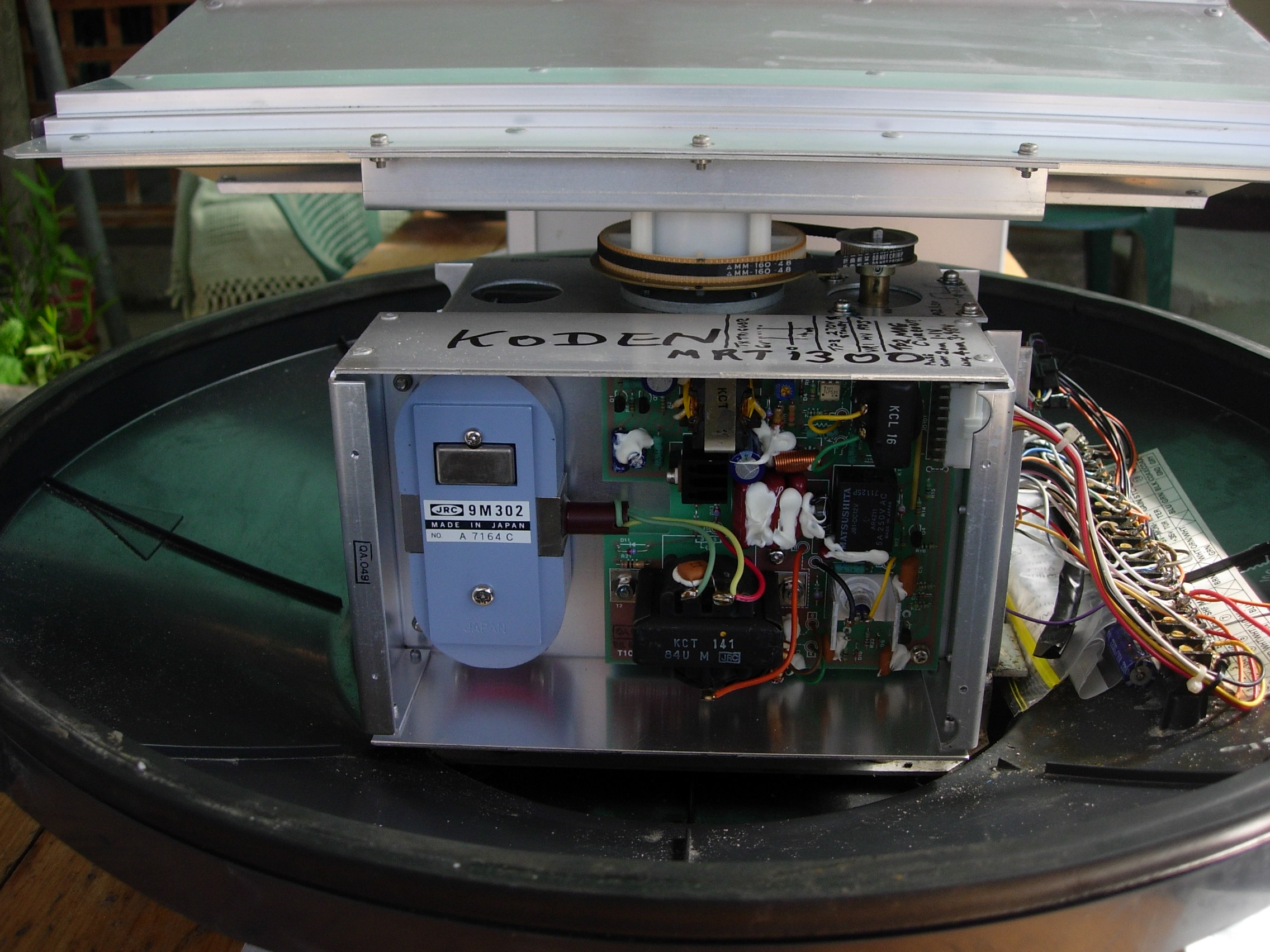

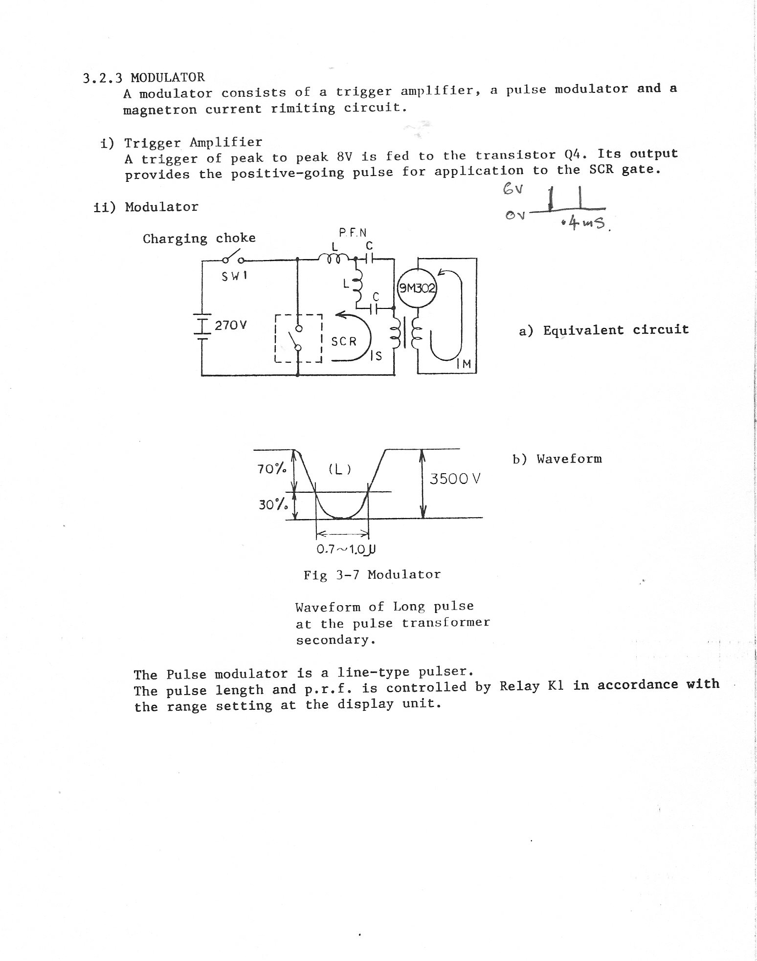

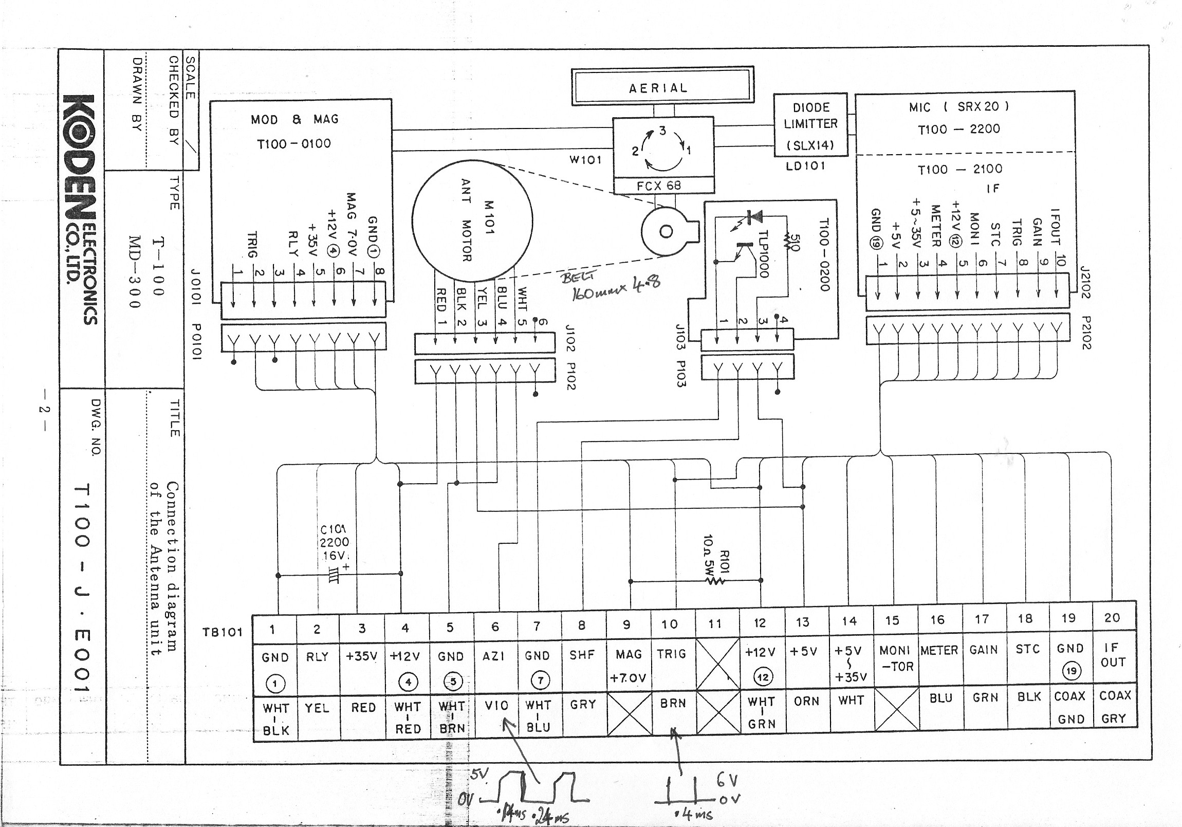

You might find this interesting reading as its similar to your description. I have this Radar & the workshop manual. Its a Koden 32Nm radar. If you want more info just ask. Im of to bed now as its getting late here.
How do they get the magnetron to transmit short bursts, I thought magnetrons take a few uS to start up, even with the heater pre warmed.
the filament winding on the transformer is isolated, and high voltage negative going pulses are applied to one side of the filament/cathode
, or as is shown in #3, through a pulse transformer.

most search radars use pulsed operation. speed radars use CW operation, and some specialized radars use FMCW. the radar in #3 is pulsed
Fascinating thanks, and even a schem.
Yes I've heard of sweep & doppler radar, the latter I made a speed trap out of from a Hb100 module.
This unit is a furuno, and its probably older, the motor is a Dc brush motor, positional feedback is from a weird 4 terminal pot (not a synchro) which probably generates sine * cosine waves to generate the circular motion on the Crt.
I wonder if the 820hz repitition rate is also to do with the distance scan from the centre to the edge of the screen & back.
I thought these would burn up a bit more than 1.3A, I spose the outgoing pulse being that short average power isnt that high.

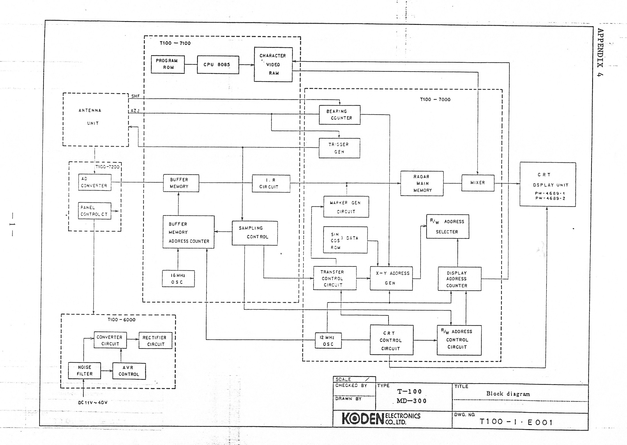

I think that "CIRCURATOR" in the first, block diagram is really a circulator which acts to switch (so to speak) the antenna between the transmitter and the receiver, although no switching actually takes place. The diode limiter in the receiver is used because circulators leak a lot and could otherwise damage the receiver when the Magnetron pulses.
I agree, presumably it's a similar device to that used in radio amateur 'relay' systems, where they transmit and receive simultaneously on a single aerial - although there is small frequency offest in that case.

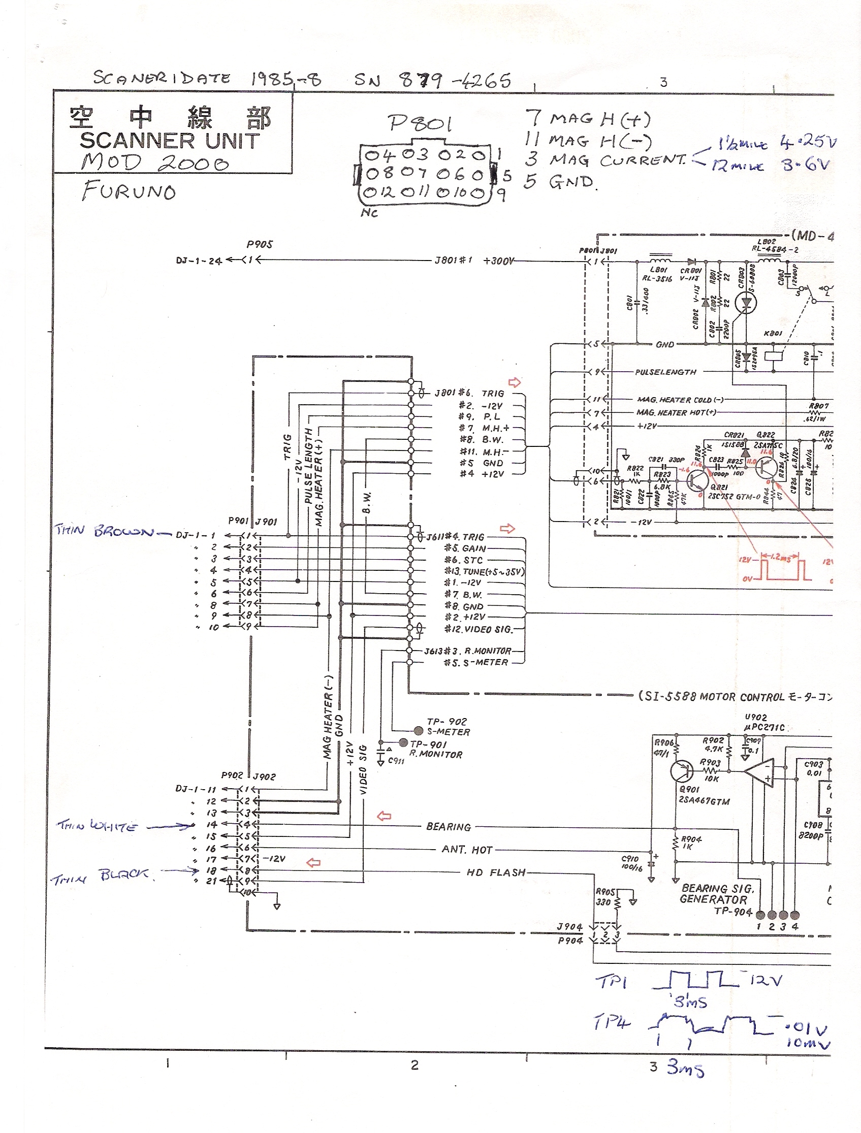

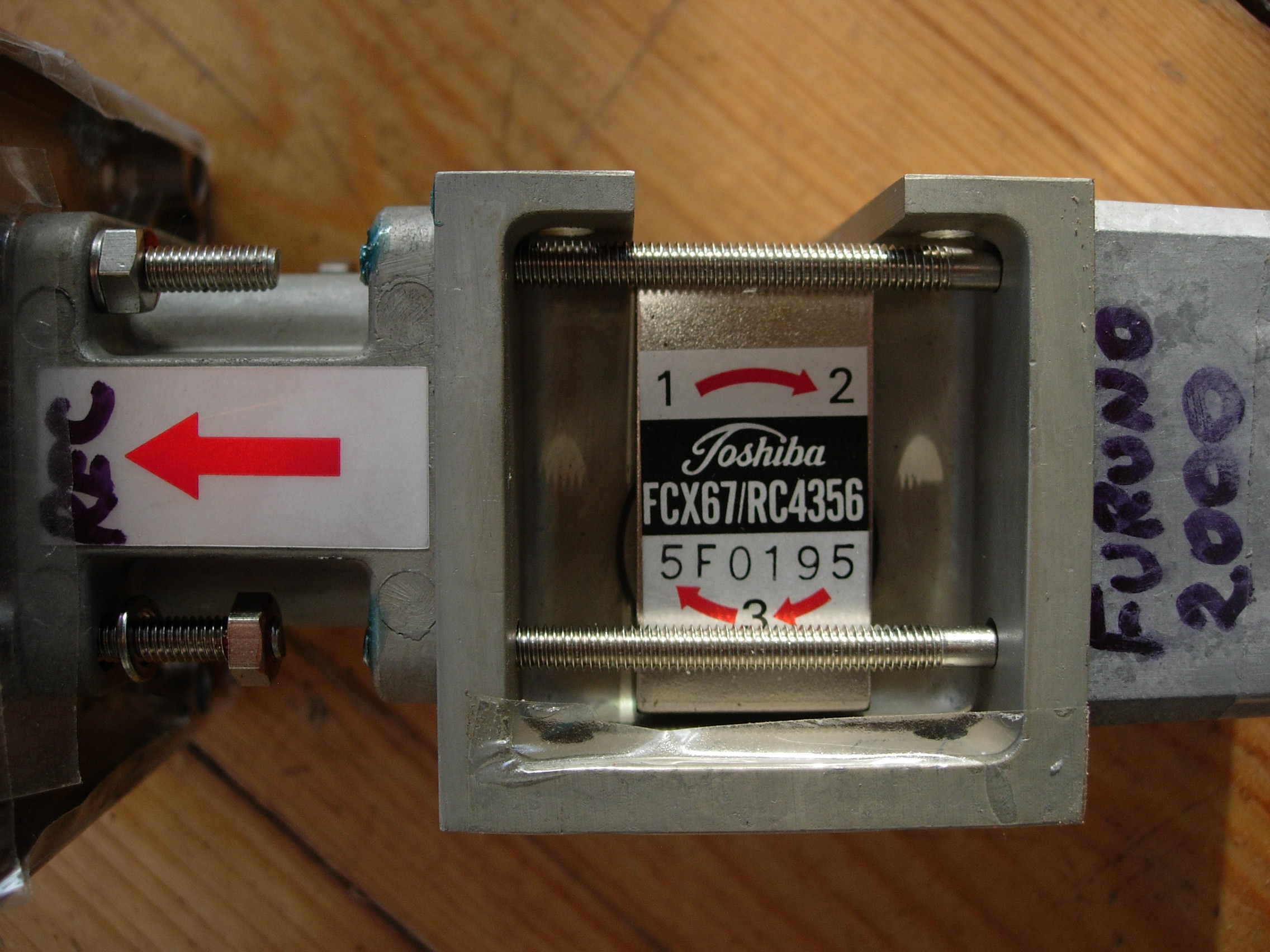

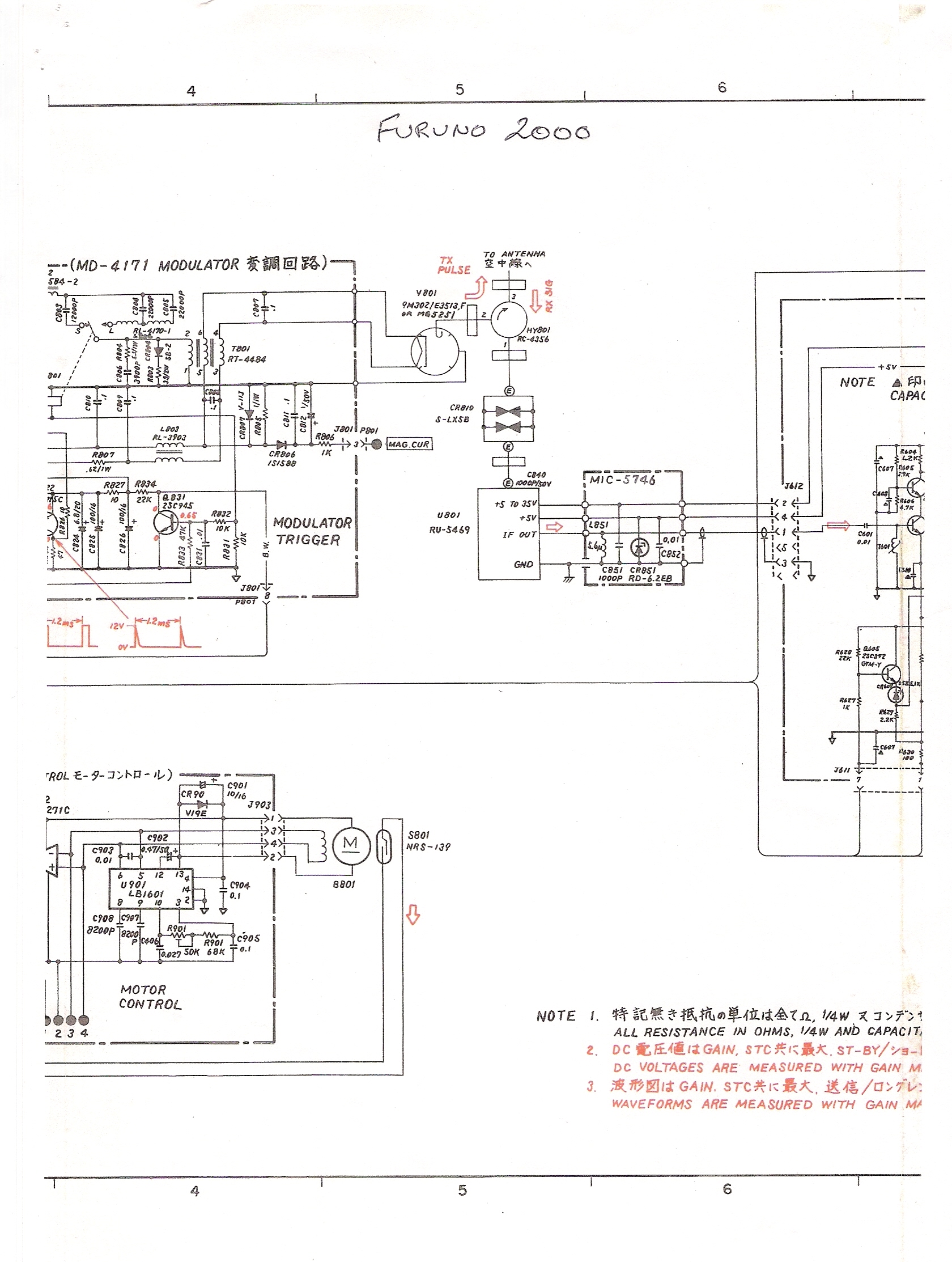

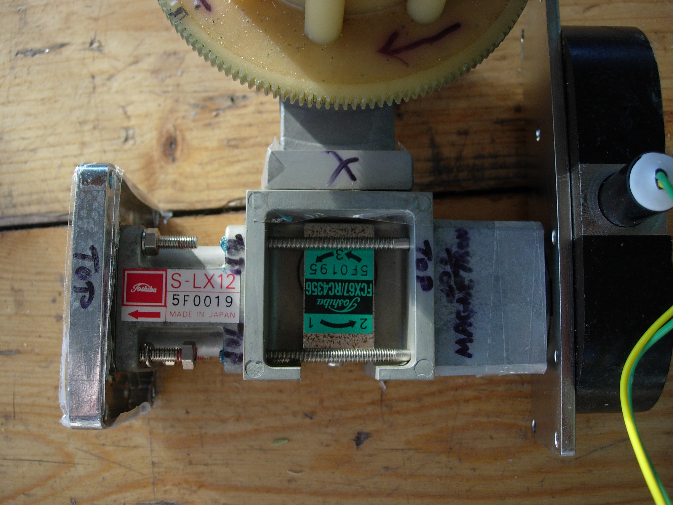

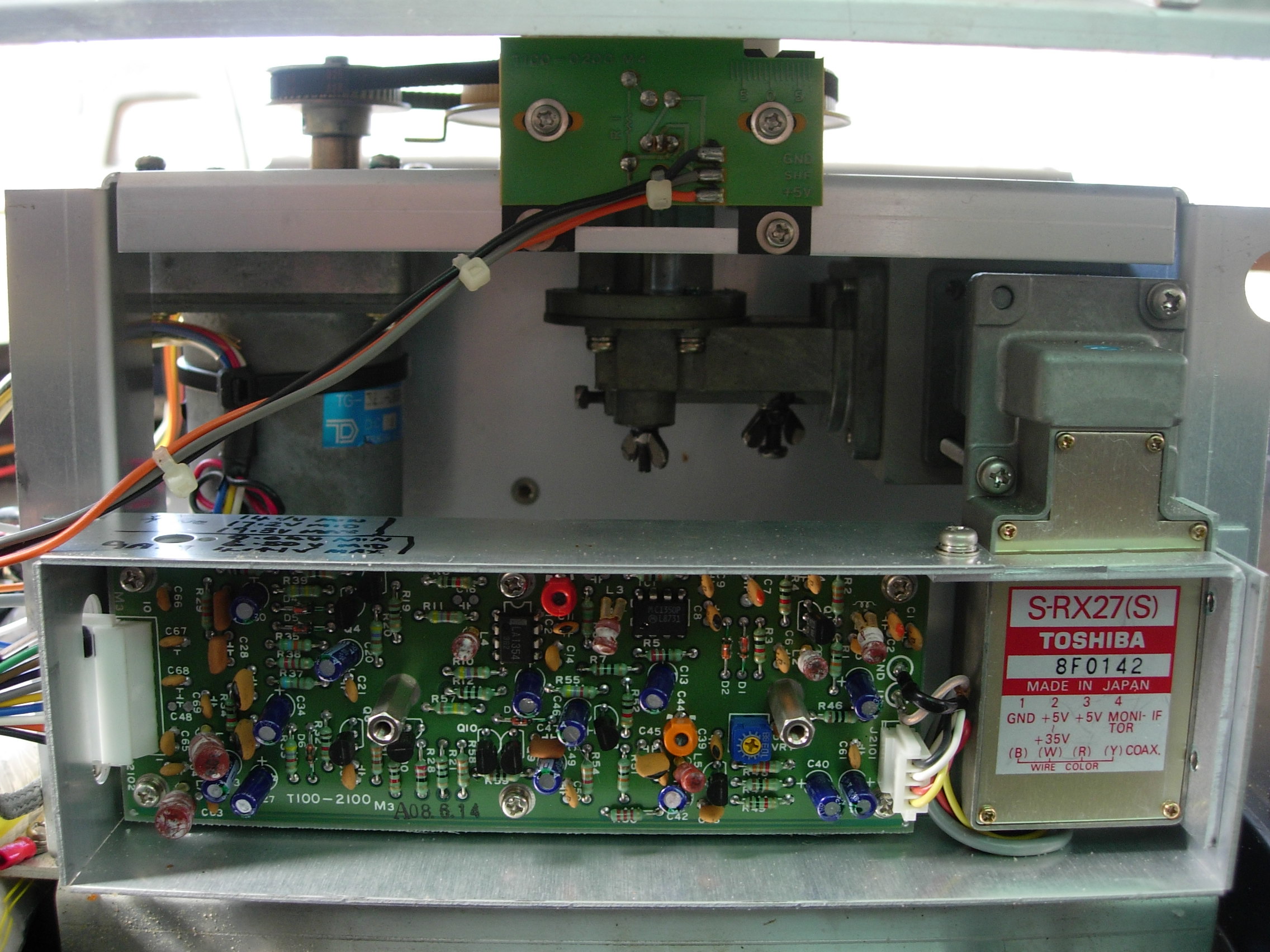

This is a Furuno radar from the late 80s, picture of the Circulator & antenna parts & the circuit of the transmitter stage. This units display was the older type that used a round display with rotating scan coils. The Koden above used a Raster type TV screen.
The antenna magnetron and the rx are all coupled with a waveguide, is the gizmo with the green label a directional coupling?
Rotating scan coil simplifies the deflection system as you'd only need one axis, mechanically though it would complicated and the slip rings probably were a source of trouble, I see the magnetron supply also uses a thyristor.
I didnt expect the position signal to be a voltage, I'dve thought they'd sync two stepper drivers clock signals.

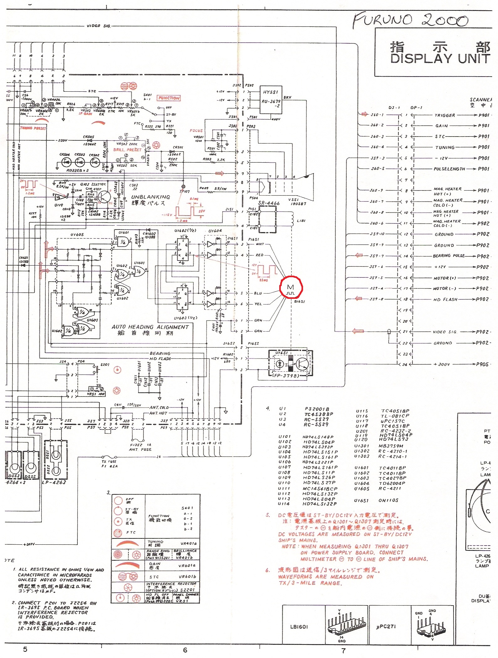

Yes the Green labeld object is the Circulator/ Direction coupling. I scraped the Furuno as the CRT was just about had it. The Kodan is still an operational unit. The red circle is the stepper motor that rotates the scan coils on the Furuno unit.
So it look like there are 2 stepper motor oscillators synced over the bearing pulse line.
Doesnt look very complex, 2 stepper osc's, magnetron and a rf amp.
I spose you need to add the current used by the display to the 1.5a of the scanner, which would probably be around 5a I was expecting.

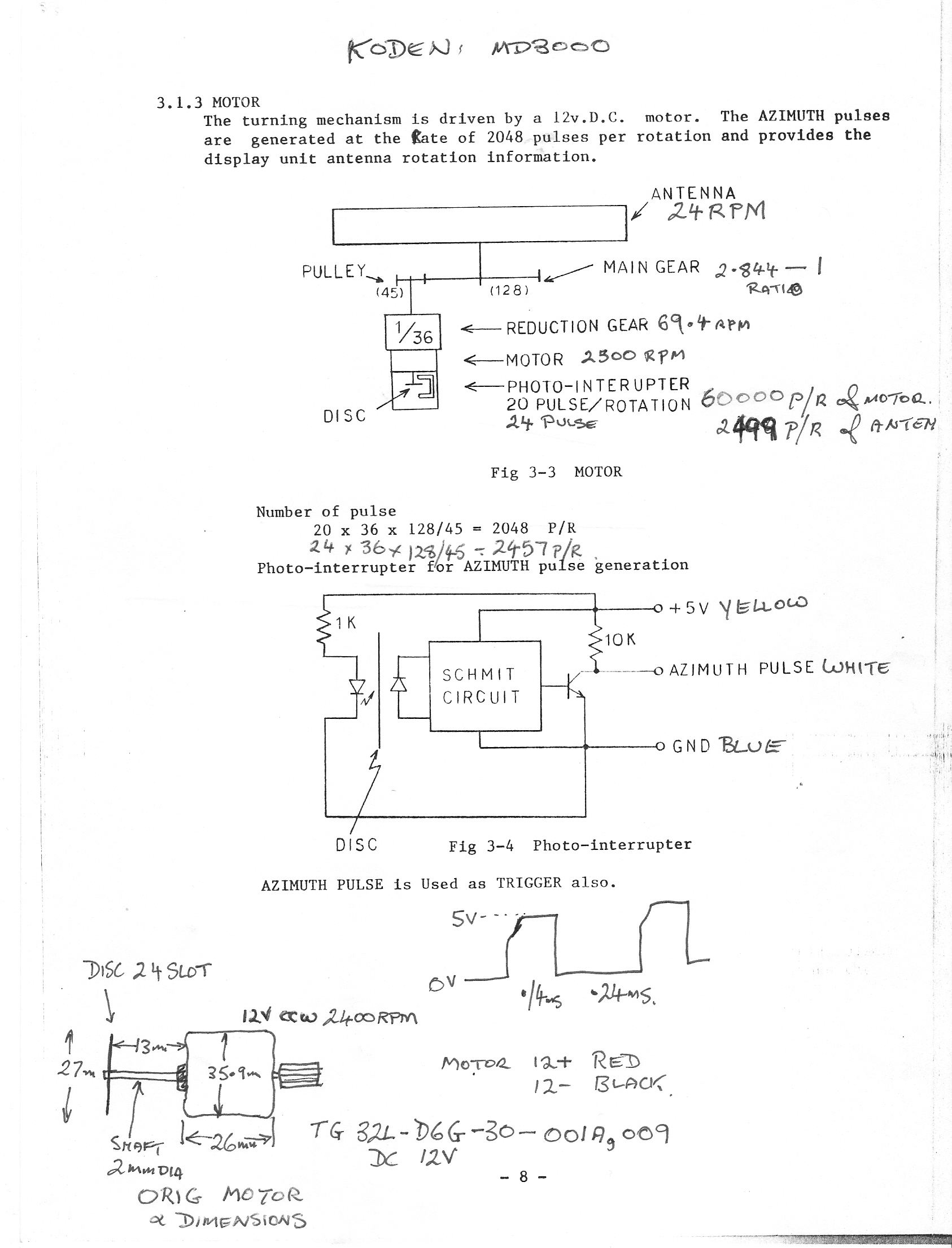

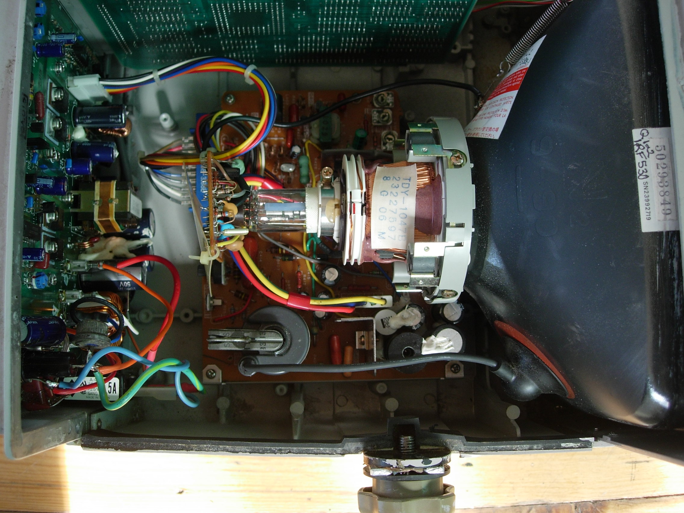

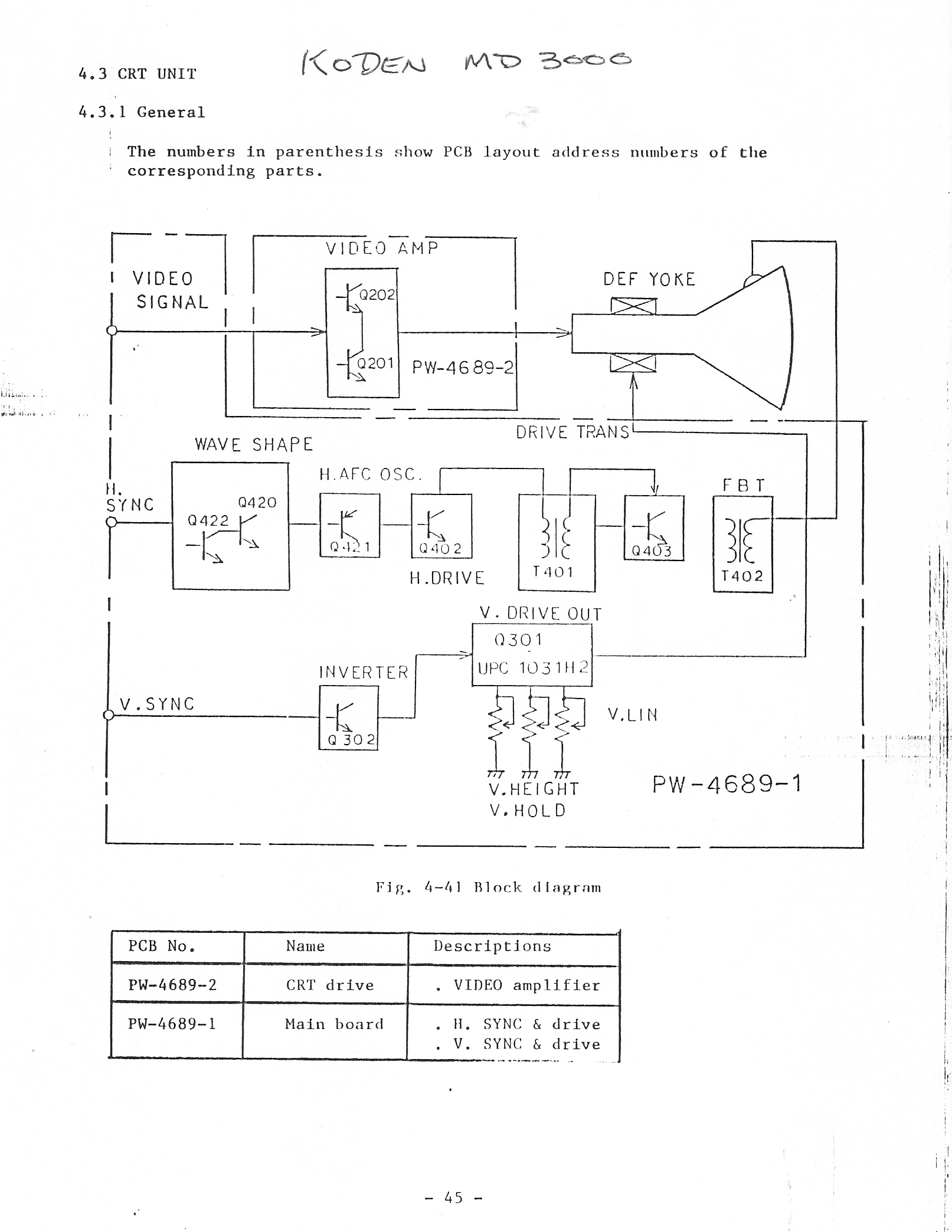

Your weather radar probably had a scanner that swept back & forth sideways in the nose of the aircraft. These are pictures of the Koden display & info on the antenna drive, which generated an Azmth signal in the drive motor to sync the antenna to the display.

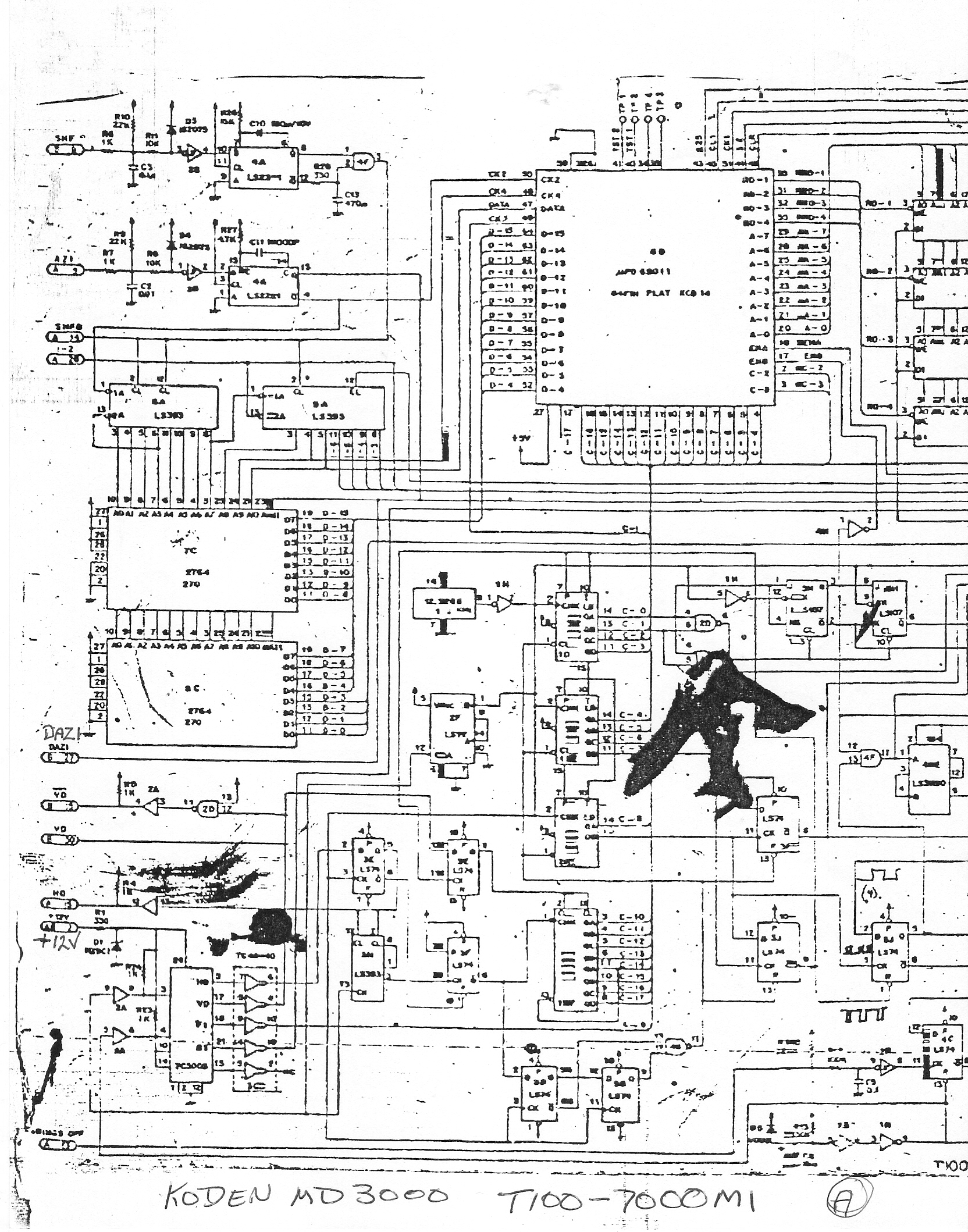

8085 processor, not seen or heard of one of those for a while, didnt it come as a microcontroller version too.
The video board looks like it straight out of a monitor, maybe it was.

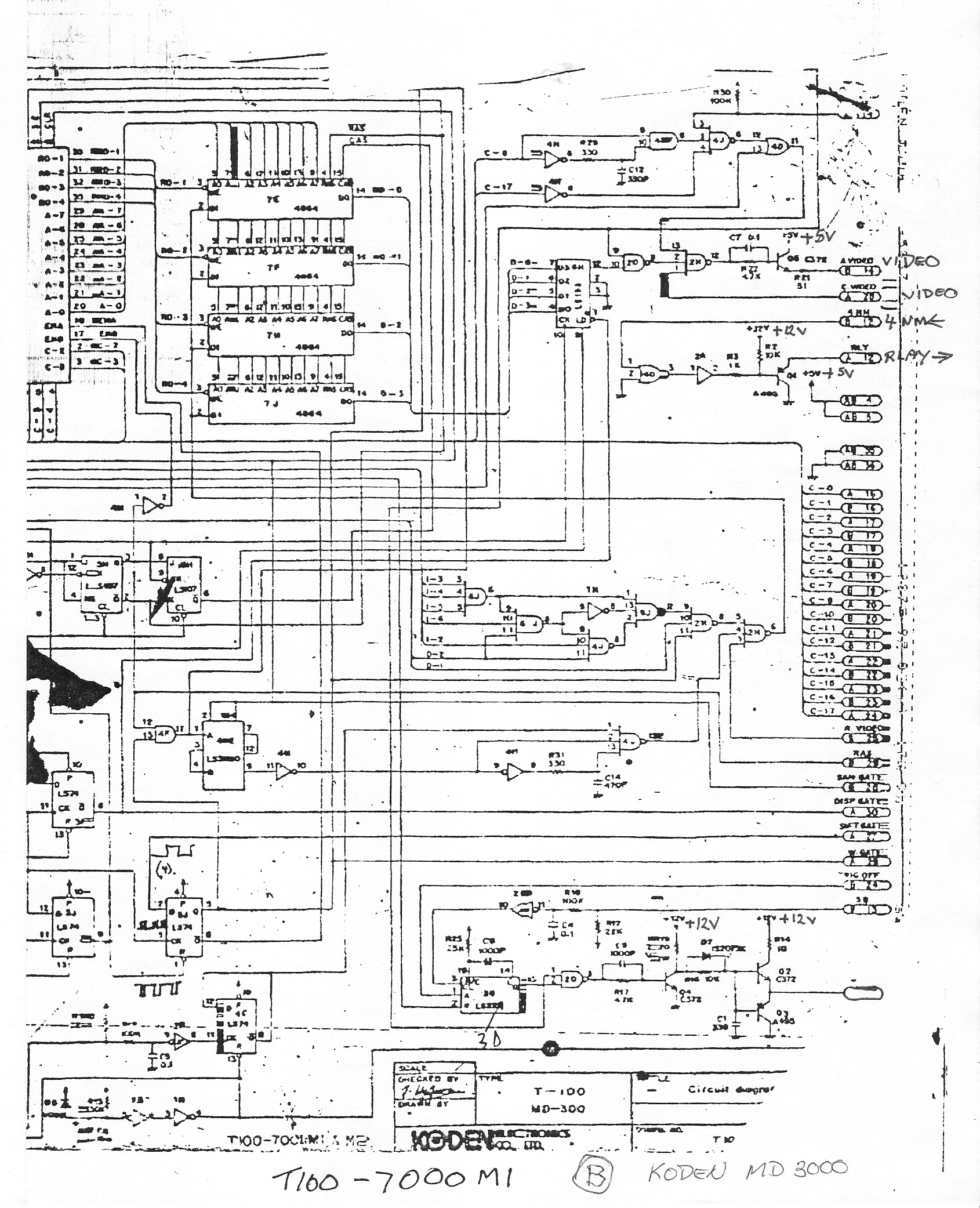

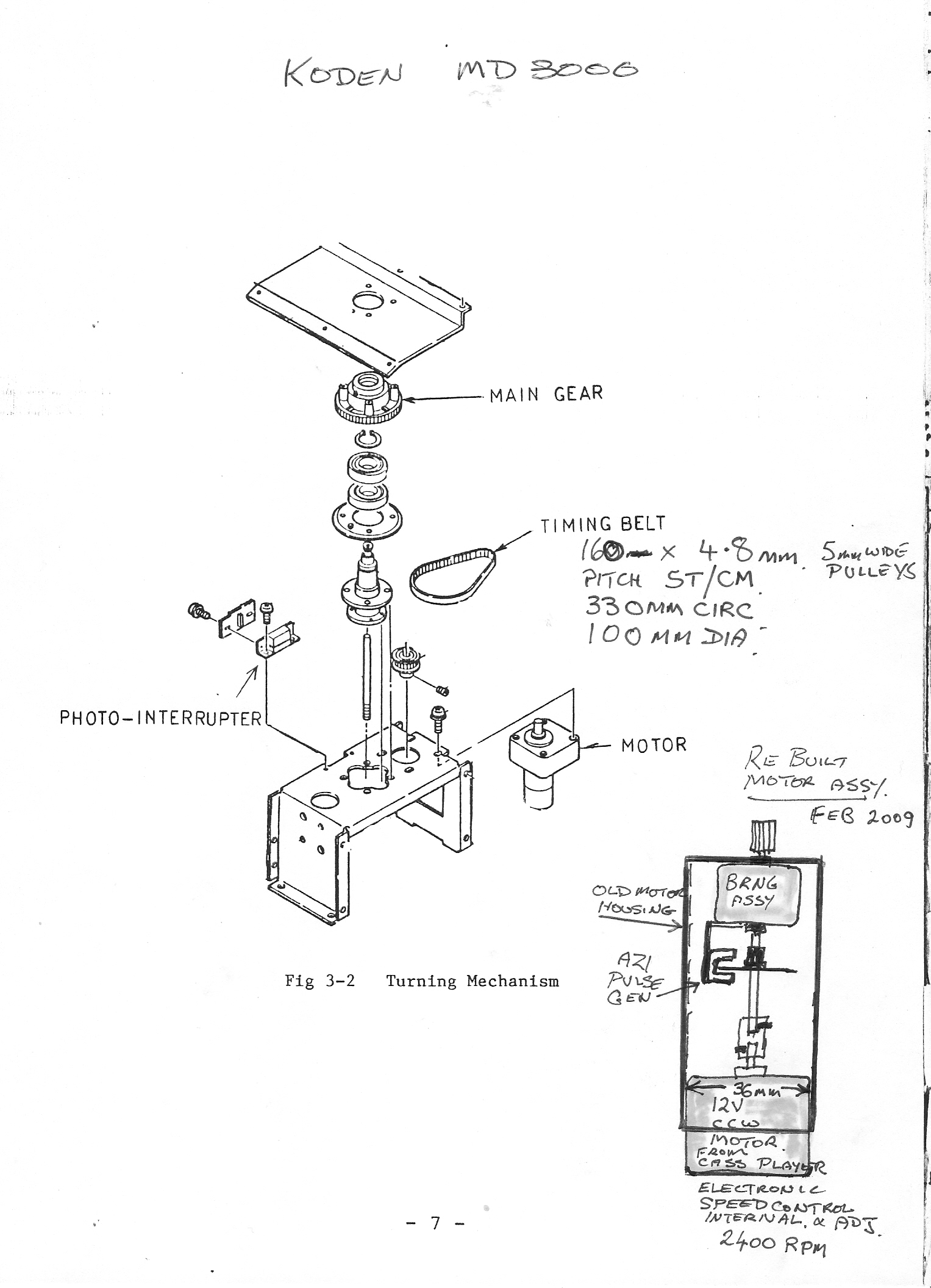

This is the block diagram of the display & the circuit of the Processor board (best I could get of the circuit). generaly these older radars were pretty reliable, apart fom Magnetrons wearing out & antenna drive motors. The drive motor was faulty on my Koden unit & I had to think out of the square to repair it as they are not available. Yes the display is realy just a basic monitor.
At some point I've used all those logic devices, including 2764 rom's, but that was a long time ago.

I gathered you'd had trouble with the motor drive from the sketch + dimensions hand drawn on the manual.

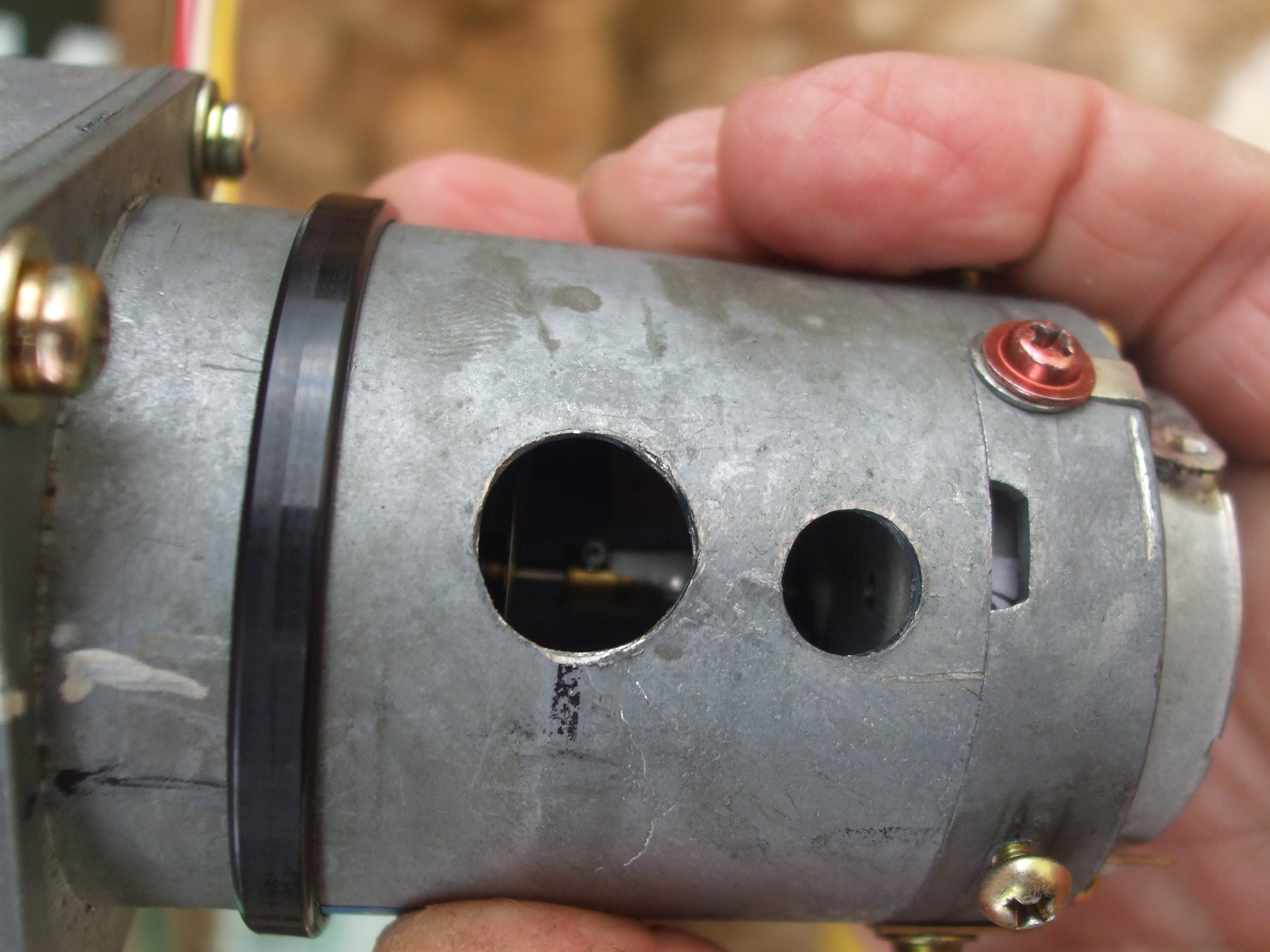

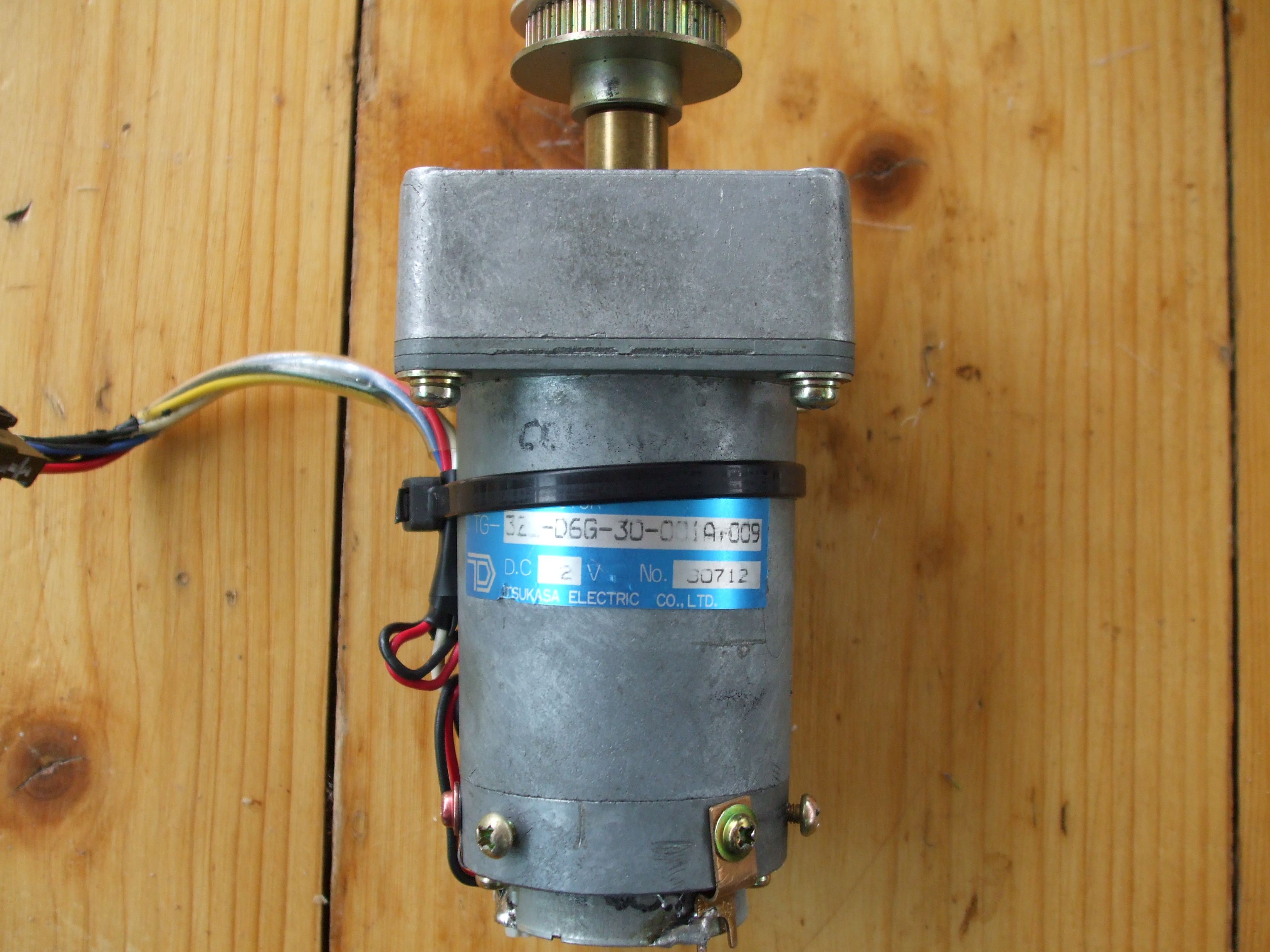

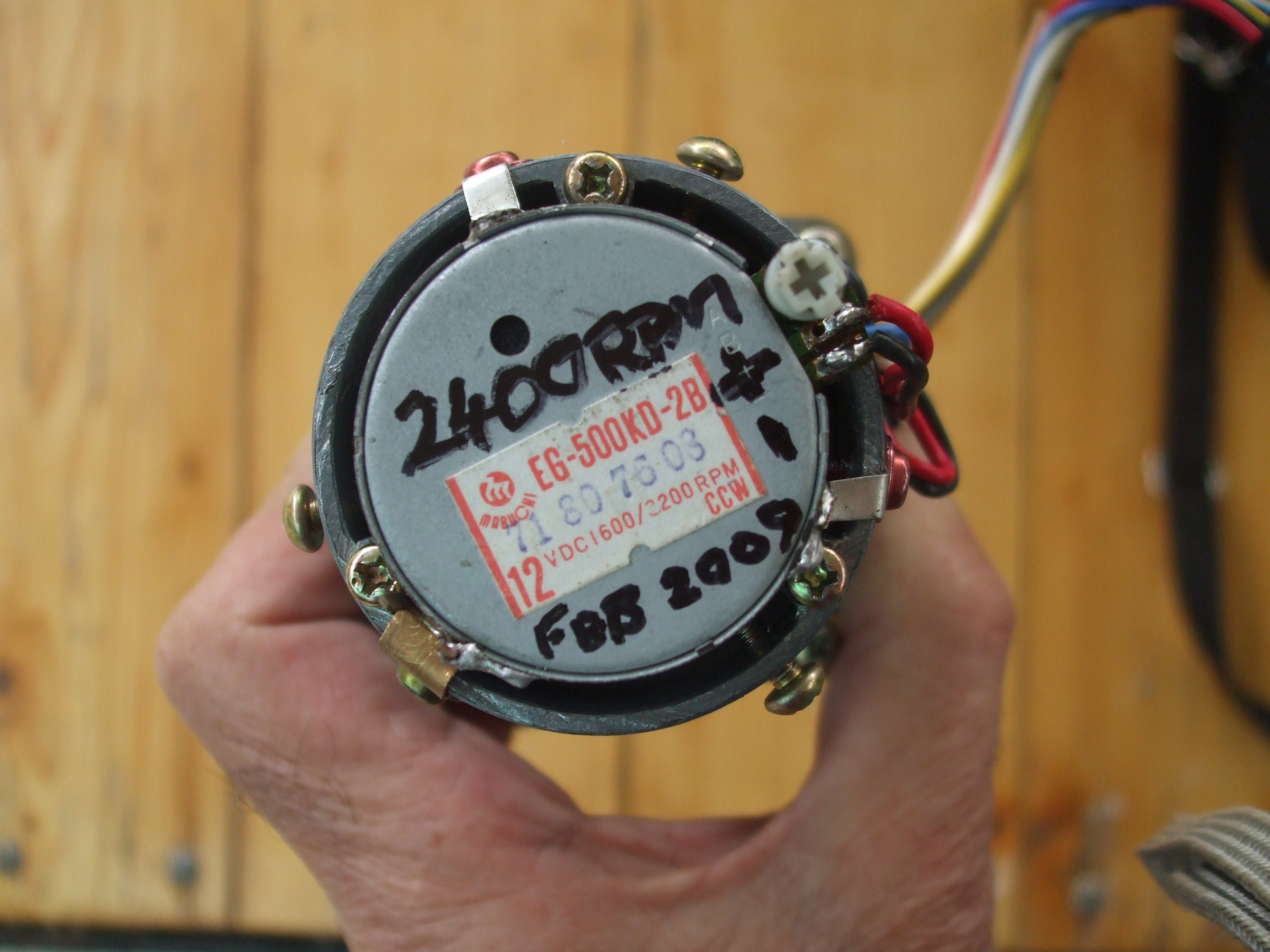

Heres some pictures of the rebuild of the motor. The original motor inside the housing I dismantled & removed the armature from the shaft. Then I shortened the housing to just use it as a bearing assembly, & shift the AZI pulse generator further up the shaft. The brass coupling to join the new motor was salvaged from a very old VCR. The replacement motor was a new adjustable speed cassete motor cost $12. This repair has been quite effective & quite cheap.

Thats just the kinda thing I'd do, make it have it.
Question is would you trust it at sea, I'd be Ok if I ran it for a couple of days non stop first.
The thing with steppers is that with no brushes they last longer, Bldc are the same.
