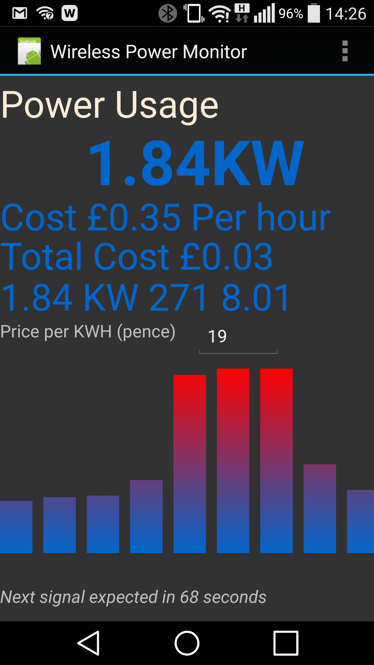

Ian: Haha the lazy sods! Tell the boys that I envy them!.. You might be interested in the App I'm making.. I finally got that android application working! :happy:
