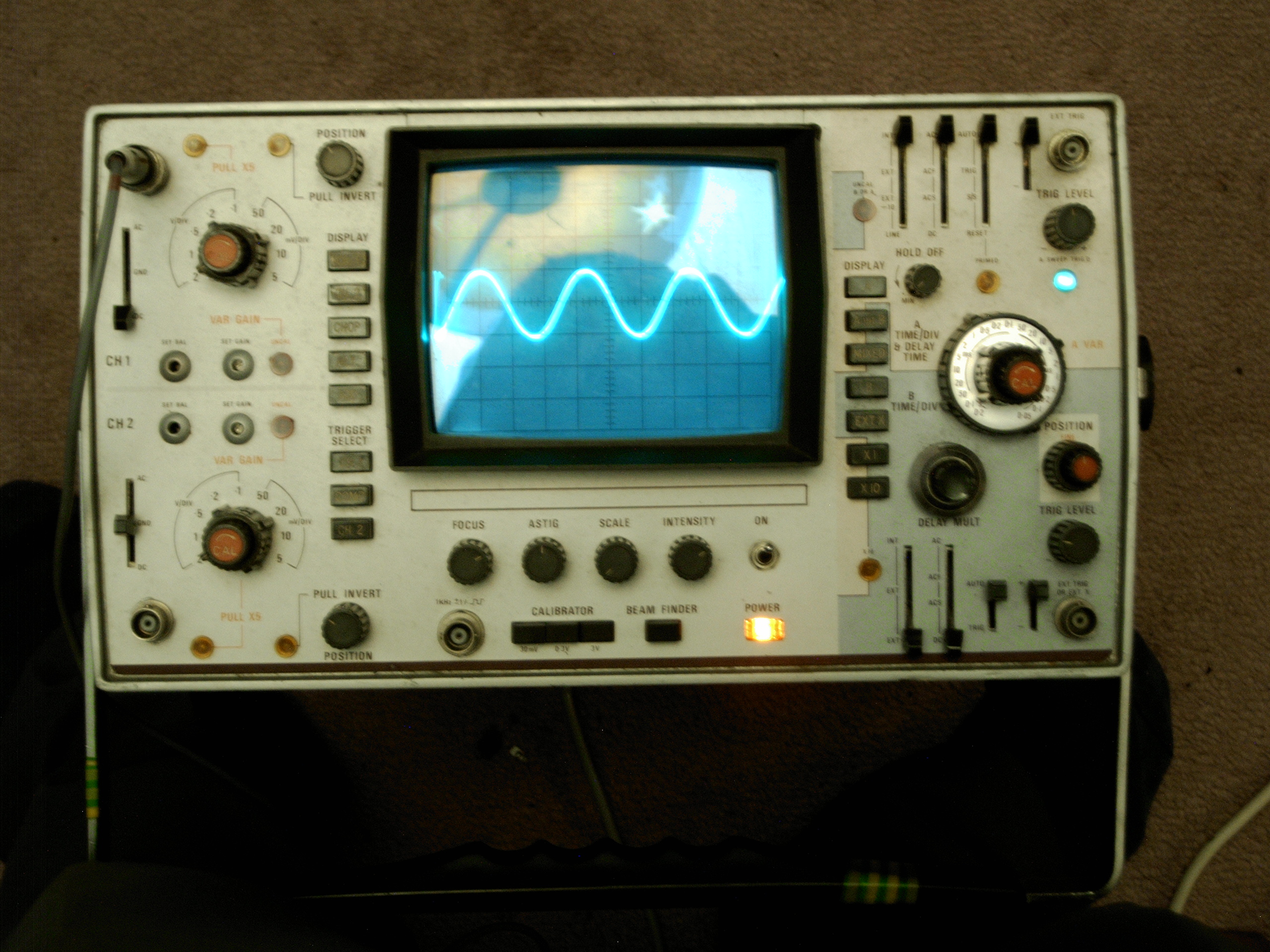

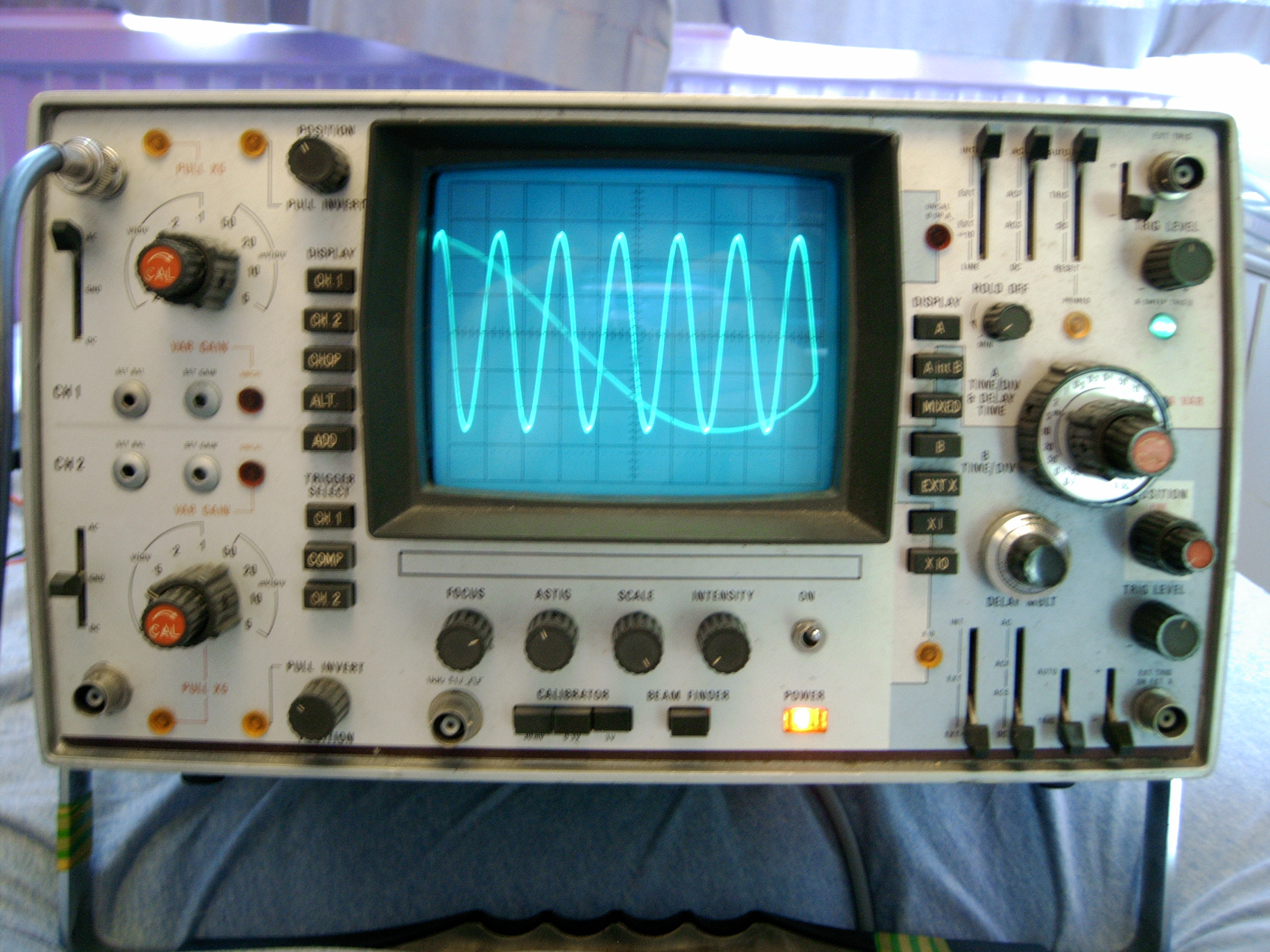

Here's a picture, sorry if it's not very good.
One thing I've noticed is that the beam occasionally jitters up and down randomly. I don't know if this is a fault with the scope, noise or just vibration.
Apart from that, it works perfectly.

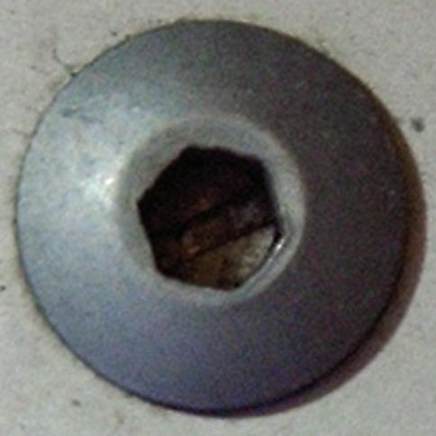

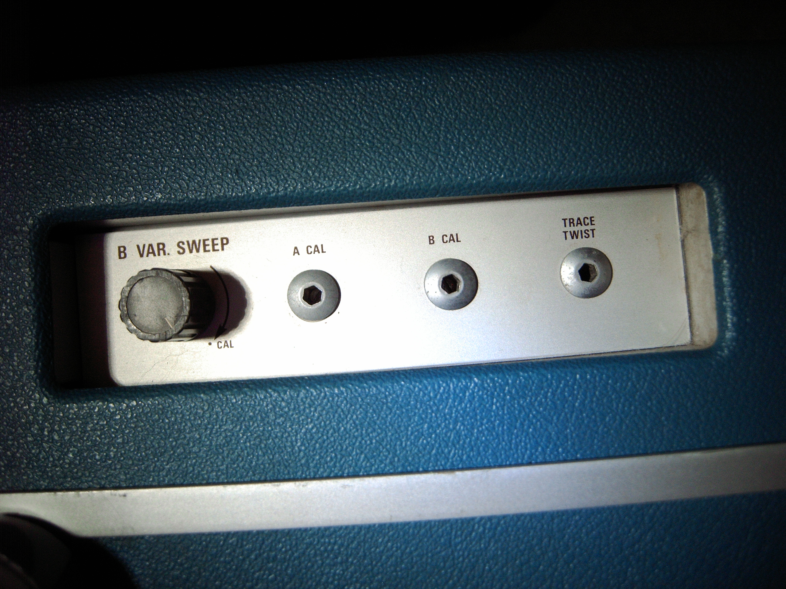

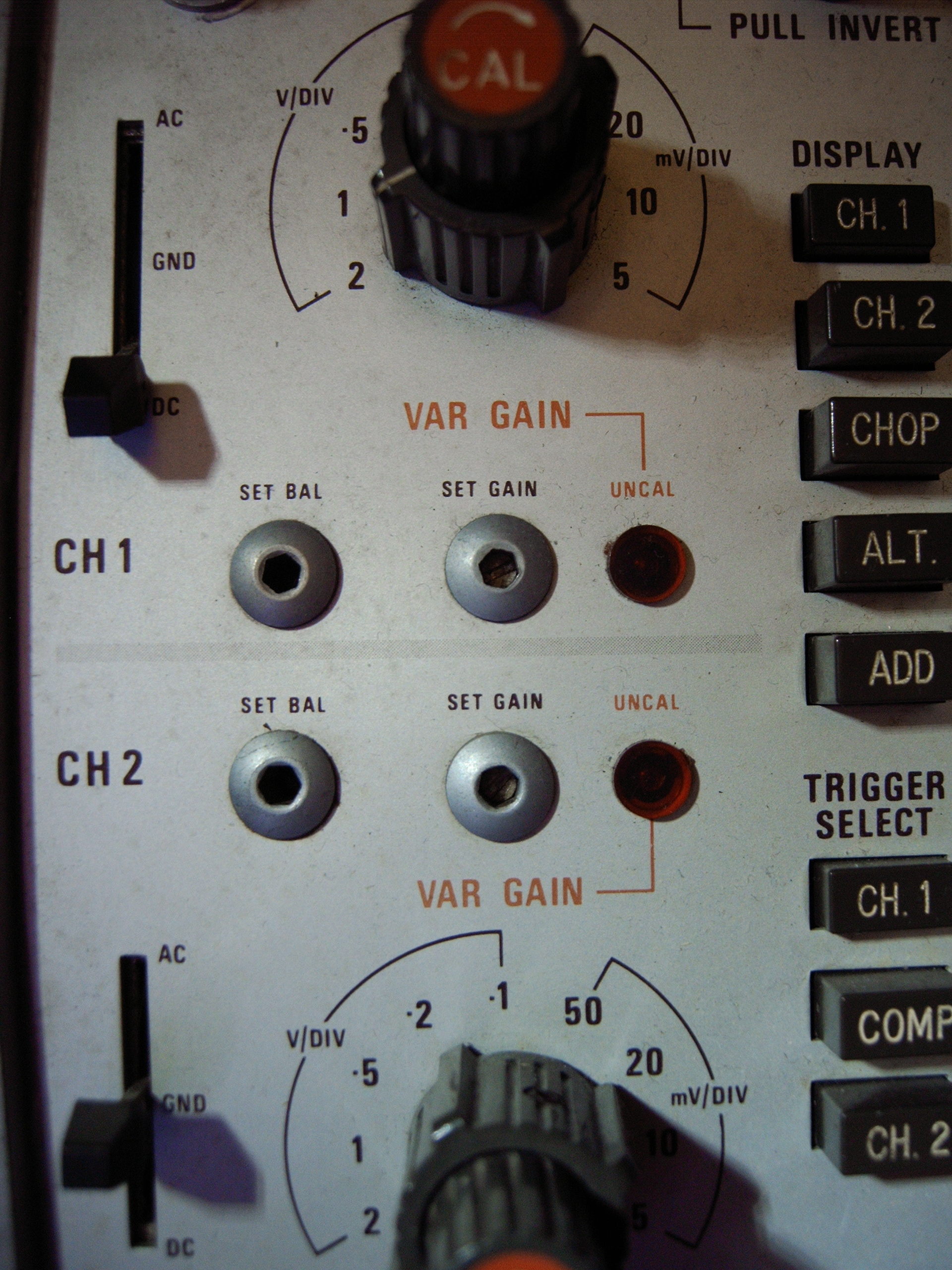

I've discovered that this scope is out of calibration.
There are some calibration controls on the front and side panels.
I take it that I need to remove the hex head screws before I adjust the pots underneath or are the hex heads connected directly to the pots?
What does A CAL and B CAL mean?
Is that the timebase calibration an why A and B?

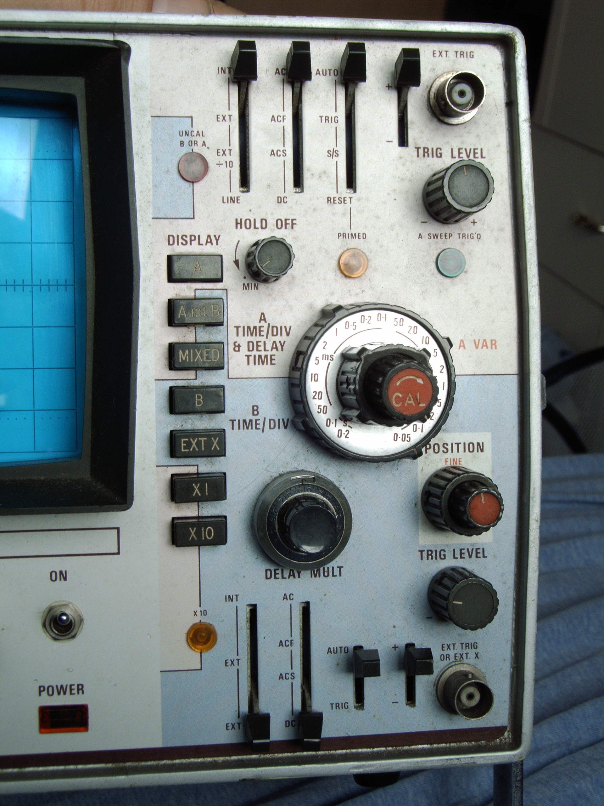

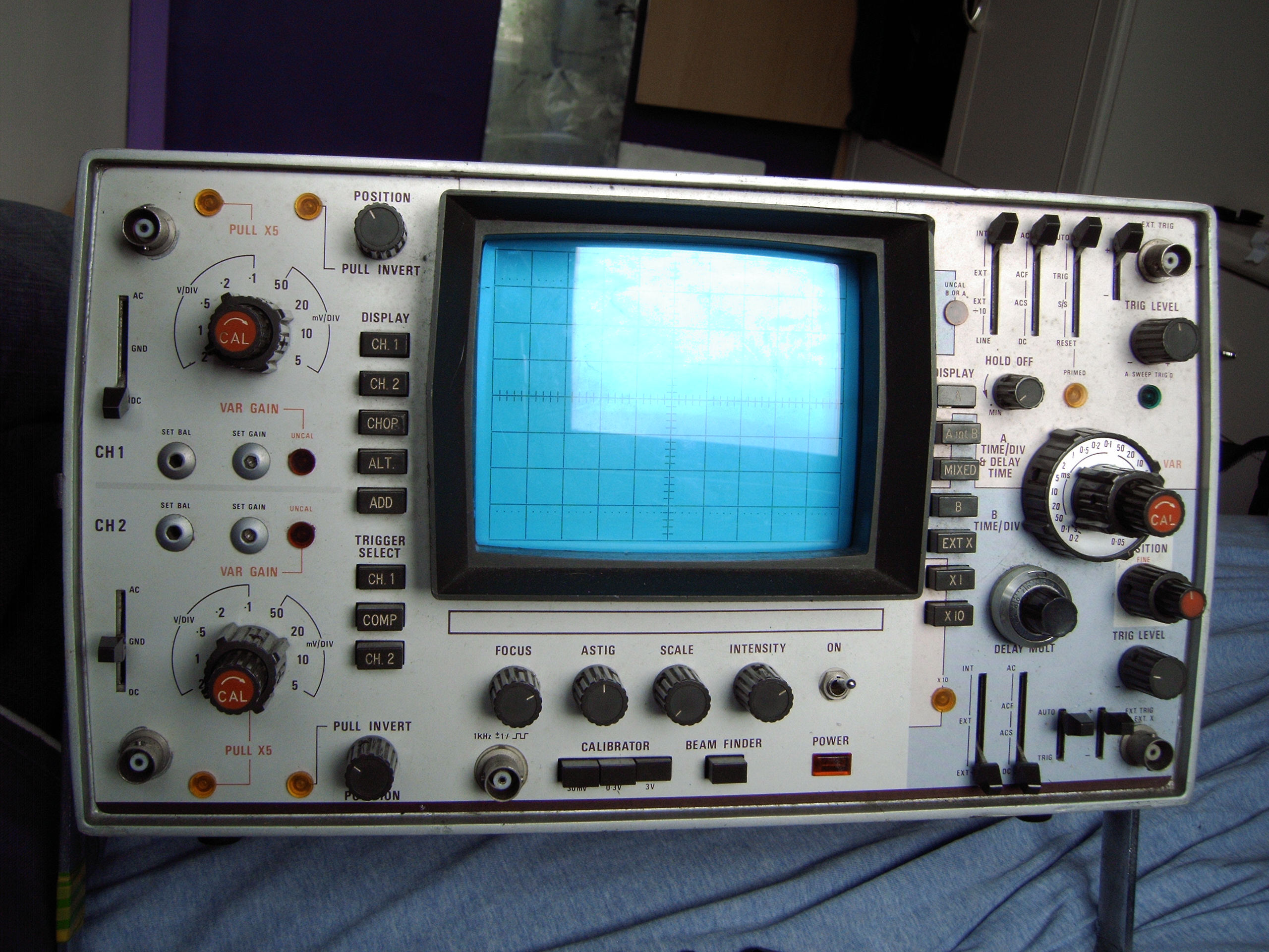

Here are some better pictures.
I've managed to calibrate the gain of channel 1 and 2 and the timebase.
I worked out that A is the timebase.
What's B for?
What does ACF and ACS mean?

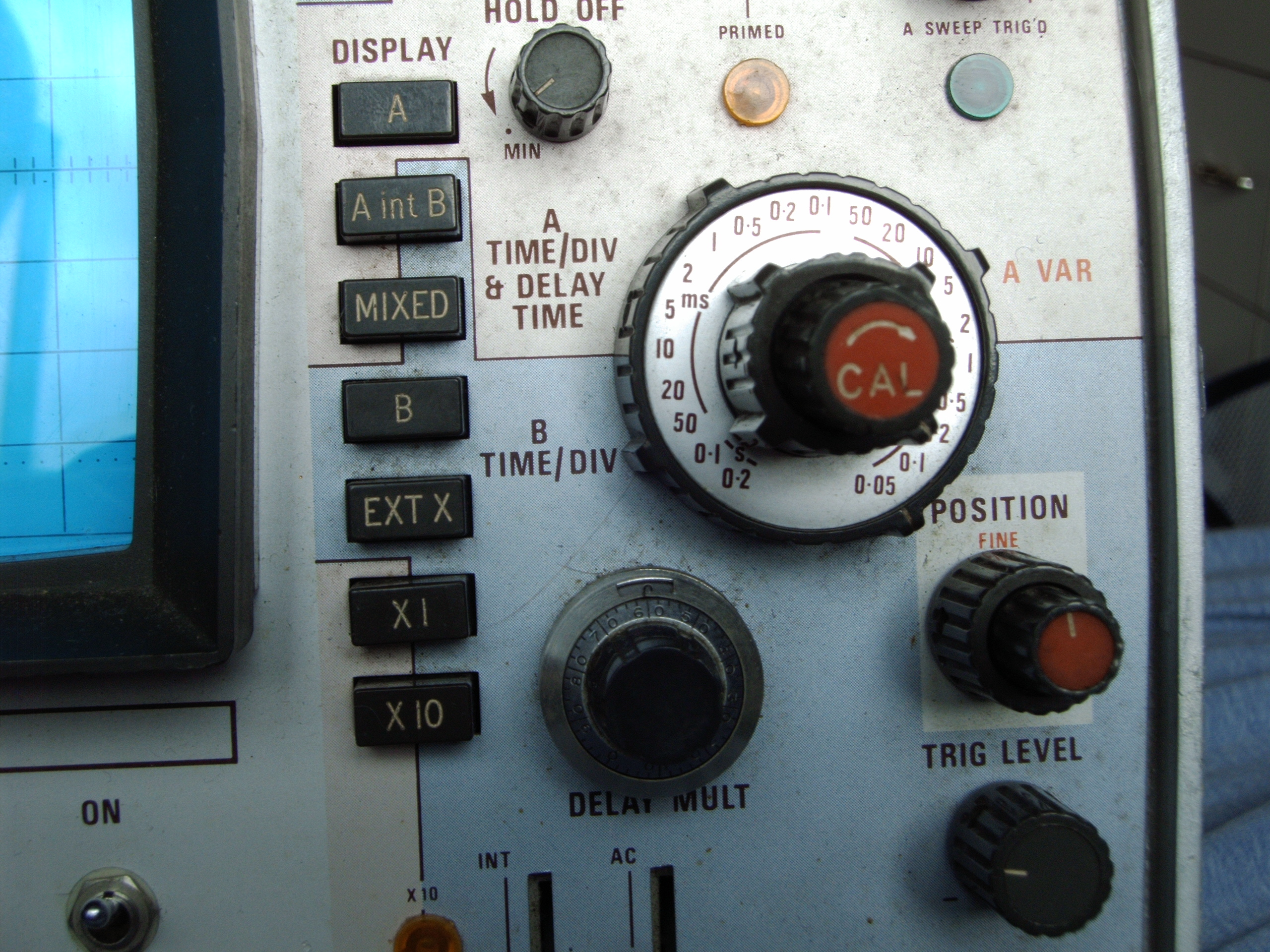

Only the main timebase.
What's B for?
The second timebase, it's a dual timebase scope.
AC-Fast and AC-Slow?.

I've noticed another setting: S/S do you know what it does?
How would I used the dual timebase function?
I haven't used a scope that does that.
Presumably Single Scan?.
The dual timebase allows you to zoom in on part of the waveform you're examining, so you have one trace displaying the full waveform, and the other displaying a zoomed in portion of that waveform.

Single scan does what it says on the tin, after it's triggered the scope will scan once and won't trigger again until the reset function is activated.
I still don't know what AC-Fast and AC-Slow means; is it different rise time of cut-off frequencies?

That's correct - but do you know why it's there?.
It's filtering on the sync signal - if you're trying to sync a video signal you have a low frequency (frame) and a high frequency (line) - you use this to sync either high or low.

No, it seems a little pointless as it isn't a storage scope, the scope if triggered, you see one scan which normally over in the blink of an eye.
It's for taking a photograph of the screen - you use a special camera that locks over the front of the tube, open it's shutter, then do the single sweep to expose the film.

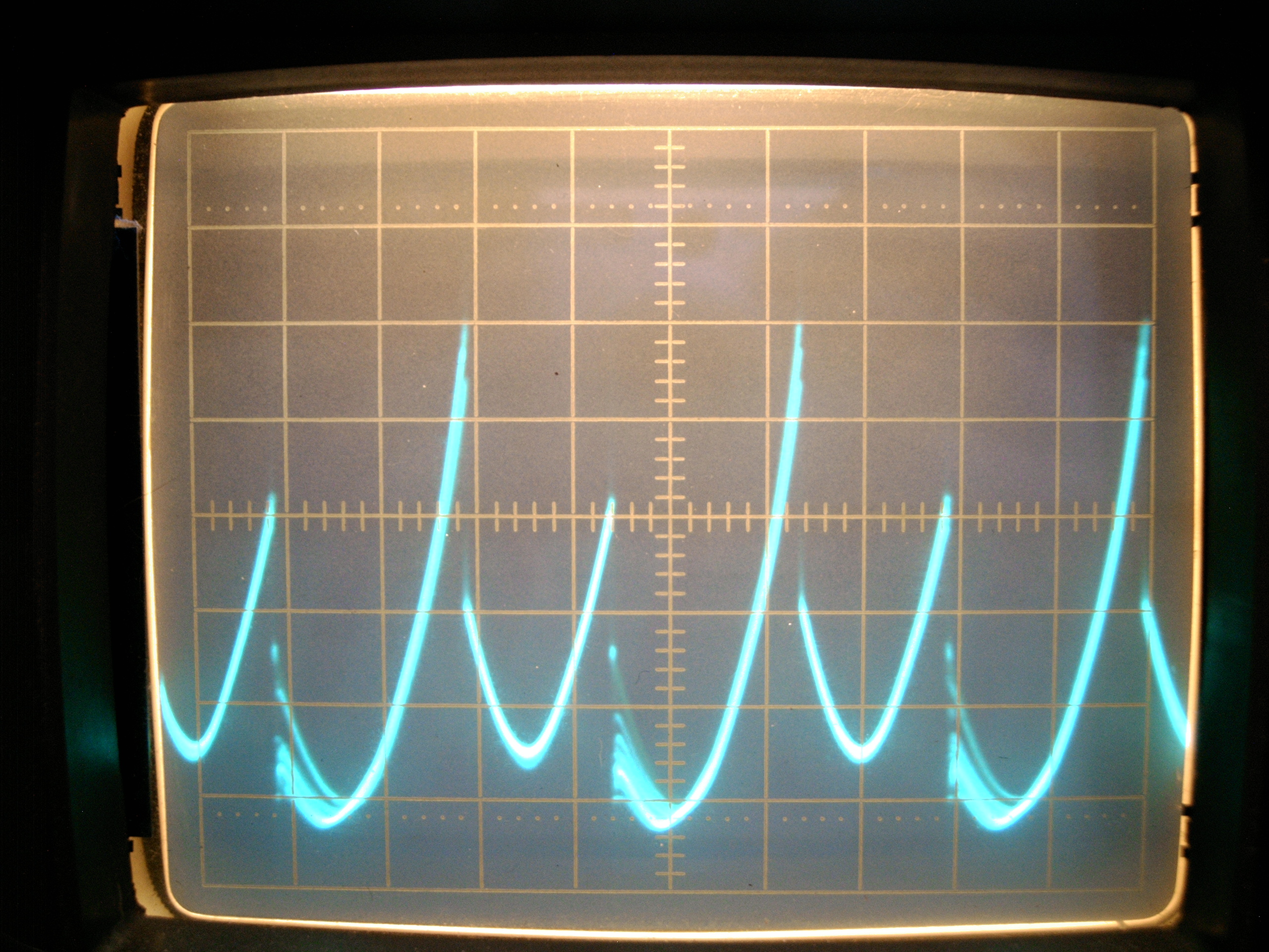

I've noticed another thing: on some settings I can see another waveform of a lower frequency superimposed on the main one. This is more noticeable at lower intensity and faster timebase settings.
Is it the retrace?
I've not noticed this with other 'scopes, many of them with a lower bandwidth and poorer specification.
Is there away to eliminate this?
Sometimes I need to use lower intensity settings so I can photograph it with my digital camera so just turning the brightness up is not the answer.
