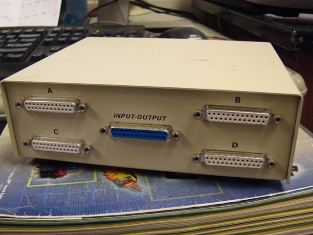

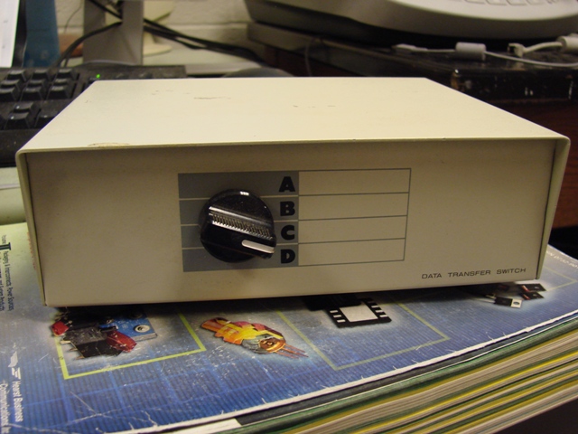

I have an A/B/C/D DB-25 switch box you can have. For a while they were being thrown out right and left. I used many for nice project boxes.
Ken
