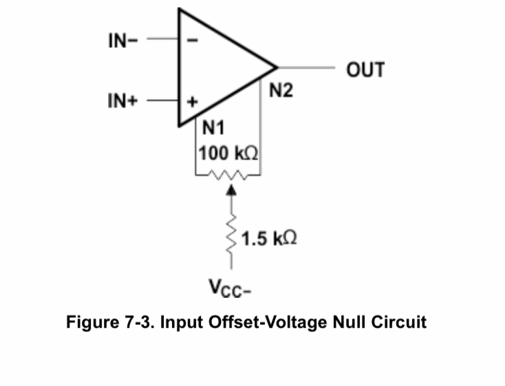

I eliminated the boost converter noise but the high gain noise is pretty audible so I looked for a op amp with lower noise. Only one I could find was NE5534, it has same pinouts but it didn't really worked when I swapped it with TL071. I bought it from a respectable seller so I don't thing it is a fake one, why do you thing it didn't worked. It only creates noise which increases when I increase the gain but no actual sound.
Ok I found out the high frequency noise was coming from my sound card when its sensitivity is maxed. So after setting the computer setting to 90/100 from 100/100 and increasing the gain from the preamplifier it sounds much better. Replacing the op amp was unnecessary but I still wonder why 5534 didn't work.
Use the offset pins. See image below from TI datasheet.
The 6v supply means you have a maximum output voltage swing of +/-1.75v (3.5v)
I use it with 15V with a boost converter. I saw the NE5534 as a direct replacement in a forum, I have no intensions of changing the circuit. Since the noise dropped a lot after the tweak I done with the computer settings I don't need to change the op amp. But if there is a direct replacement op amp with better specs I might consider it.
OPA134 single, OPA2134 dual and OPA4134 quad opamps are excellent for audio and their minimum supply is 5V.
