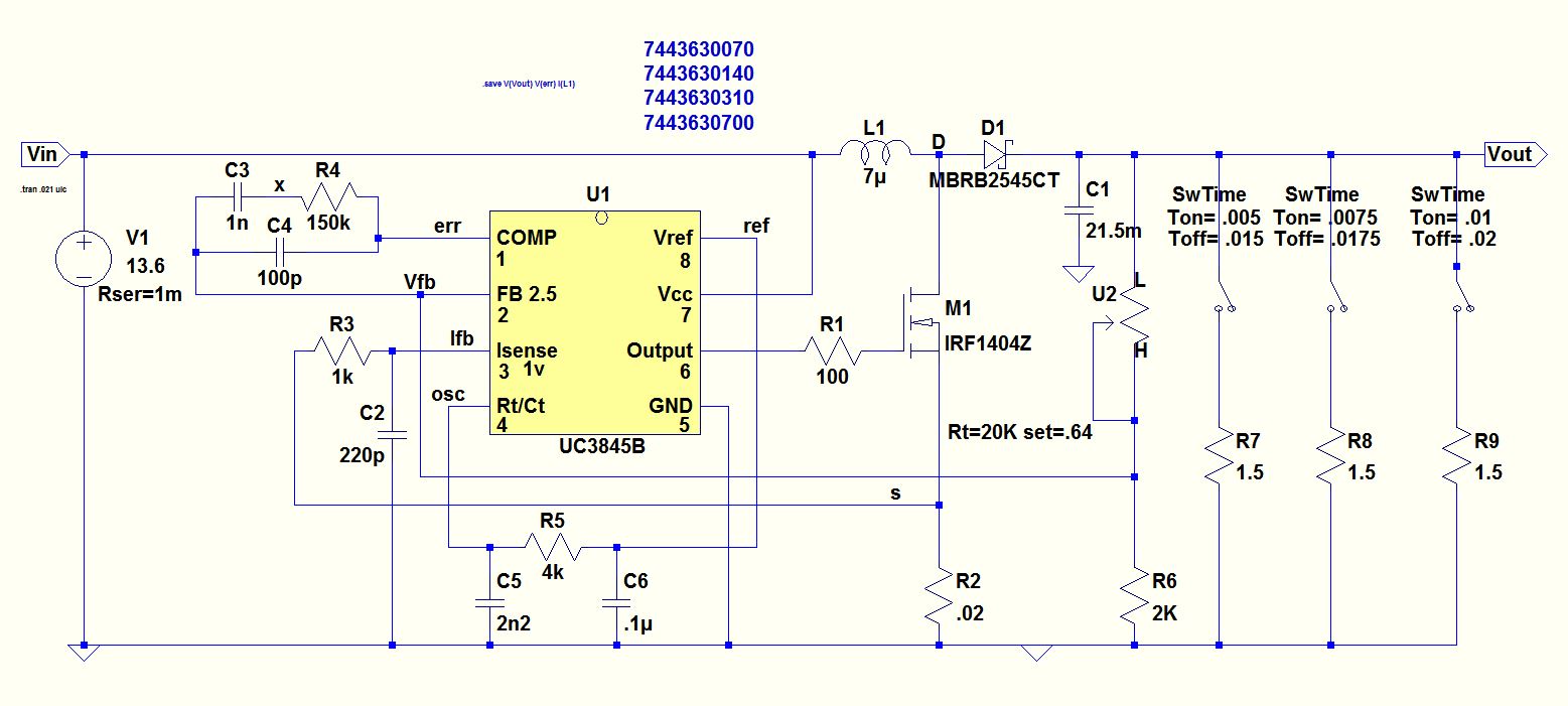

For a new project I want to control a 8.4v dc source to output 1-~6v 50a or more to a load that, at its minimum, will be ~.04 ohms..
I've got a basic buck convertor diagram that I think will work but I'm grossly lacking in specifics when it comes to actually building it. If I'm honest there's very little chance I could work out any of this myself :( .. but I'm great at following directions :);)
I've got a 50mm×80mm×10mm footprint to fit this into, I could vary that a little but that'd be the ideal size.
50a or more would require multiple capacitors I guess? what do I need there?
The transistor and diode, where do I find 50+a examples of those?
The transistor needs a pwm square wave driver circuit, and just so I've got this right, it being adjustable via pot is how the voltage is regulated right?
And the last specific I'm missing.. how the hell do I work out the inductor :nailbiting:
I guess it'll need some pretty thick copper wire to cope with the load, (probably the only thing I can work out), but I've no idea of how long the wire should be, the diamiter of the coil, the composition of the core it wraps around or how I'd aquire/fabricate said core.

Technically doable but not realistically DIY level doable (unless you are extremely well versed and production capable in SMPS design) given the small space constraints. :(

The circuit in #1 is the right topology, but it is only conceptual - it's a long way from being a complete circuit. I tend to agree with TCM - the space constraint is going to make and already challenging circuit very difficult indeed.

Start with a 1 amp converter and work your way up. You should probably get that working perfectly before going to the 50 amp'er.
A 50 amp buck will require an inductor that can handle a peak current greater than that. The diode has to handle more than 50 amps, so does the transistor.
The peak current is of prime interest. That determines what kind of caps you need too. They have to have a rating that can handle the expected RMS current.
The inductor size determins the peak current and thus also plays a part with the cap in the output ripple voltage. The ripply voltage is often a target concern also because you dont want too much ripple in most cases, unless you are doing something that dosent matter as much like a battery charger.
So you have low ESR inductor, low ESR caps and can handle the expected RMS current, a fast diode like a Schottkey that can handle maybe 25 percent more current than the rated output (that brings it up to over 60 amps), transistor has to handle the peak current.
If there is no slow start than you have to make sure the transistor can handle the initial surge current which might make it's way up pretty high, which means you should have a slow start mechanism also. Without that even a 100 amp transistor could blow out, although it does depend on some other things too like the input source impedance, which we dont know what it is yet.
So your main concerns are in terms of voltage and current ratings, and you have to know what the peak current is which means you have to calculate that. A typical method is to assume a 50 percent duty cycle and go from there.

Mr Al's right a 50a inverter isnt a noob project, start by building a couple of smaller ones.
Take it from someone who's built and blown up plenty of prototypes, inverters are not that easy.

Maybe looking into the parallel connection of several 10 amp buck's would not be a bad idea as someone suggested already.
For what it is worth, i was looking into building a buck circuit that could do i think it was 30 amps and i found that the inductor would be too expensive and for my app i could not use parallel run of the mill bucks because i was going to have something like a 120vdc input buss with only 12v output.

As load currents get higher, it becomes impractical to do buck conversion in a single path, so multiple path, or phases, are typically used. Here is an ap note that talks about it. https://www.ti.com/lit/an/slyt449/slyt449.pdf
One common instance of a multiphase buck converter is for the CPU in your computer. It will probably at least four phases creating the over 100 Amps at ~1.2 Volts that the CPU is running on.
There are multiphase PWM controllers, but they tend to be application specific, such as for powering a CPU that actually communicate with the CPU and adjust it's output to what the CPU wants.
You may be able to find a multiphase PWM controller that fits your needs. But if not, you can do the same by choosing a PWM controller that supports clock synchronizing. Don't confuse that with synchronous rectification. You'll want that too, but that's a different discussion.
Of course, you can just run a few independent buck converters in parallel. But you get better overall performance in a smaller system package if it's all in sync.
