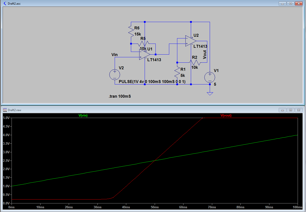

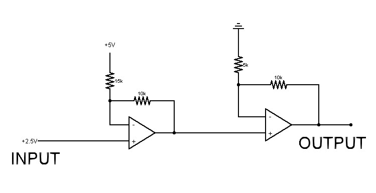

You can do it with a dual Op-Amp ...
Perfect. Just emulated in LTspice and it does exactly as asked.

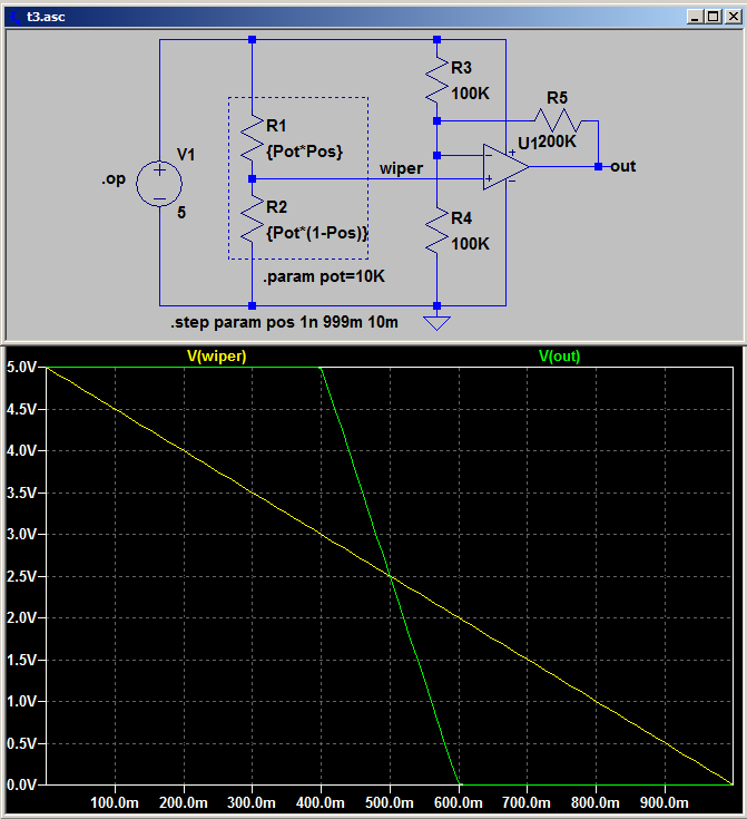

Try a single opamp with a non-inverting gain of 5.
The independent variable of the simulation is pot position (x-axis). The dependent variables plotted are V(wiper) and V(out).
Gain is 1+200K/(100K//100K) = 1+(200K/50K) = 1+4 = 5 centered on 2.5V , so 3Vin = 5Vout and 2Vin = 0Vout.
Try it for any reasonable value of pot resistance...
It does depend on the opamp being rail-to-rail out, which an LM358 is not. If all you have is LM358s, then you will need more than a single 5V supply.
  • t3.asc
whoops. For some reason I read this as leaving 2-3V unchanged but snapping to the nearest rail beyond that.
I assume the LM358 isn't suitable due to the max output voltage being Vsupply-1.5 which would only allow me to measure inputs from 2-2.7V. This will probably do for my situation but just in case I can get hold of an LMC6482 locally which should manage the full range.
