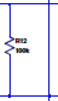

Firstly, tell whoever drew the circuit that lines that join should never form a cross. I first thought that the Drain on M1 only connected to the Anode on D10. Not having physical space is no excuse for drawing the circuit ambiguously.

Sorry, but that's how circuits have been drawn for MANY years now - the connections are signified by a dot at the junction.
I know that, and I did work out what is happening, but it's a useful guide to avoid having a cross that is a junction.
DerStrom8's guide here https://www.electro-tech-online.com/threads/rules-for-drawing-readable-schematics.144863/ mentions it.
That is what the that part of the circuit diagram looked like on my laptop with a 1280 x 800 pixel display. I've zoomed that in 5x so that the two pixels that differentiate a cross from a join are visible. On one level zoom out, there is no difference at all on screen between a join and a cross
Newer laptops might well have more vertical resolution but they would probably have a lower-height screen, so the pixels would be a lot smaller and less visible. The .pdf varies the line - dot ratio depending on the zoom so I can't be sure how visible it would be.
