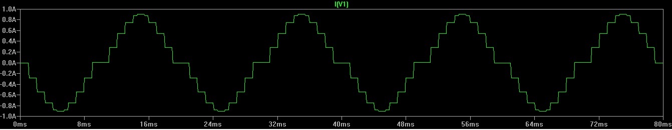

Rearding Class C regulatory limits for mains harmonic currents (EN61000-3-2)…..is it possible for a mains input current to a ~150W offline product to pass Class C regulations when it has no more than five steps in a “stairstep” mains input current waveform?
Attached is the LTspice simulation of a “product” which produces a five stage “stairstep” mains input current waveform. If you run the FFT on the input current waveform, you will see that it fails Class C regulations for Mains harmonic current levels.
(The excel doc shows that it fails)
What I am asking is…… is it ever possible for a five step “stairstep” mains current to ever pass Class C harmonic regulations?
