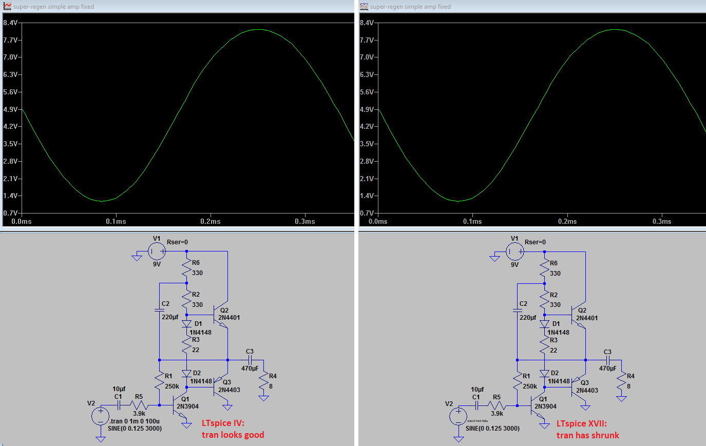

I found another bug in LTspice XVII when it is showing a sim made with LTspice IV:
Is there a way to increase the tool icon size? I find them very fiddly when working with a screen resolution of 1920 x 1080.
I see it has shrunk. You can always hold down the CTRL button and right click over the .tran statement and resize it.... but it should not happen in the first place
