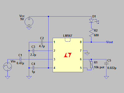

I'm looking for the ltspice version to simulate this schema that contains lm567
thank you!

The LM567 model is not part of any LTspice version, so needs to be downloaded from a third party site (if indeed the model exists).
None I could find with a quick Google :(. The Yahoo LTspice User Group has free downloadable libraries of many models, but not a LM567 model. Incidentally, the LM567 is an obsolete IC.
I worked with LM567s back in the 1970s. It is easy to define the center frequency and lock-in bandwidth based on equations found on the data sheet, simulation not really necessary.
