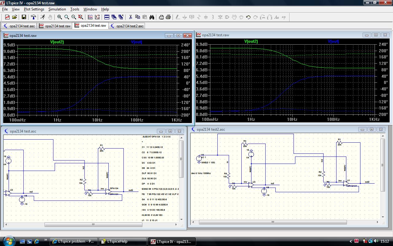

Well i seem to have made some progress :)
It turns out i did not have a model of the OPA2134, my mistake was using the 'universal op amp' as the base component before adding a spice directive to the OPA2134 sub circuit.
When i used the 'op amp2' component as the base i think i have achieved an OPA2134 model, the result is shown on the screen print 14 below, is that what it should look like?

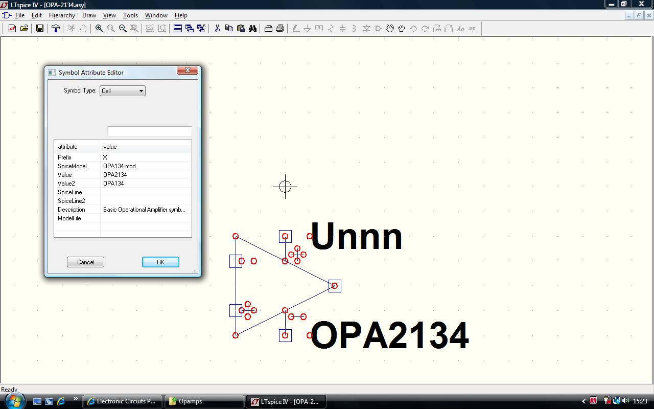

However i don't like having to have an include directive or alternatively pasting the .subcrkt instructions into the schematic so i have attempted to create a OPA2134 component.
I copied the 'opamp2' .asy file then renamed it OPA-2134.
I then edited the attributes to that shown in screen print 15 below.
I moved the OPA134.mod file into the sub folder.
When i inserted this new component into my schematic i no longer needed the spice directive or pasted subcrkt so it appears i have a working model! :)
At least the results are the same as shown in screenprint 14
Could you please confirm that Vout2 shown in green is what you would expect an OPA-2134s output to look like
(the blue vout is just an LT opamp i picked randomly to compare with my OPA-2134)

It looks good. You might want to consider that it is not simple to create a new symbol for each op amp you want to use.
I put all my subcircuits into the /lib/sub folder. Then, your include directive is simply .lib OPA2134..mod, or whatever the name of the subcircuit file is called.
