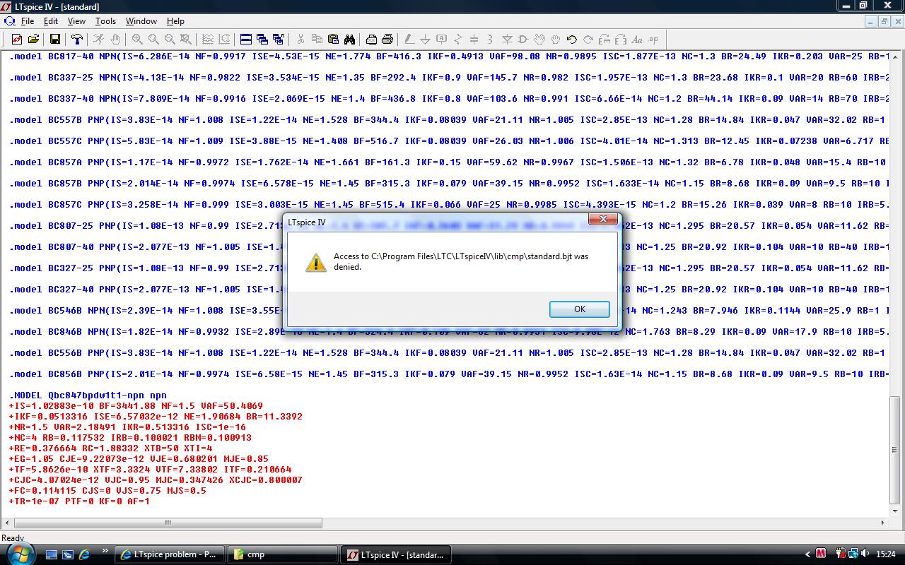

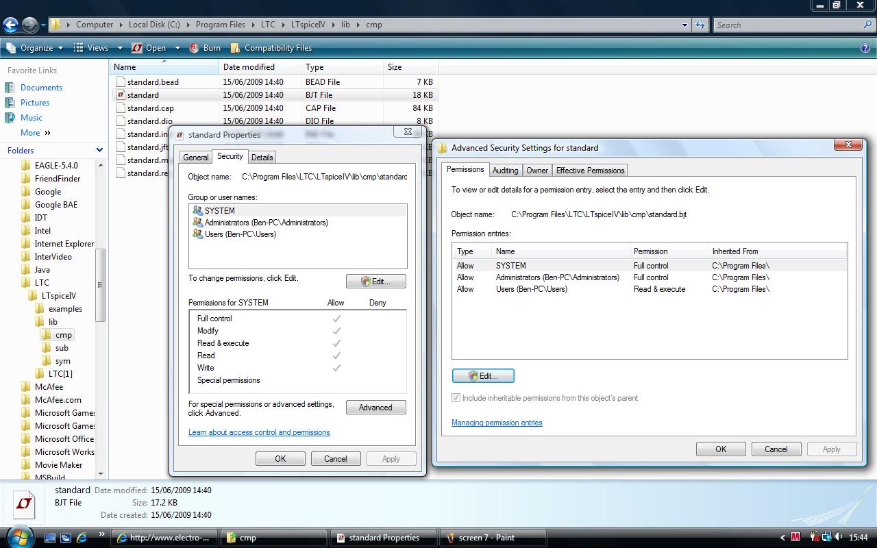

Can i confirm a few things because i tried to do what you said and it didnt work.
Is the standard.bjt file found in LTspiceIV\lib\cmp ?
When i pasted into this file i go to save and i get the error message:
Access to C:\program Files\LTC\LTspiceIV\lib\cmp\standard.bjt was denied
As shown in my attachment

Ive tried this method, it works OK.:)

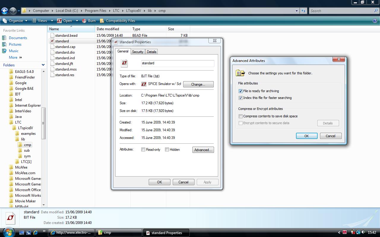

It sounds as though the *.bjt maybe 'read' only or you dont have the full Admin rights to change the file. Thats a function of Windows.
Looking at the image, I would say you need to check 'adminstrators rights' in Vista

It does not give me the option of clicking 'details' under the general heading (as shown in 1st screen shot)
But under security heading i can see permission status which i am assuming is what it wanted me to do? and i see that i have full permission at the moment anyway (screen shot 8)

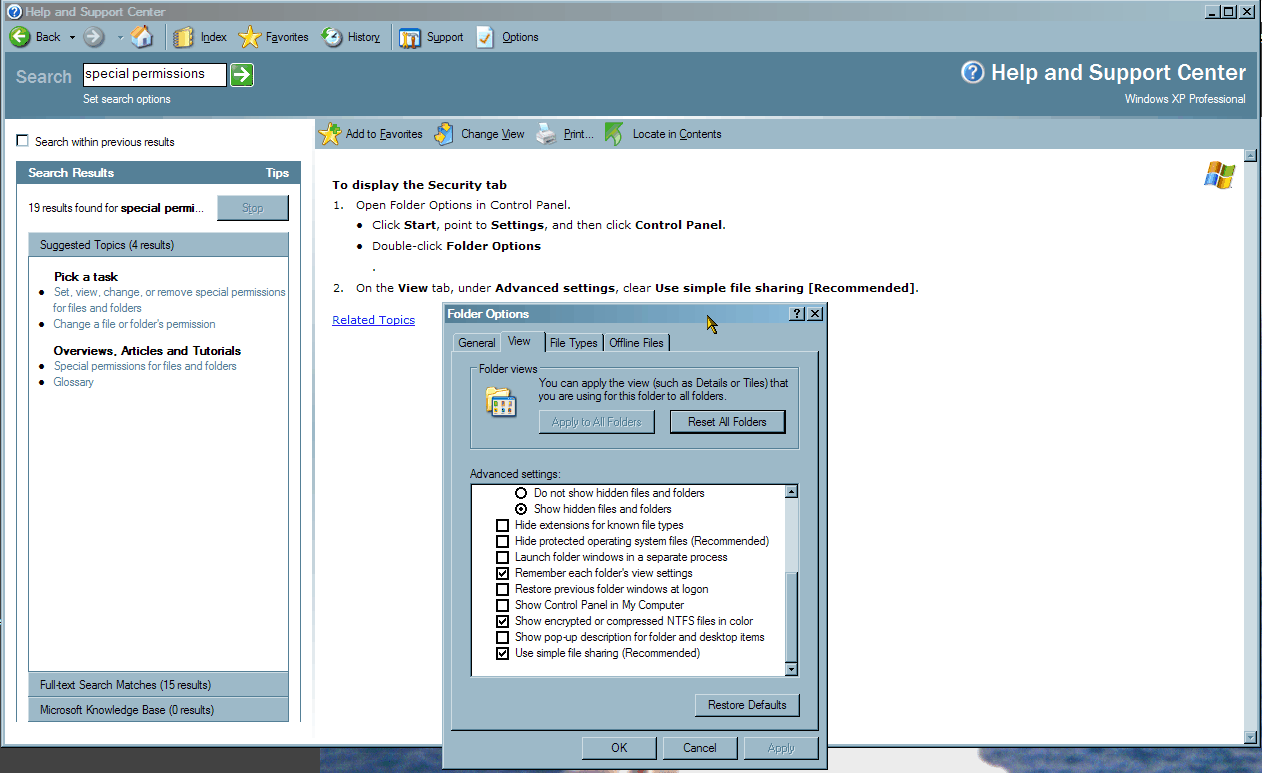

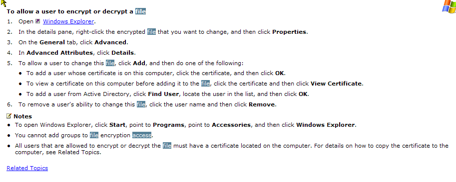

I have posted my settings.
As I dont use Vista, I have to give XP examples.:)
Access the Control Panel window.

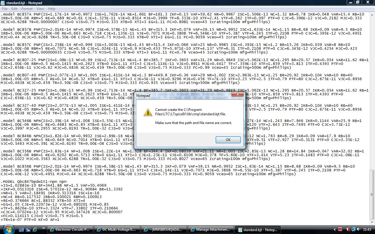

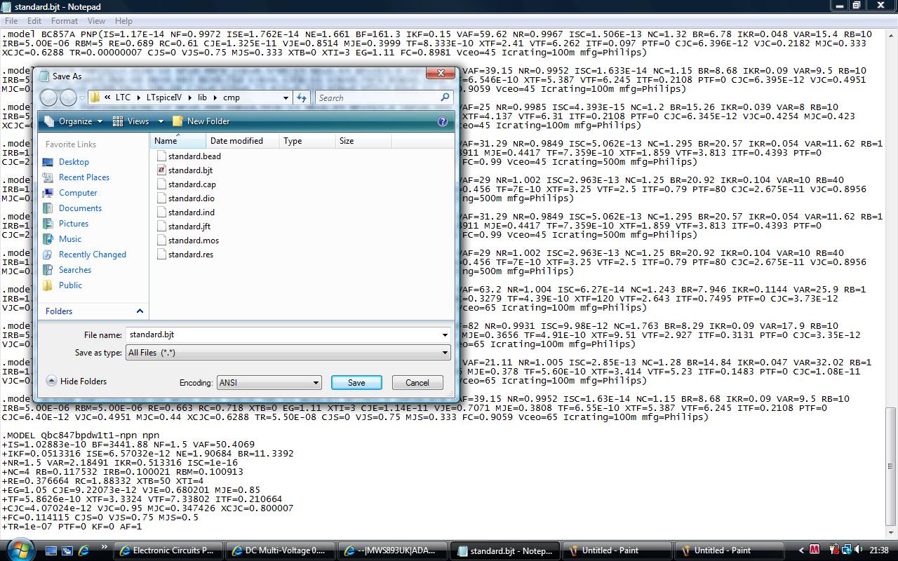

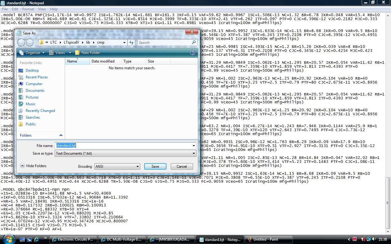

Thank you for replying Roff
I did as you say but when i go to save i get the error message shown in screen print 9
Then when i press ok on that error message i get the 'save as' box as shown in scrren print 10
then when i try to save it anyway i get another error message shown on screen print 12

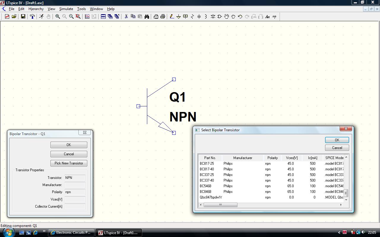

Thank you for replying Torben
The cmp directory was on read only so i unchecked that but it still didnt work.
Then i thought why not make sure the entire LTspice folder is not on read only so i did and unchecked that too. Hope thats ok?
Well anyway I managed to save the cmp file in notepad :)
However when i open LTspice and right click on new transistor i do see the new transistor but its values of vceo and ic are zero :(
whats gone wrong ths time?
