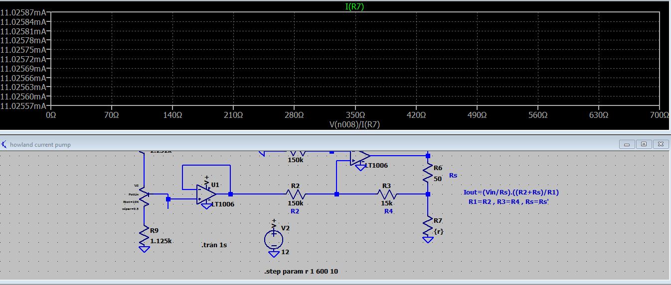

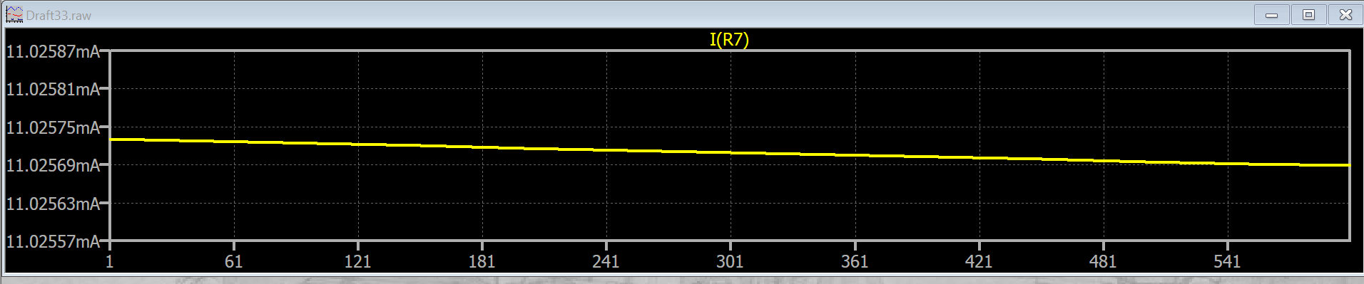

i want to see current flowing curve on {r} , which means R7 ,resistor. I wanted to change x axis plot as like they said here , but curve is not able to see on my pc.
iwanted to see current changing on diffirent resistor values. Here is my scopescreen;
To what?
What exactly do you want for the horizontal and vertical axis on the plot?
To what?
horizontal will be resistor
vertical will be current
The DC op point analysis will give you that.
