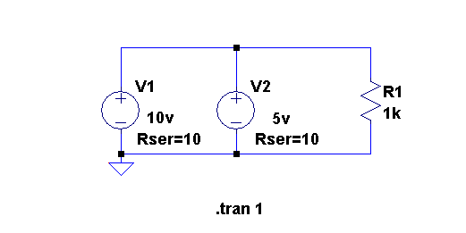

while simulating circuit in LTS, it shows error log as, "Voltage source X and voltage source X1 are paralleled making an over-defined circuit matrix".
how to fix this????

hi VR,
You could add some internal series resistance to the Voltage sources, I would try to avoid putting Vsources in parallel.
