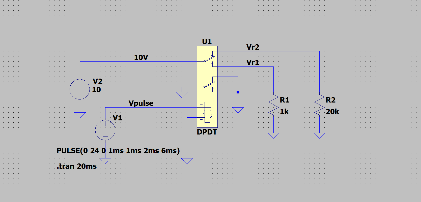

I took it, as is, but it's not working. Am I missing something? I lack of knowledge (for now) about Spice syntax so I left the .sub file untouched (including the relative path of the standard.dio).

What version of LTspice do you have?
Where did you put the relay .asy and .sub files?
Post a screen grab of your simulation schematic.
When I run your .asc file, the relay symbol does not show.
Each file is in the correct path (the .sub and the .asy).
By default, LTspiceXV11 looks for the .sub and .asy files in your ....... Documents/ .... path. Is that where you have them?

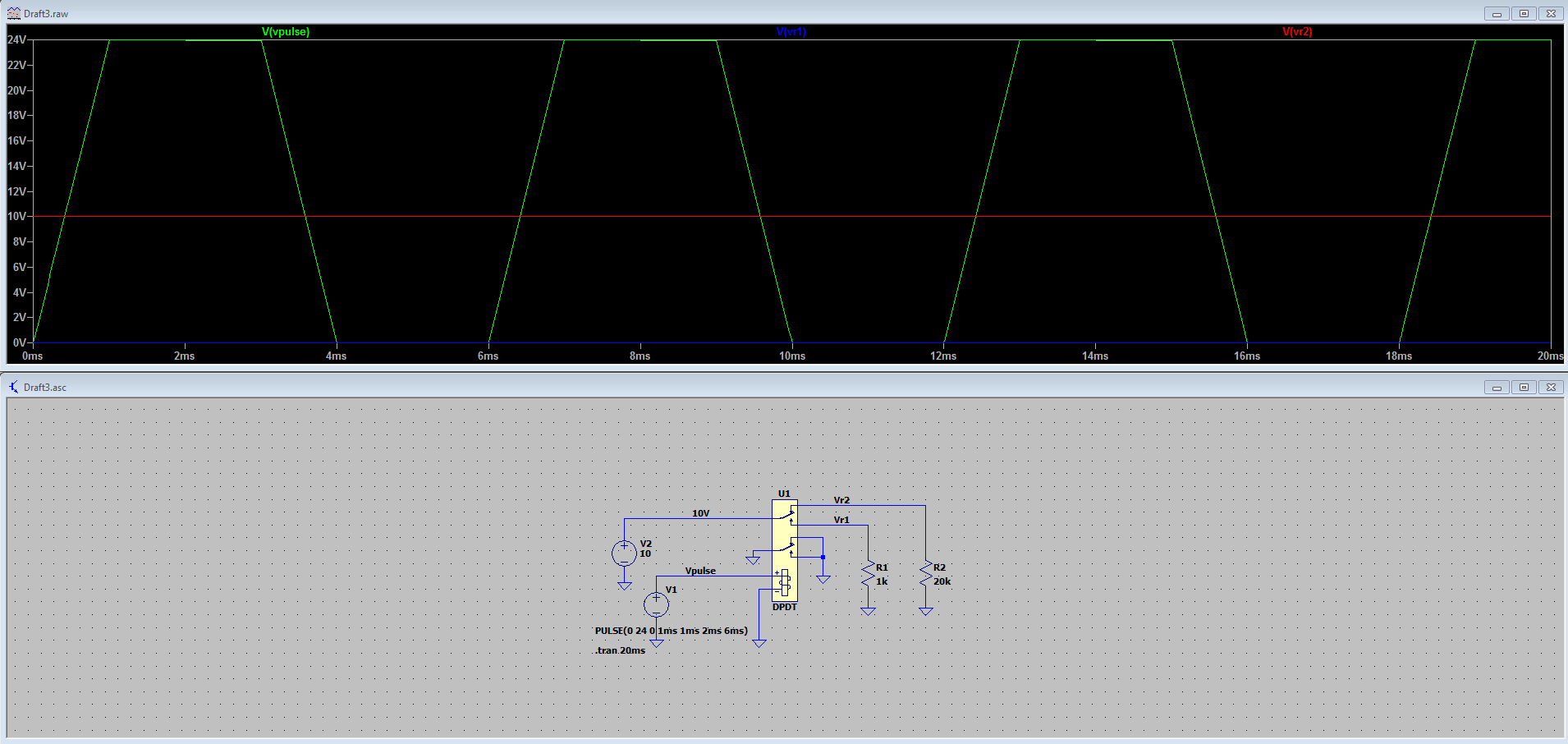

Weird. I've attached 2 screenshots. I've looked in the .sub. Vt (trip voltage for what I could understand) should be 0.36V. So, when VPulse overcome that threshold, the relay have to switch. But it doesn't actually.
Yes.
I've downloaded the first file uploaded. On my side I can see the relay symbol and I don't have simulation error (except the logic relay behaviour).

Cockpit error. I didn't look closely at your simulation times.
The relay model has a delay of about 14ms to simulate the operation of a real relay but you were trying to turn it on and off in 10ms.
Real mechanical relays generally don't operate that fast.
Omg, nice catch! Thank you I didn't notice. Now it's working perfectly.
