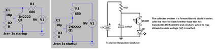

Your 1 Transistor circuit cannot work. It has no connection to the base terminal which is responsible for biasing the device into its active region.
No. The circuit works fine as a standard relaxation oscillator with avalanche breakdown of the reverse-biased emitter-base.
That may be the case for a real part, but his original simulation only charges the capacitor and fails to oscillate. Is the model not simulating the reverse breakdown characteristic of the 2N2222?
