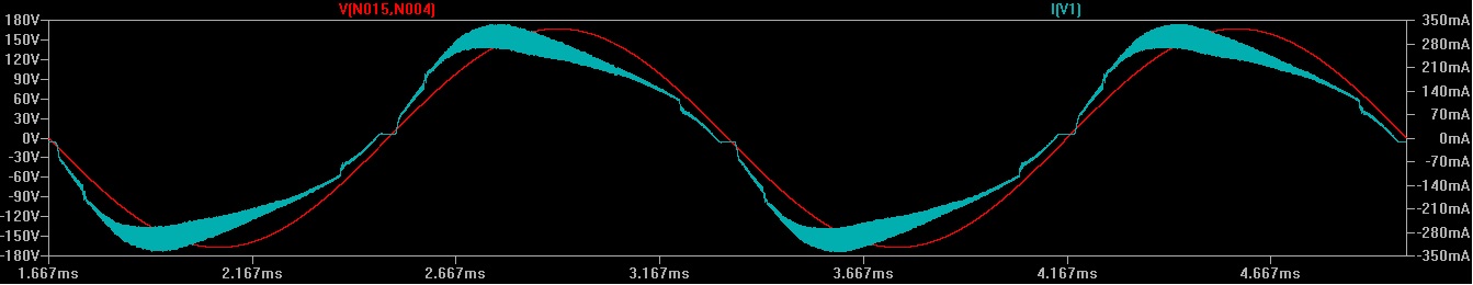

Hello,
The LT3799 is said to be a “Flyback controller with Active PFC”.
However, when I ran the linear.com provided simulation of the LT3799 in LTspice, it is evident that the current is not really in phase with the line voltage. (as the attached waveform shows…the power factor is 0.97)
I have attached the LTspice simulation that they provided here, and have LC filtered the mains input current, so it can be easily seen. You can see that it’s not in phase with the line voltage.
Why are they saying that it is Actively Power Factor Corrected?.......when all it is doing is making the primary peak current be a scaled factor of the primary DC Bus voltage? (As you know, that provides a power factor of unity with the Boundary conduction BOOST topology…..but NOT with the Flyback topology).
  • LT3799 test fixture.asc
With out spending much time on this, It looks like it is working. pf=0.97
I have seen better, I have seen much worse.
