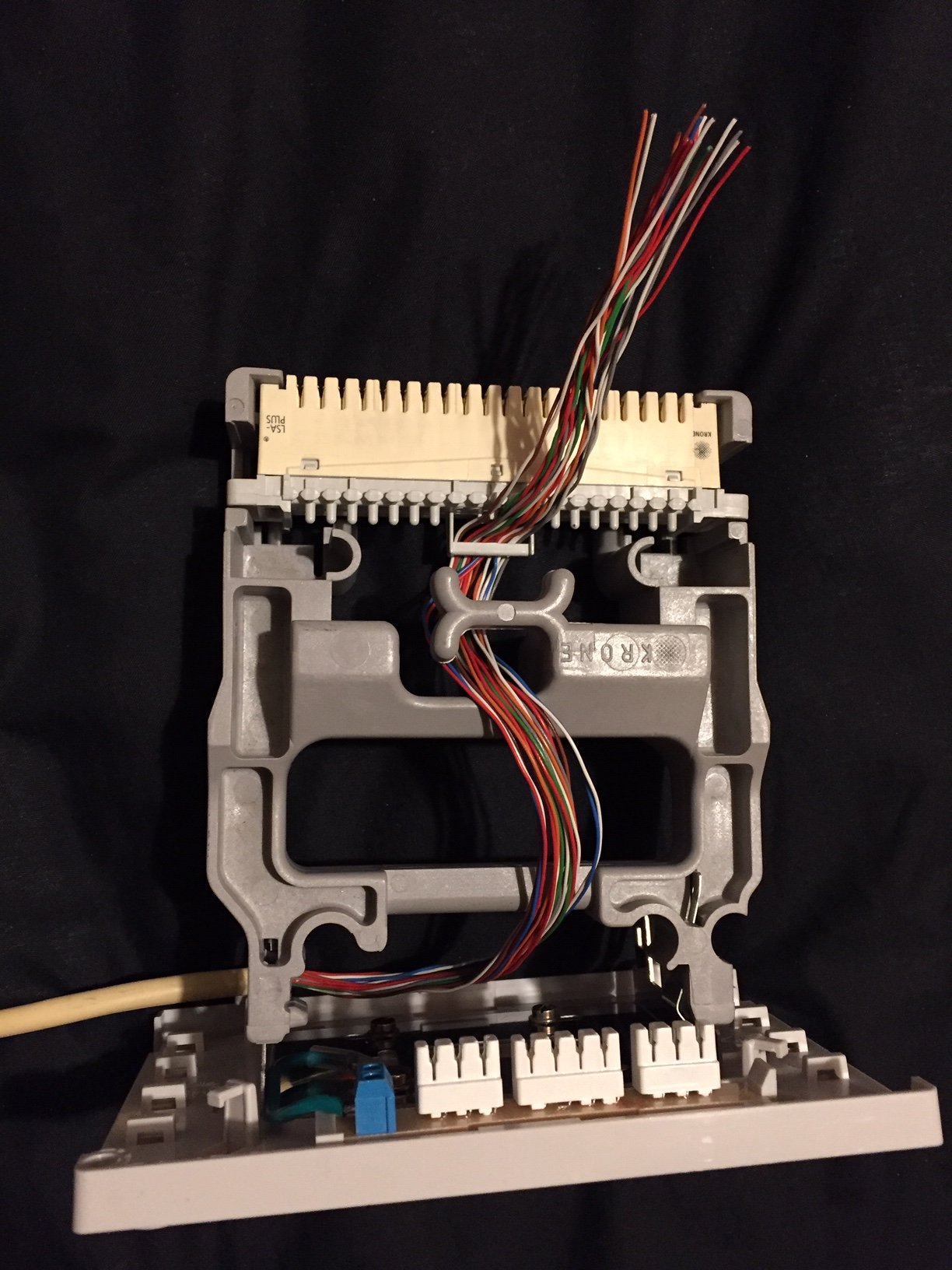

For pairs (telephone wiring) the normal wire identification convention is 1A , 1B, 2A, 2B etc. through the ten pair locations in each strip.

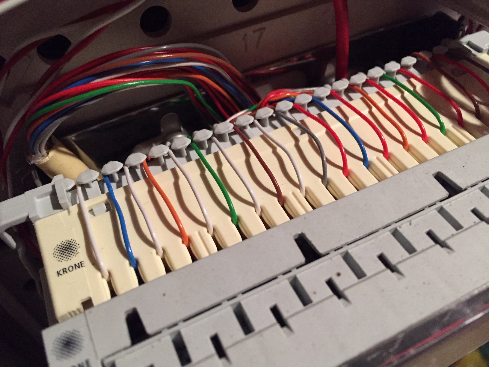

The side of the strip with the "pips" is suppose to be the fixed wiring side (at the top) with the incoming cable fed up through the loop, then each core slotted between the appropriate pips as a guide so it comes straight forward and has some strain relief.
The lower side is supposed to be for loose patch wiring, between the various strips in a frame.
There is supposed to be enough free cable on the "fixed" side so the whole strip can be pulled out a few inches from the frame if needed; Krone make a wiring jig that fits to the frame and holds the strip a set distance out (approx 120mm from its seated position) while it's being wired on the fixed side.
The upper/lower contacts are connected with sprung leaves, which can be separated by plugging in a test connector, or used as a tap point for terminal blades on a protection magazine to connect with.
Depending how you want to do it, the two sides could be in/out, upper/lower, fixed/patch or whatever fits best.

Photo below (a strip with a protection magazine plugged in as well), and the wiring jig just for reference.
