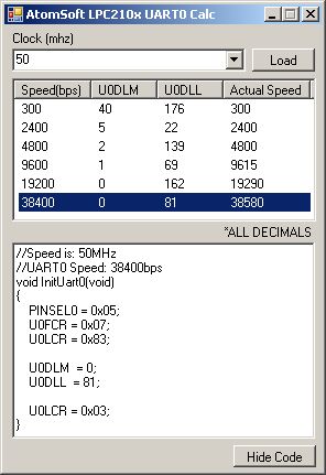

Just made a UART0 Calculator for ARM7 LPC210x (x = 1,2 or 3)
Nice simple calculator and code generator for setting up UART control and pins.

Made a update with more UART values. I forgot to add these to the first one. :D
Edit Just updated again this should be the last... v3
