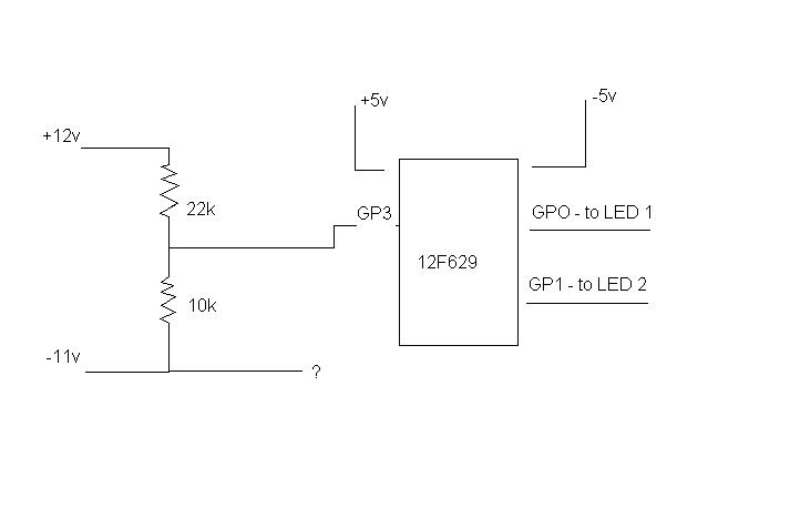

so, my cicruit would look something like this (sorry, i used these values before i saw your post)
the voltage at 12v at GP3 would be 3.75v and the low or trigger voltage would be 3v. Does this look right? Also, where does that ground from the divider go?

You should only have 1 ground which connects to,
The negative terminal of your battery,
The gnd connection on your 5V regulator,
The Vss pin on the pic.
I'm assuming that the -5V refers to the gnd connection of the regulator and the -11 (why not -12) refers to the -ve battery terminal. I'm also assuming you have some capacitors around your regulator.
Edit, the input should go to GP1 if you only want to use 1 pin.
yeah, the -11 should be -12, sorry, im at work and flipping back and forth trying to use MSPaint!
So, to run it off a 11.1v (usually 12V) LIPO, can i use the +5 volts from the regulator (yes, there is a proper power supply, i just didnt draw it) and then run the -12v to the regulator and the chip (its okay that is a 12V ground?)....
