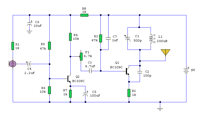

The coil is 220 uH according to the NEC poly-bag from which it came and the red-red-brown dots seem to confirm that. The article was not all that specific about any of the parts, even the coil. It says one could scavenge the Variable Cap and Coil from an old MW radio. I don't have an old radio to cannibalize, but I suppose I could also try winding a coil on a 35 mil plastic film canister and I do have a 365 pF variable cap from an old transistor radio in my junk box. Thoughts on this?
Also; the following is an extract from the original article and I've attached the original drawing to which the comments pertain. This should allow one to see if I've made any errors relative to the original or whether it must be the specific coil and cap.
"Broadcast Band AM Transmitter
This circuit is deliberately limited in power output, but will provide amplitude modulation (AM) of voice over the medium wave band.
The circuit is in two halves, an audio amplifier and an RF oscillator.
The oscillator is built around Q1 and associated components. The tank circuit L1 and VC1 is tuneable from about 500kHz to 1600KHz. These components can be used from an old MW radio, if available. Q1 needs regenerative feedback to oscillate and this is achieved by connecting the base and collector of Q1 to opposite ends of the tank circuit. The 1nF capacitor C7, couples signals from the base to the top of L1, and C2, 100pF ensures that the oscillation is passed from collector, to the emitter, and via the internal base emitter resistance of the transistor, back to the base again. Resistor R2 has an important role in this circuit. It ensures that the oscillation will not be shunted to ground via the very low internal emitter resistance, re of Q1, and also increases the input impedance so that the modulation signal will not be shunted. Oscillation frequency is adjusted with VC1.
Q2 is wired as a common emitter amplifier, C5 decoupling the emitter resistor and realizing full gain of this stage. The microphone is an electret condenser mic and the amount of AM modulation is adjusted with the 4.7k preset resistor P1. An antenna is not needed, but 30cm of wire may be used at the collector to increase transmitter range."

I built an oscillator similar to this one, and it worked, so I know the layout is good. Have you tried tuning your receiver across the entire AM band? If you get a point where the radio gets real quiet, you might be transmitting but may not have the audio modulating the signal. Give that a try, also might try the tuner cap you have. I'll try to think of another way to test it.
I have a little Multi-band AM receiver that goes from 440 kHz to 1690 kHz. I tried tuning across the AM Band without success. I wish I knew it was even oscillating. Then it would only be a matter of where in the band.
I'll go dig out the transistor radio tuning capacitor I salvaged years ago. I'm pretty sure it's 365 pF at the high end, but don't remember the bottom end figure. If the bottom is 15 pF and the coil is working and the circuit is OK, it should have a range of 560 to 2770 kHz or so. Lot of IF's.
Hope you can think of something. The only other thing is the coil and winding one just to diagnose a problem is a heroic effort.
The oscillator is supposed to be common-base. Then C7 should connect to ground, not to the supply voltage.
The supply voltage needs a 10nf capacitor to ground like all battery-powered circuits.
The electret mic should be powered from a 10k resistor, not a 1k resistor R1.
The antenna length for this low frequency transmitter should be half a block long plus an earth ground.

I've looked at a few other schematics of the FM variety and they do have the C7 cap from the base of the oscillator transistor to ground. What you said about the common base configuration makes sense and has been bugging me since our last chat on the oscillator. Wonder why Andy had it where he did. I can try your fix by changing one jumper (thank goodness for an easy one). That seems like it would be the biggest potential cause for no oscillation. Correct?
Is the 10 nF to ground in addition to the C6 of 10 uF to ground or a replacement for C6? If it is in addition, I'll have to scrounge for one (unless its value is not super critical). (Remember we discussed C6 and R8 a bit. What would it be for? C6 and R8 have a cutoff of about 15 Hz which seems pretty good for blocking AC from entering the mic and preamp.)
I can swap out the R1 (1k) with a 10 K, but wouldn't that be something that would affect the modulation level, rather than the oscillation? It needs to be done, but in an effort to not change too much at once I perhaps should wait 'til I've got a signal going out? Reasonable approach?
Also; please let me know if you see anything else that is incorrect in the circuit.
C6 is a filter for the supply voltage to the preamp transistor and mic. It has no effect on the oscillator transistor that also needs its own supply bypass capacitor. Use 10nF which is also marked 0.01uf.
Change R1 later if you want.
Probably won't make any difference.
The battery has an internal resistance that might be high enough to stop the oscillator if its base is not bypassed to ground.
If the oscillator is that sensitive to resistance, then I'd say there is something else wrong. If reconnecting the cap makes it oscillate, then you probably need higher Q tank components. Also, measure the terminal voltages on your transistor. You should get about 5 1/2 volts on the Emitter, about 6V on the Base and probably the full 9V on the collector. If these voltages are way off, you've got a bad baising component or miswire.
IT LIVES !!! IT LIVES !!!
Switching C7 to link the base of Q1 to Ground made the difference.
I've now got to search for a 10nF disc and a 10k resistor.
Hi Ho, Hi Ho, off to my parts box I go!
I've not only got carrier, but also have some so-so modulation. The addition of the remaining components (1K resistor and the 10nF cap) should improve the sound.
THANK YOU AUDIOGURU!!! 2 Thumbs Up!

I have a very similar oscillator working with the capacitor connected as in the original circuit. But as all parts are different, you're coils were probably the weak link, and you were operating just below the threshold. Glad you have it working, but I think it might not start reliably, so hold your breath :)

What is its range? 10 feet? How long is its antenna? Does it have an earth ground?
I don't think its frequency changes much when the battery voltage drops because the capacitance of the transistor is almost nothing at 1MHz. It is 100 times as much at the 100MHz of the FM broadcast band.
The specified BC109C has a very high gain of 420 to 800. Your BC107 has a low but wide range of gain from 110 to 450.

The BC547 is the same as an old BC107 but is made by many manufacturers and is in a modern epoxy case. Its pins are the opposit to the 2n3904 American transistor.
Well, I put in the extra capacitor and changed the one resistor to 10k.
It is VERY touchy to tune and the sweet-spot is VERY narrow.
The modulation level control seems to have little effect as well.
Also there isn't much tuning range at all, nor is there a great deal of tuning range.
I suspect the tank is in a sort-of "Oscillate or Not" state.
I take it the circuit is sound, so I may have to replace the tank components.
